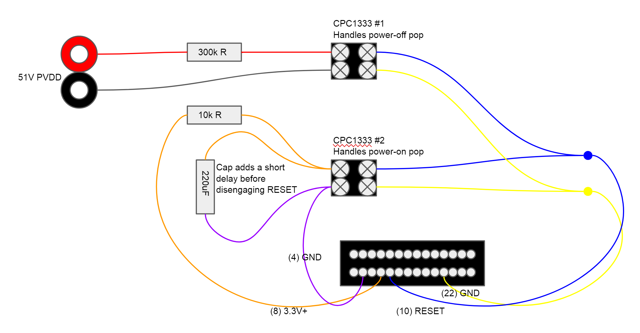

220k might work, 330k probably wouldn't, as it would drop the current below the 0.18mA activation threshold for the CPC1333. But it depends on your input voltage, or the range of input voltages you expect to use. Some folks use 36V, I use 51V.
The resistance calculation is the same calculation you would do for an LED. You should be able to find an LED resistance calculator online.
The CPC1333 datasheet indicates voltage drop of 1.26V, and activation current of 0.18-2mA. For efficiency, and to make it more sensitive to power drop, aim for low current, around 0.2mA.
Also, RESET+ goes to pin 10 and GND goes to pin 4 of the onboard interface block.

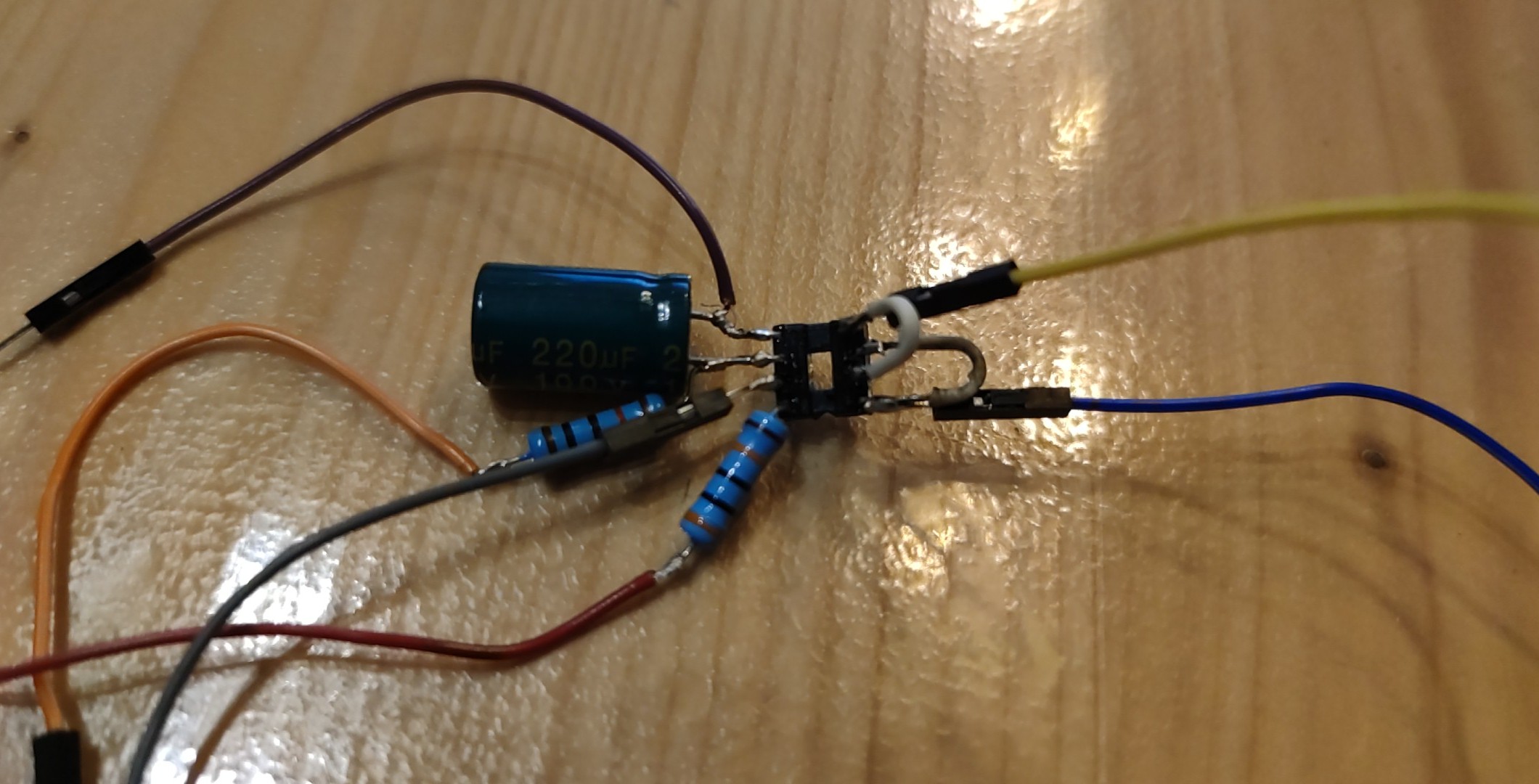

In addition to power-off pop, you can use a second XYSX CPC1333 to control power-on pop too. All it takes is the addition of a capacitor to add a small delay.
I decided to run the 2nd CPC1333 from the onboard 3.3V rail, because it starts after the 15V supply. Runnnig from 3.3V, I used a series 10k resistor and a 220uF polarized cap parallel to the CPC133. This adds enough delay to eliminate the (very small) power-on noise.
The outputs from both CPC1333 are paralleled to control RESET, so if either relay is unpowered, RESET stays engaged.
Altogether, power consumption is just a few mW.
See attached image

Hi CCSS,
I tried your circuit to stop shut down pops on my TPA3255EVM.
(only thing i did different was using a 2W resistor instead of a 1/4W resistor).
When i connect it to the main voltage and the reset position (10) nothing happens yet, but as soon as I connect it to the GND as well, the sound dissapears and does not come back. not even when I do a full power cycle or manual reset.
Is this something that can be optimized by playing with the resistor value?
And if so, what would you recommend in regards to the values?
My smps is currently set to 51VDC
I ordered some DC speaker protection boards as well (one that can operate with 12VDC from the amp board, maybe this is another solution that works)
Any other ideas are also welcome (I'm not that good with soldering, so smd mods are a no go for me 😛 )
regards, Coen

So today I proof-of-concepted this using an opto-isolated relay, the IXYS CPC1333. This is a combined opto-coupler with *normally closed* MOS relay in a single package. It is very power efficient at around 0.25mW.
Pulling from 51V PVDD through a 300K resistor to the CPC1333 allows the part to switch RESET in before the shutdown pop. It works perfectly, and I have no power-off POP. You can tune the sensitivity of the circuit by adjusting the resistor value.
Here's a pic of the simple p2p circuit:
EDIT: Note that I'm pulling power from the PVDD (DC) power line, not AC power. This is necessary in my case because I use an external power supply, and there's no AC going into the amp box. Should also add that the circuit is incredibly simple because driving an optocoupler is pretty much exactly the same as driving a LED - no extra components required. And having the optocoupler and relay switch in the same package helps too.

hi coen, unfortunately it is likely you've blown out the optocoupler, so hopefully you bought some spares. it looks like you soldered directly to the IC pins and this may have caused the issue...as with any LED, these can't take much heat. anyway, you should be able to check that with a multimeter. with this "normally open" part, power is required to close the circuit. To avoid heating the part, use a DIP socket (on mouser, Preci-dip 110-87-304-41-001101) and solder to the socket instead of the IC pins.
Hi All, today I tried again this circuit, but now with sockets. And for some reason my amp keeps switching to reset mode when the circuit is connected. I used original parts from mouser. Orientation of the octocoupler was the same as in previous pictures (the small dent was in the back if you look at the schematic from ccss, my picture is upside down)
I measured with a multimeter and everything seems to check. So i have no idea why this happens!
