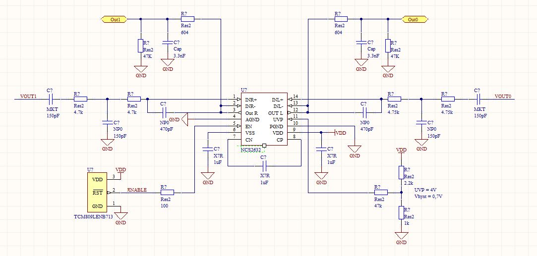

Have a miniDSP 2x4, and have also just bought a Sure Electronics DSP board with the same ADAU1701 dsp.
Both implementations have a bad pop when turning on or off. Looking at making my own implementation to build directly into active speakers.

After doing a bit of study believe there is at least 4 ways to go about this:
1. External muting circuit using either fets or bipolar transistors like the 2SD2704
2. Using a dedicated analog switching circuit which is already made for muting circuits and which accepts negative swing. A solution could be build around FSA2276.
3. Using a line driver with build in charge pump and muting circuit. A good candidate would be TI’s DRV603
4. Using a separate DAC with build in click and pop reduction. Good candidates would be TI’s PCM5100A/ PCM5101A/ PCM5102A. A good side effect would be a better overall THD performance.
My conclusion so far is that least expensive and least complex is to use a line driver with internal pop elimination. One good choice would be the NCS2632 from On Semi. It has a little lower distortion than the DRV603.
The output filters can be implemented with the line drivers and a small TCM809 can be used for supply voltage detection.
See attached schematics (2 channels shown). VOUT1 is connected to the ADAU1701 DAC output 1 etc.
