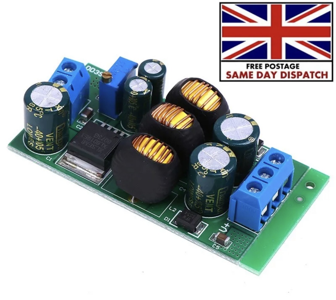

A quick search for a negative buck brought up this +/- version using XL6019E1. seems fine for the voltage and amps. The switching frequency is nice and high at 220khz per the chip specs and 180khz per the board specs (I assume that's the same as switching power supplies).Use a buck regulator to get rid of excess voltage on the positive side without turning it into excess heat. XL4015 is a cheap choice, it can tolerate up to 36V on the input. Negative bucks might well exist but I don't have a part number to hand.

Any /up down conversion is adding complexity or useless heat which is not done nowadays. Adding switchers to one of the best transformer types is throwing away the child with the bath water.
