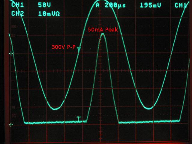

PS Here's a scope trace of a 5842 swinging a power tube grid 300V peak-peak
Gee !
Which B+ value ?
About 190V/10mA
My signal generator may be pushing the 5842 grid about 0.5V positive, which seems to happen without an abrupt transition... It would be about 250V Pk-Pk if you kept the grid from going +

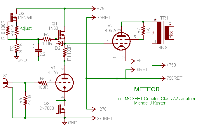

Oh yes, diode bias and a gyrator in the anode circuit

OT: Mike, I'm using tube based gyrators as loads in my phono stage - nice to see someone else also using gyrators. I'm sure the fets work better, but I am getting good results..
Note that Mike's circuit is not as obvious as it first seems due to the direct coupling and a floating 75V supply on top of the 270V supply.. The biasing arrangement for the 4-65 appears to be quite interesting. (And clever)
