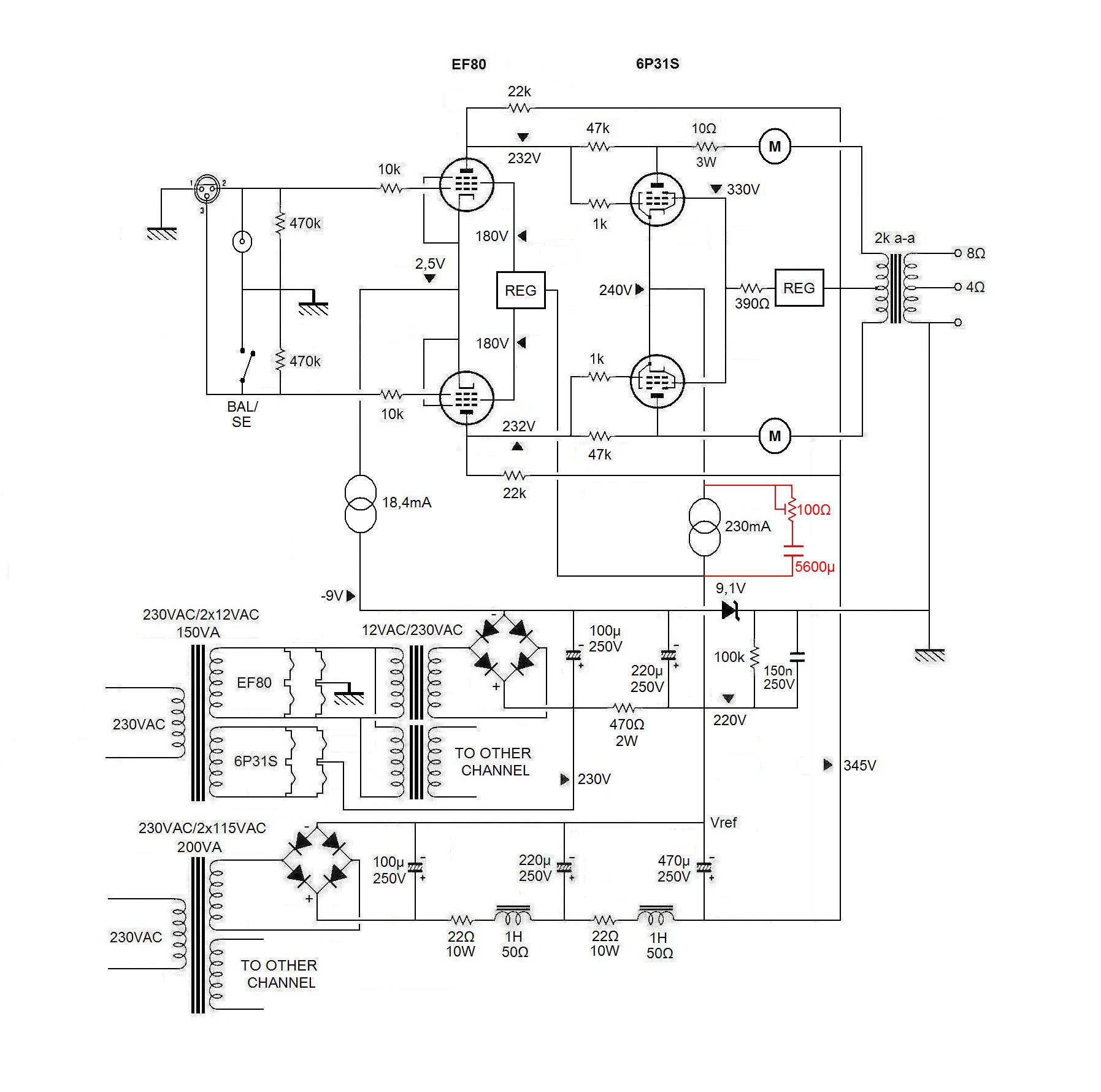

The way this amp is designed, 6P31S cathodes are some 55W away from ground. "Vref" is there to relief the CCS from 50 of those. I was thinking to substitute the CCS for a 91ohm/10W resistor -from cathodes to Vref- for a quick test. I can't see how a smaller resistor could work, for classA always. What do I miss?
The direct coupling would require a re-do of the voltage levels in order to use a small resistor there. However, the resistor is only important for AC distortion compensation, so you could try connecting a low value resistor (or adjustable pot) in series with a big cap across the CCS ( or just from cathodes to ground) to see if you get any improvement in "sound" or distortion level.
If that helps, then a re-design without the CCS tail should allow you to get more Watts out too.

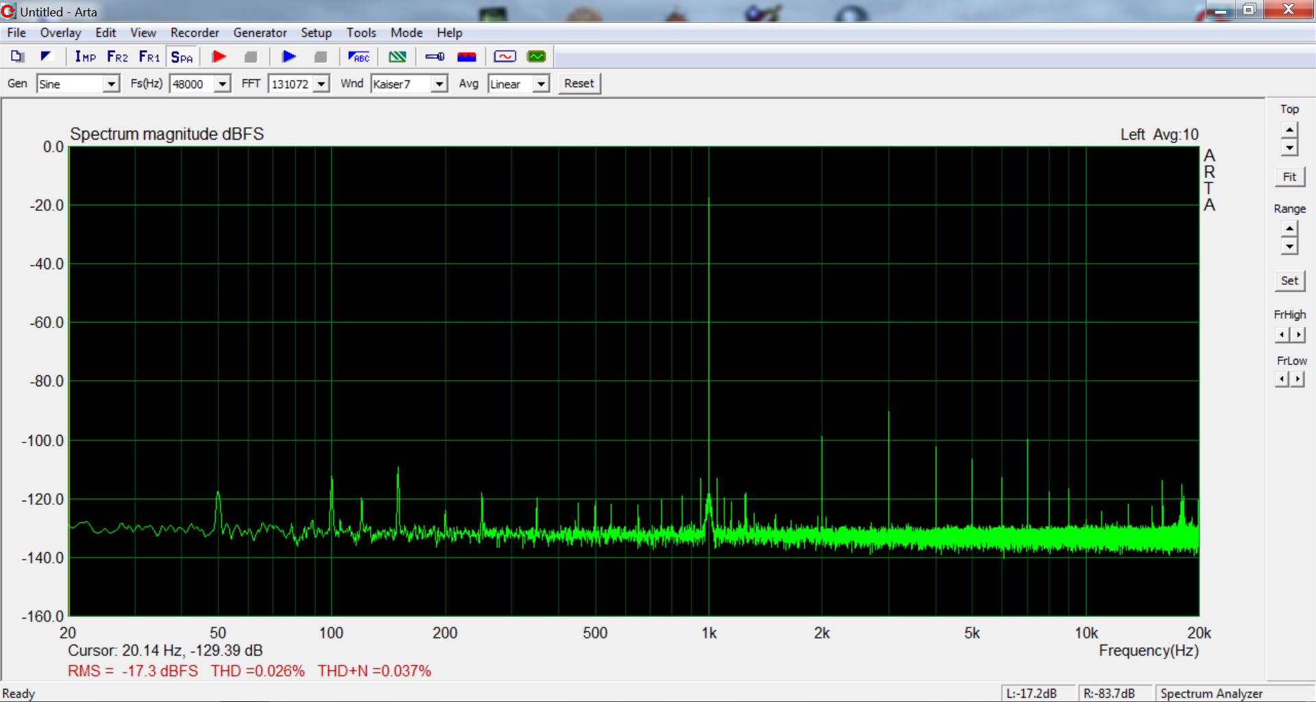

Done! I used a 100 ohm wirewound pot and a 220μ cap. Nice thing to see it changing in front of your eyes! The best I could do is attached. It's at 1W to compare with post #54. Considerable improvement. However the max power has not been increased and still reaches the limit in the same hard way. The pot's position? 8 0hm!?
To increase power you would need to use an individual CCS and capacitor per tube, and tie the negative side of each cap together, with the resistor down to the negative rail from there.
OK! Apparently, I misunderstood. Are you suggesting conversion to classAB without gm doubling side effects? Not bad idea at all but I feel it goes too much for this project. I prefer to keep it in classA. I'll just explore CCS vs resistor tail.
Happy New Year everyone! I've been playing with the cathode resistor tweak these days but nothing came out. The results at post #70 are valid only for 1kHz. A THD vs freq plot revealed a distortion havoc at lower frequencies. I thought to change the cap from 220μ to 10m and then the trim pot only affected H2 leaving H3 intact. I managed to null completely H2 at 52 ohm but again only for 1kHz fundamental. I read Kiebert-Mallory paper -here's a link that works https://pearl-hifi.com/06_Lit_Archive/02_PEARL_Arch/Vol_01/Sec_01/065_Dsgn_Fctrs_for_PwrAmps.pdf . I can only superficially understand it but if it works by injecting distortion in opposite phase to be cancelled, perhaps it can't act together with the feedback mechanism of this amp? I'm not the one to answer that, I only know that it works with quite heavy feedback and it got already better when I reduced it.
