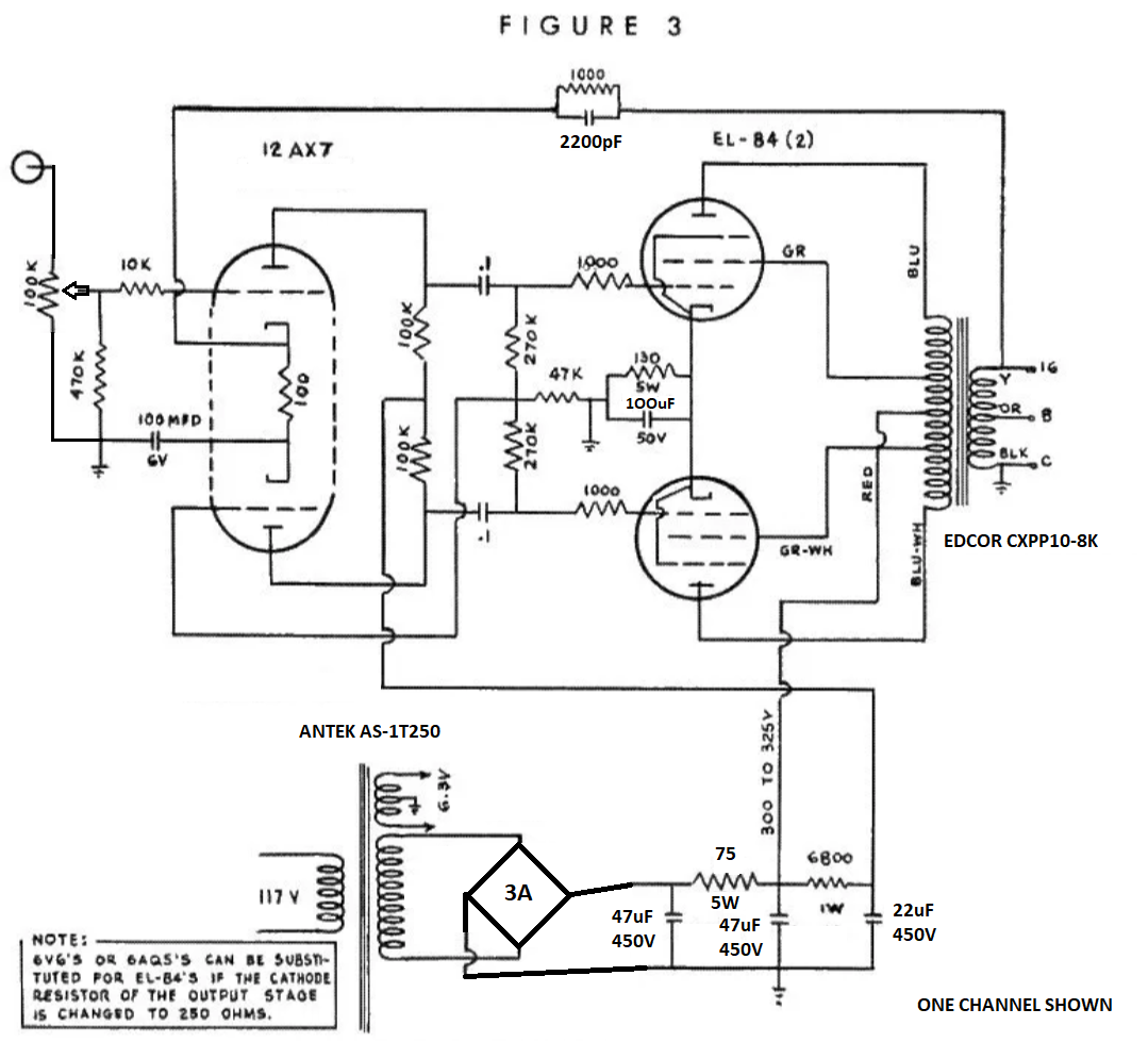

Greetings Friends. I did a little amp swapping the other day and was surprised at the lack of bass coming from a Dynaco P-P amp I built a few years ago as compared to my daily amp, a 6B4G SET and was wondering why. Here's the schematic as built:

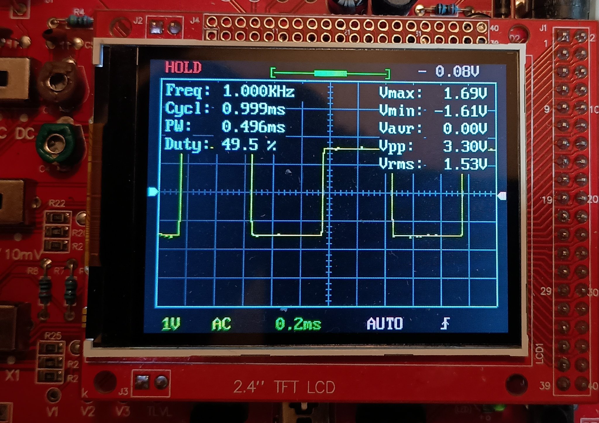

The amp in question was built using 2x PCBs with a circuit called "Dynaco 6V6 P-P" that features a 12AX7 in Floating Paraphase driving a pair of EL84 to about 10 watts. I used Edcor CXPP10-8k outputs with 4 and 8 ohm taps and wired the feedback to the 8 ohm tap. It was mentioned in a thread I started upon completion of the amp that the original Dynaco product used a different, higher-quality OT and adjustments to the Fb loop might be required. Using a simple scope and a 10kHz sq wave I minimized ringing by increasing the value of the cap in the Fb loop.
First listing to the amp gave a disappointing lack of bass when my Polk Monitor 60 speakers were connected to the 8 ohm taps, and better bass when wired to the 4 ohm taps - the Speakers show about 5 ohms of DC resistance from a DMM. But I get much more bass from my 6B4G SET amp hooked to those speakers - and that amp makes "only" 3 watts. So I'm wondering what I can do to improve the bass from this P-P amp. The original amp had the Fb loop connected to the 16 ohm tap, I only have 4 & 8 ohm - is this a problem? would changing the value of the Fb resistor compensate? Or do I just need new iron?
thanks for taking a look!
Maybe the 100uF capacitor in the input stage is the problem, try replacing it with more like 470uF at 16V or more.
Low voltage electrolytics don't last long, and the 100uF value is marginal at best.
Same goes for the capacitor across the output stage bias resistor, try 470uF at 50V there.
If your output tubes are not well matched for DC current at the bias point, that can also impair the bass response.
Try separate bias resistors of twice the resistance and at least 220uF capacitance each to have separate bias checks
for each output tube.
You mean 470uF capacitor?
Instead of 6V, either 16V or 25V would be better there.
Oh yea, caps in F. Somewhere I seem to recall reading that too high of a voltage rating on a bypass cap could lower the bass response, you are saying the opposite. Pretty sure I have some suitable caps, I'll try em tmrw.
