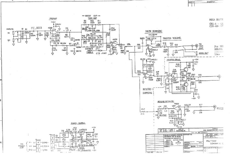

A Polytone is also what I always wanted to build. I already got the schematic and started working through it, but I'm still lokking for some kind of PCB Layout. Can anyone help me?
Simplified Circuit diagram
Yes, same here. I too am looking for assistance with PCB layout.
I obtained a simplifed circuit diagram without the drive circuit (I think I got from from Jazzpeter65) which is attached if that helps in any way. I would love to build this amp somehow (or have a the circuits buit for me if I could persuade some great person). This scematic looks more simplified but I'm an absolute tech beginner. Any way here it is.

For those who like the Polytone sound and would love to DIY, but are somewhat flabbergasted by the complex schematic for the full version and even worse for having to design such a PCB, it can be simplified to its core, retaining all sound but with NO frills ... which is fine for many.
In fact a few Polytone originals are real simple, and all sound the same.
1) Preamp: you can make its core: Hi/Lo inputs > U1b > Tone pots > U1a > Volume > U3a > main/Power Amp OUT
That´s it, no Drive, Reverb, Switching, etc. but a true Polytone preamp, very doable.
2) Power Amp: any Class AB power amp, including an LM3886,but using Polytone NFB network instead of the plain original one.
You need mixed feedback to increase amp output impedance (kill damping) so add a 0.15 ohm 10W resistor from speaker "-" terminal to ground and use: R22 - R23 - R9 - R6 - C6 - R8
Original NFB would have used something like R8 - C6 - R6 so replace them with "Polytone values" and add the few components needed, easy peasy.
3) Speaker: use an Eminence "Guitar" type, not any Hi Fi/Woofer/whatever type.
4) Cabinet: clone a Polytone cabinet as close as possible, including its heavy internal fiberglass damping, boxy stuffy closed claustrophobic IS part of its sound.
"Warm" Jazzy sound in part comes from low mid resonance created by a speaker inside a way too small box.
FORGET Thiele Small/Hornresp/REW adjustment, tuning, "improving" speakers, etc. , this is not the place for refinements.
Also forget silver caps and wiring, Audiophile stuff, etc.
You might make a cabinet out of beautiful polished fine woods or anything you fancy, it will not affect Sound ... which is good.
