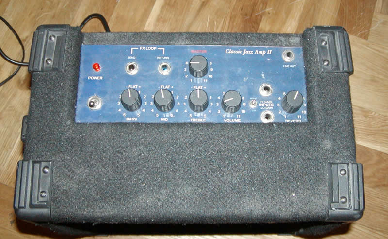

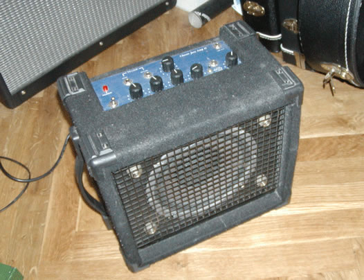

DIY Polytone guitar amp
HI!
I have built a copy of the Polytone amp. Sounds much better than the original since I have upgraded the circuit with better components.
Try to attach the pictures of it here.

HI Fred!

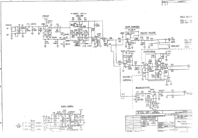

The schematic is stock. There is very little difference on the different Minibrute series. The pre amp is similar on 95% of all models. The power amp is a traditional bipolar. Nothing fancy.
My mods are only using better parts. The stock amp parts is not actually high-end....;-)
I'm using a mix of OPA2604, OPA2134 and NE5534 in the pre amp. For the power amp I'm using a Mosfet.
It's a good mix. It sounds fantastic, and I have used it on many gigs without any problems.
Also I have reduced the number of caps in the signal path - using only film caps where necessary.
This have really made a difference.
I have a few OPA627AP that I would try for the output buffer. The amp is still a little too noisy.
As you can see the input impedance is around 680K. This is quite normal in music amps for some reason. Finding a way to lower this would make it quieter.
If you need a better scan of the original amps I can mail them for you. I think I have all of them.
Are your Polytone the one with a 12" speaker? If it is, you can help me: I'm building my next clone and this time with a 12" speaker (the first was a minibrute 8").
I need all the mesurements of the cabinet. Maybe you could make a basic drawing?. Like thickness of the wood etc. I think keeping the original dimentions is important.
Best,
Peter
PS: A great deal of the genuine Polytone sound is of course using ONLY Eminence speakers. You can get the very easy and they are cheap too.

For those of you interested in the schematic please send me a
Mailing address and I’ll send you a copy. The one in my
thread doesn’t have enough resolution.

Polyclone
Say, this is an old thread, but does Jazzpeter or anyone have a schematic of the clone built and shown below that they'd be willing to share? I'd love to build a clone of my 8" Baby Brute--simplifying it by leaving out the distortion circuit--and upgrading the parts. I have the candidate cabinet, chassis, etc.

Polyclone
Hi
I read with great interest discussions on building a Polyclone amp as Jazzpeter65 has done. I have already an Emminence 12" 8 Ohm speaker although I am unsure of the wattage it could handle (came from a Sovtek 2x12 guitar cabinet).
If anyone could help with any building/parts information for the polyclone such as, parts lists, cabinet dimensions etc. Any information would be greatly appreciated.
I was wondering if jazzpeter could e-mail me with some info on his Polycolne, what wattage his is, how long it took to make or anything at all on the subject.
