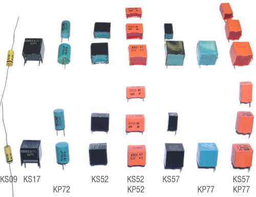

One for Jaco, as he seems to be Mr. Polystyrene. I picked up some little orange Siemens box-style polystyrenes (at least they say "KS" on them), with the leads in the corners. It looks like the type may be GSE. Sound familiar? Also picked up in the same run were some more of the Mial red box-style caps, and a handful of Rifa PHE307 polycarbonates. The Rifas are very well-made with very neat and heavy zinc spray at the ends with the leads buried securely therein. I may use them for that "warm and cozy" polycarbonate sound.
Here you go.
(i own 15000 of the orange KS fellas, so i likely rank Mr Poly)
(i've got a headache from driving 100 miles through snow, is the pits with an unstable neck, 02.17am here, hence the swift response)

Thanks for the pics - a help to cap scroungers everywhere... Mine look a trifle different. They just have the value and tolerance printed on the top, with the Siemens logo on the side and KS 63V ,and GSE 01.85.

On closer perusal, the Siemens caps look like the smaller members of the KS57 series caps in the picture.

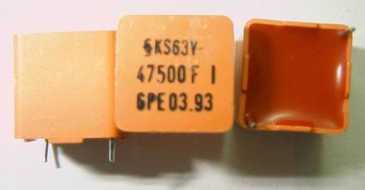

GSE points to the manufacturing date (pff, German gründlichkeit)
The KS series were manufactured till 1995/6.
Official Siemens code is a B series number, B31521 in the early 80s, B31531 from late 80s. (i'm a number mental image fool)
Both series and cap value determine the shape of the box.

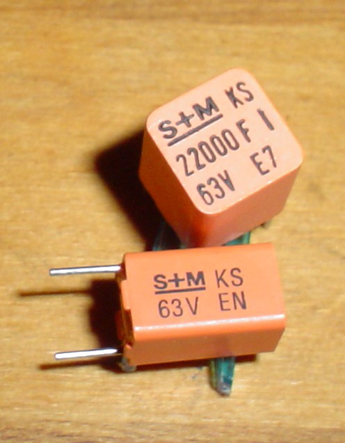

Late series caps were labelled S+M (cooperation between Siemens and Matsushita) , i'll post an image tomorrow.
