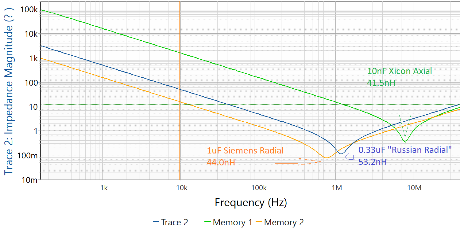

Axial polystyrene capacitors are not good for RIAA- too much parasitic inductance .Siemens KS are extended foil, radial low inductance type.

I just throw this one out for comparison -- tan theta for a host of polystyrenic, polycarbonate and a multi-layer ceramic C0G. (The glitch at 3kHz arises from my test jig.)
