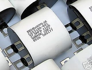

I am in the process of building a grounded grid preamp, and have replaced the specified electrolytics in the last stage of each CRCRC power supply with polyproylene caps (2x 37.5uF per rail).
The preamp isn't finished but I would expect this to make a big difference...

100uF for the first stage is minimally enough capacitance. Don't forget to try it without the cap at all. Alternately, with 1.85V needed you may find an LED that will fit so you get your gain back and don't need the cap.
I agree with the LED on the first stage. Those motor runs will be very welcome as the cathode bypass cap on the output tubes, however. I have gone from Panasonic to Solen in a previous 2A3 amp, and the improvement was great! Currently, I went from stock Panasonic lytics on my SDS boards to Solens (47uf-L-47uf-R-10uf-R-4.7uf).
