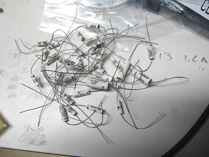

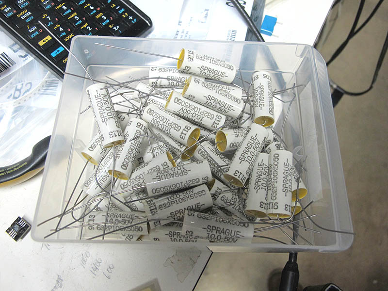

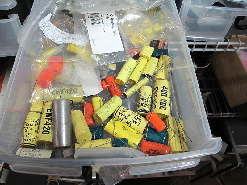

Anyone need 10u/50V Sprague Polycarbonate:

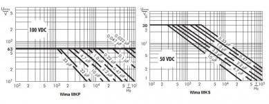

Are not great at what ?
What is Urms and V ?
These plots depict allowed AC-voltage vs AC-frequency, dependent on nominal DC blocking voltage. This is interesting for resonant circuits where significant AC-voltage drop across the cap increases dielectric losses. For audio application with some mV AC across the coupling caps this is totally irrelevant.
U is an alternate symbol for a voltage, V is the symbol for volts (the unit).
(Just like we use I for a current, whereas A or amp is the unit).
In physics U is used to distinguish voltage from velocity, I believe. The same issue would
exist is A meant current (as it also means area). When describing electric motors etc its important not to confuse velocity with voltage!
In Germany, and maybe other parts of Europe, voltage is U and not V.
