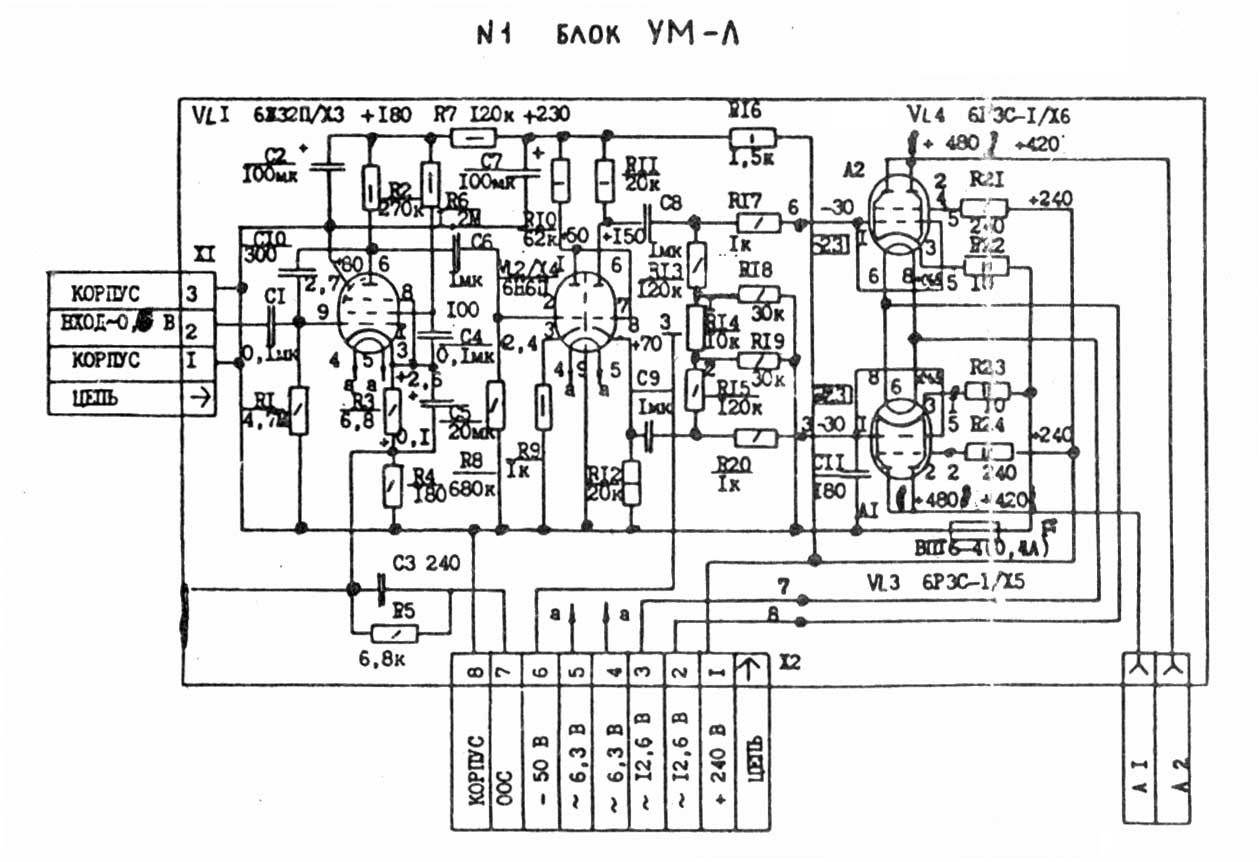

http://www.jogis-roehrenbude.de/Oldies/Priboj/Priboy-Verstaerker.jpg
Just in case you can't read German, it has a reputation for evenly "rounded" sound and somewhat heavy bass. A real "workhorse" for a banquet hall, etc..

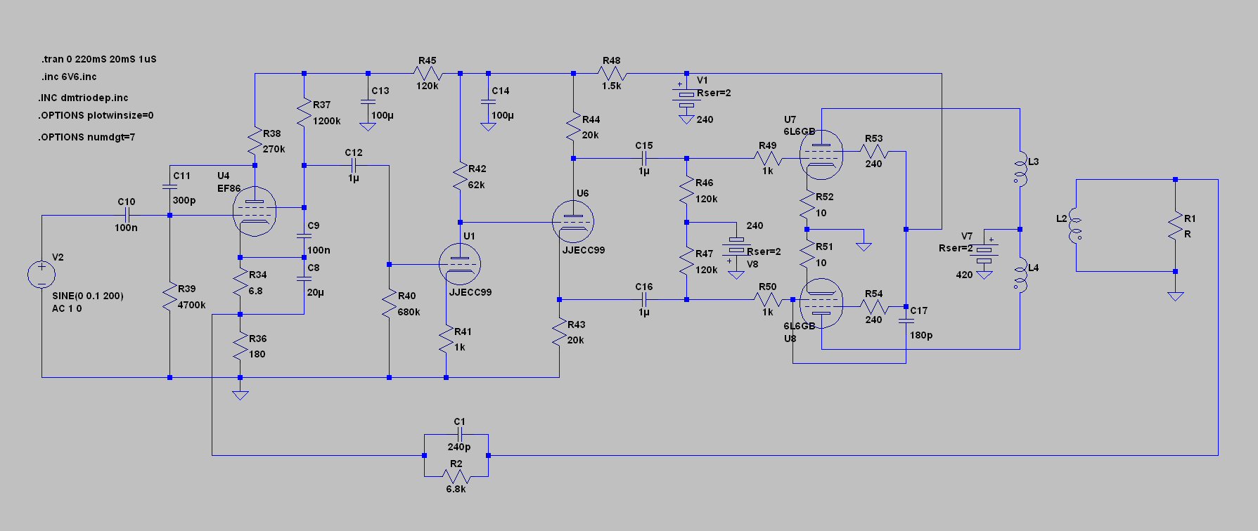

I would think the EF86 Screen resistor would be 390k-470k. Also the cathode resistors need to be raised to around 1k. Grid has too much resitance......
Screen resistor is 1.2M for sure. I think the input stage is supposed to be grid current biased instead of cathode biased, or kind of a mixed bias between those two.
Why would the designer do that?
(The bias supply is not -240V, I just copied it and forgot to edit it. I also left out the bias pot and extra grounding resistors.)
Plenty of things to fix or improve.
MrCurwen, resistor values are as follows (numbers from your Spice drawing):
R34 = 6.8 Kohm
R37 = 1.2 Mohm
R39 = 4.7 Mohm
R34 = 6.8 Kohm
R37 = 1.2 Mohm
R39 = 4.7 Mohm

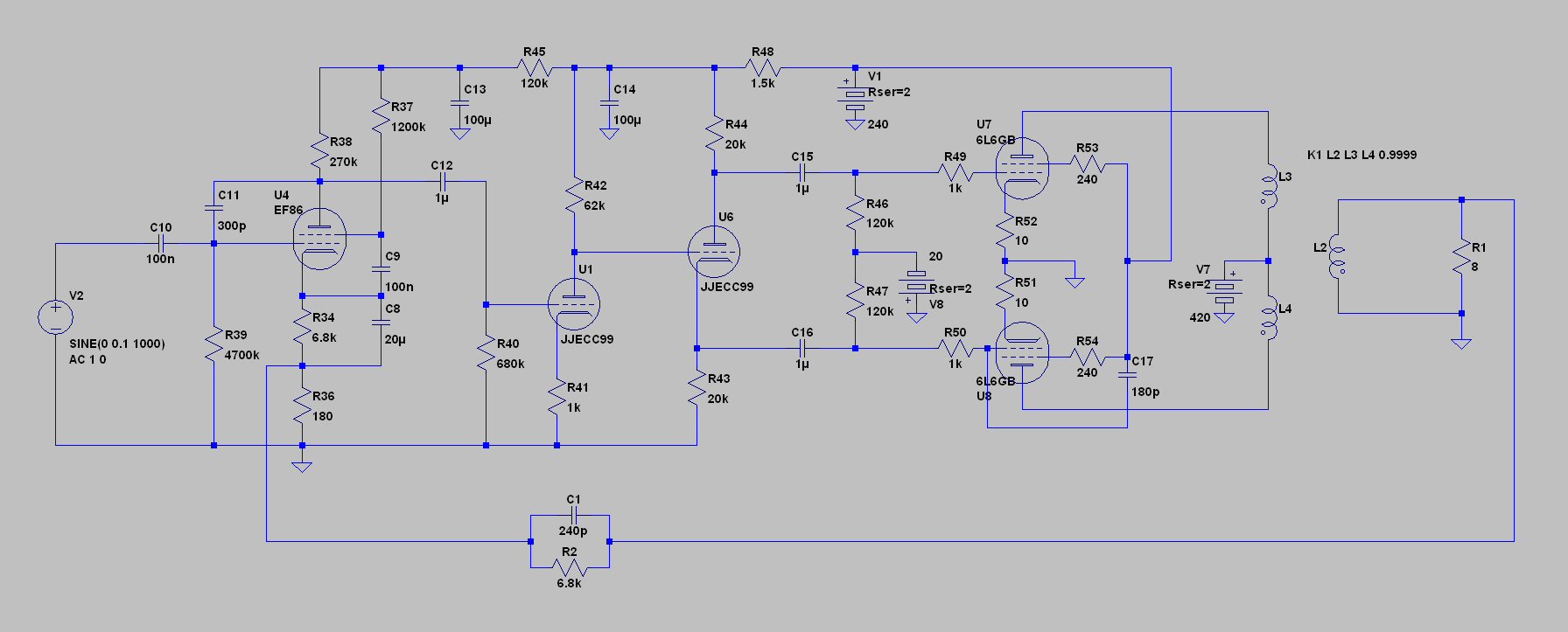

Thanks elektroj.
I fixed R34 and the output bias voltage. Seems there are no other errors.
So, the floor is open to suggestions.
