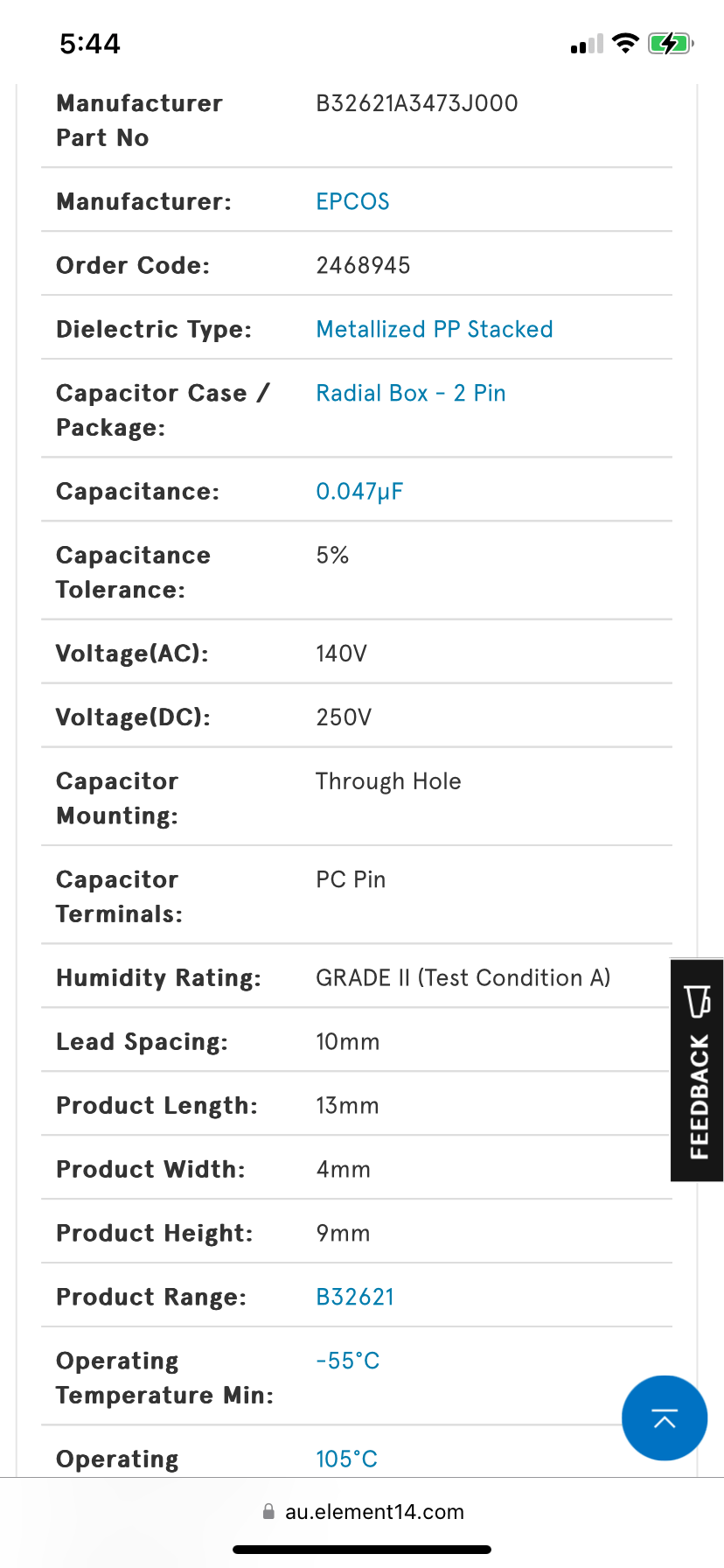

I like Wima MKP 10. That's my pick.Thanks Zenzen. I’m not going to lie, I’m a little overwhelmed by choice and figuring out what makes one better than the other. How do I know which one out of those is the better cap to pick? Is there something to look for? If they are all pp film caps @ 0.047uf with a 10mm lead spacing what other spec can I use to seperate them? Lower tolerance or even try to find out which ones have copper leads instead of steel? Or is there something else?
It probably seems easy for you but I feel a little lost in all the choices.
But I am enjoying trying to learn.
Cheers

What do you think of these Epcos TDK?Much better on Wima or Vishay cap
On Digikey a lot of choice
I looked into wima and Vishay but it seems buying these when you live in Australia is a problem. You can only buy in bulk (750 or over) from all the websites I’ve seen. These Epcos TDK can be purchased in single units. So it seems like a good option.
I used them sometimes and for me are goodWhat do you think of these Epcos TDK?
