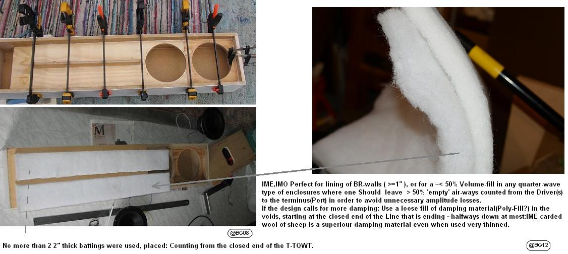

Hi turbodawg,
Agree, I've been using this type of damping material for more than ten Years:
b

There are no measurements or comparisons because these pillw stuffing materials have no acoustical properties. I have measured them a few times and they have almost no effect on standing waves in the box.
Placebo stuffing.
Hard to beat fiberglass. If you are concerned about it blowing out the port then line the box and cover the FG with a layer of porous cloth. In truth, if you cut it neatly there won't be any loose chunks to blow out.

Dave, this seems to be a bit different than regular loose polyfill - it's denser and the fibers are thicker. Have you tested this specific material in a large thickness like 2" or 4".....?
The PA speakers I'm modding actually have a nearly identical stuffing in them already, but it's about 1/2" thick and less dense.
No accoustic tests, but I can blow into it on one side and feel no air on the other. Can someone suggest tests that can be done at home with a PC based tone generator and radio shack SPL meter......lol?

The stuff on the left looks like standard dacron, but you are right that the other looks a little denser, so who knows.
The best test I have found is to take any woofer cabinet and drill a hole in the corner just large enough to get a test microphone inside. Start with the cabinet empty and run a response curve and you will see the modes in all their glory.
Put any sample in and see how much each mode drops (both Q and height will fall). You can stuff the box as you intend to use it, or for material comparisons just put in, say, 1 square foot of each sample.
In tests like that fiberglass, rockwool and some acoustical foams will do well. The bonded acetate fiber (BAF wading) or standard polyfill (polyester) will do very little.
It would be more tedious, but you could do it with a radio shack meter. Maybe pick one mode and figure out peak level and relative bandwidth (-3dB from peak). That would be a direct measure of Q (Q= bandwidth/center frequency, with bandwidth being the span from the -3dB points).
