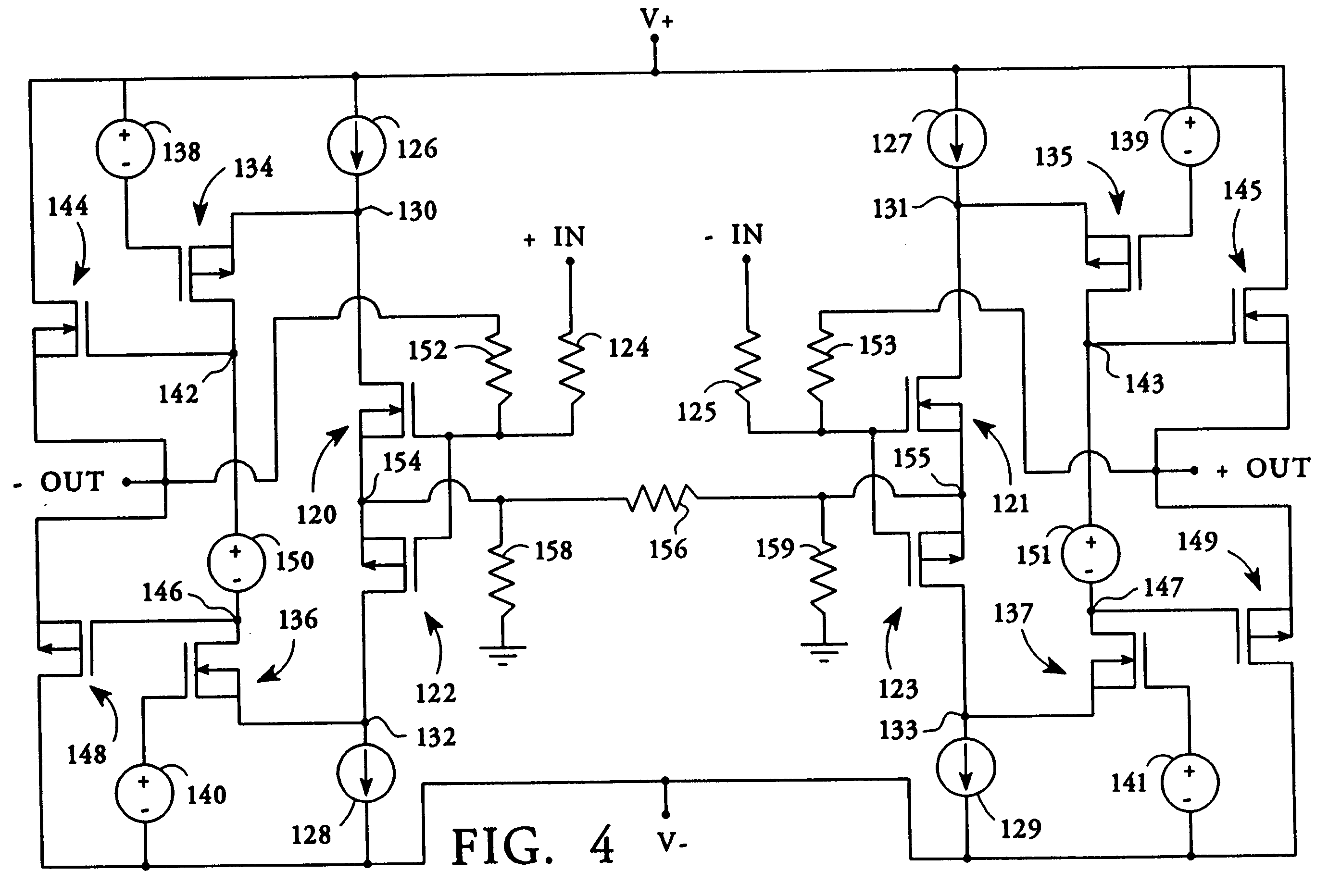

Uh, I didn't patent that topology per se, just the concept of the feedback
arrangement. The complementary 2 stage folded cascode was the example
vehicle. It became the 1,000 watt X1000 in 1997, but used feedback only
around the front end.
I dug up a copy:
