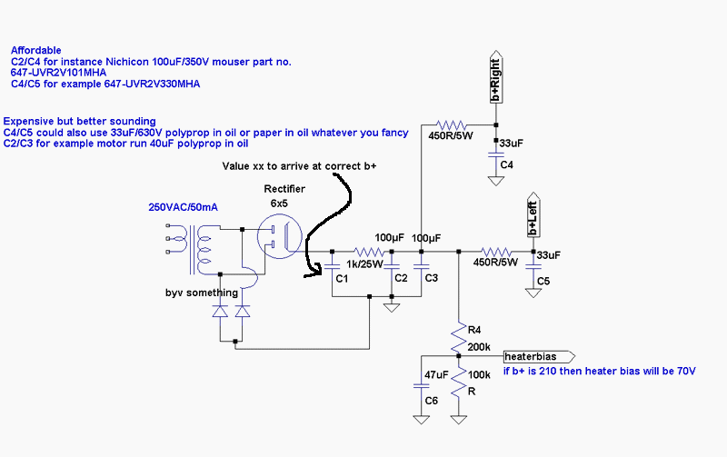

Plus there is something that is not solved in the PCB and that is to "elevate" the filament/heater to say 60V (because of heater cathode insulation specs)
The heater/cathode insulation of most small signal tubes is around 100V (up and down)...the cathode of the second triode inside the "bottle" is at around half the b+, in this case around 100VDC.. if you bias the heater up to the example of 80v the top one will see a 40v potential difference and the bottom one 60v difference..for example.
This elevation is done by referencing the center tap of the heater transformer to a particular voltage by making a voltage divider on the b+ supply. (Schematic hopefully tonight)
Or by referencing the negative wire from a dc supply to that particular voltage.

What transformers are needed for 2 channels ? I'm looking for them now..do you have the voltages ?
Off the shelf ones are for example :What transformers are needed for 2 channels ? I'm looking for them now..do you have the voltages ?
Lundahl LL1649 or LL1683
Hammond 269AX
