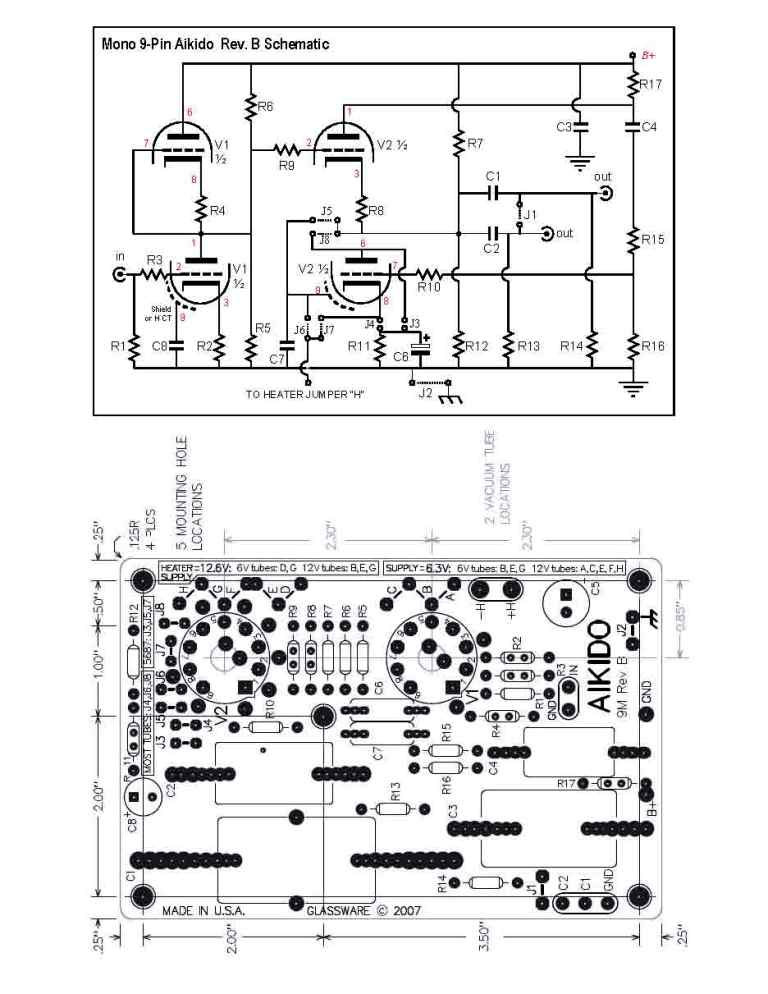

Thank you for the information. I will go with a 6.3V heater supply, with the 6SN7 heaters in series. I am not sure what the heater bias point is on the Aikido PCB. Is that the "H+"? Also not sure what are the 6.3V - CT - 6.3V windings.
Attached is a jpeg of a schematic and diagram of the 9-pin mono PCB. Although I am using the Octal mono PCB, the boards are very similar. The jpeg shows the various connection points, including the "H+". If it would not be too much trouble to veryify on the jpeg for me, I would greatly appreciate. I do not want to have any electrical accidents.

kvardas said:Thank you for the information. I will go with a 6.3V heater supply, with the 6SN7 heaters in series. I am not sure what the heater bias point is on the Aikido PCB. Is that the "H+"? Also not sure what are the 6.3V - CT - 6.3V windings.
Now you've got it mixed up. Better read my post again. If you use 6.3V heaters, you wire the tubes in parallel. CT refers to a center tap on the filament output. The center tap is connected to ground or sometimes connected to the DC reference point. If you have a transformer with no CT, you need to make an artificial one using two resistors. You can find more info on this by searching the forum.
Also, why are you asking for confirmation on the 9 pin jpeg? Why don't you just use the Octal layout that John Broskie has available? Not really sure what your thinking is behind this....
I meant parallel, not series (I think the doctor did indeed drop me...)
I used the mono 9-pin because I do not have a digital copy of the octal mono PCB.

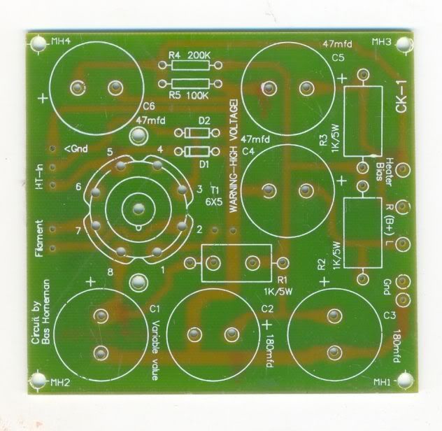

Hi everyone, I'm putting together an aikido using Bas's PS boards along with Broskie's octal mono boards.
I've stuffed the PS boards according to Bas example, He also recommended that I go with 30 uf for c1, what voltage rating am I looking for?
The trannies Im lookin at is the hammond 270bx, 2 of them to 2 seperate PS boards for true dual mono approach. Will these work?
Can I run the 6x5 off the 5v,2A winding, and the 2 6sn7 off the 6.3v,2A?
I'm looking @B+300v , Bas has informed me that I will probably get about 280v, unless I use a choke which should be fine.
All the caps should of ratiing above 400V.
6X5 filament voltage rating is 6.3v so it be supplied with 6.3V for optimum operation.

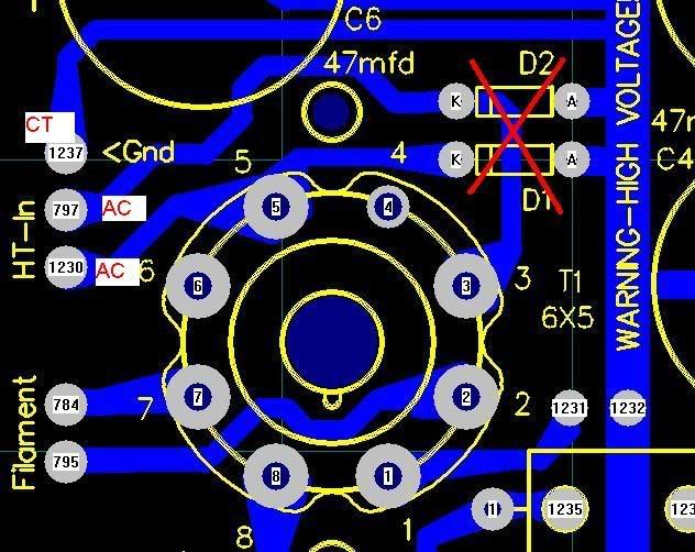

TRANSFORMER, POWER, HAMMOND 270BX, 275-0-275 V, 50 mA
Please check with Bas, if you are using Center tapped transformer then you must put jumpers in place of semiconductor diodes.
semi. diodes are only required only with a 0 - 275V
transformer.

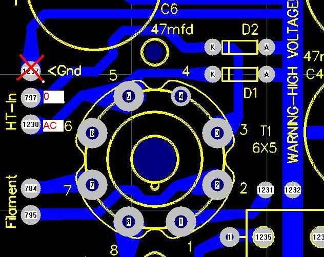

No jumpers and no diodes if you are using a center tapped transformer. The diodes should only be placed if there is no center tap on the transformer.
cool, so i should b able to run the heater for the 6x5 and 2 6sn7 off the same 6.3v, 2.5a without any problems?
