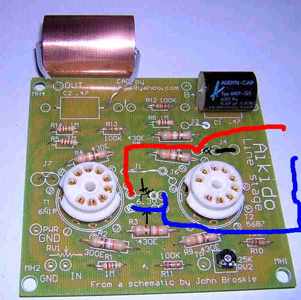

Hi Steve,
Depending were I look, the 269AX is shown with either 1 or 2 filament windings.
Why don’t you post the number and colors of all the wires you have…John

John-
The transformer markings are:
primaries (115) black-black
sec 1 red-red/yellow-red 250V (125-0-125, I assume)
sec 2 green-green 6.3V (both 6.3 or 6.3-0?)
Using the 269AX for the PSU the secondaries would go:
sec 1 the red's would go to the AC in pads and the center tap to ground (yes?)
sec 2 the green's would go to the filament pads for the rectifier tube (yes?)
Bas' manual indicates when using the 5687 tube in position 2 to provide separate voltage lines to the heater for tube 1. This would suggest to me I have four separate 6.3v lines to deal with. I can see a way to do it with two of the RS transformers.
Could I do it with one of them if I "separate" the center tap? And if so, how?
Thanks Dave, John, Bas
Steve
OK just one 6.3v sec. Use it for the rectifier tube (fil pads) and connect the two red leads to the AC pads.
In this case you do not use the CT ( red/yellow). Just tape it off well.
As for the other filaments. At this point, let’s drop the RS transformer and get a 6.3V CT. Hammond 166n6 will do nicely. Connect the CT(green/yellow) to the power supply PCB bias point.
The two green will feed all four signal tubes. The 6nip go to pins 4 & 5. For the 5687, one side goes to pin 8 the other to Both pins 4 & 5.
I did not use the 5687 in my Aikido so I don’t know how folks arranged there wiring off hand, but I will try to post something a bit later…John
John-
The power supply PCB bias point being the pad labeled heater bias.
Assuming your diagram is correct, could I take each green lead to a terminal strip and have two leads coming out (basically making four leads) and then take them pairwise to each channel.
BTW, the RS transformer is a 6.3V CT transformer.
SteveA
Yep.
Yes, assuming.
this was ment to give you a idea of how to wire and what points might be used. Other 5687 users might have a better idea.
In any case make sure that you twist the filament leads as tight as you can, to reduce hum.
What you need to do is, download the tube data sheets and verify that the heater pins are were I said they are (trust but verify)
Now take a sheet of paper and draw what you know
Perfect! That is how it should be wired.Maybe Bas would be kind enough to check...John
Yup!Assuming your diagram is correct, could I take each green lead to a terminal strip and have two leads coming out (basically making four leads) and then take them pairwise to each channel.
Great...just like mine. Thus you should connect the center tap to the bias point on the psu.BTW, the RS transformer is a 6.3V CT transformer.

Example of wiring the boards with a Hammon 369JX transformer
Compromised URL removed by Moderation
only one channel shown wired...

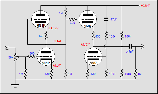

Aikido voltages not equal
Well, my Aikido is hot. The TubeCad blog0011 schematic. 6N1P into 5687. PSU voltages are B+ at 218 at the anode (pin 1) on the first (upper) triode on each tube. But, here are my voltages at the reference points:
6n1p upper triode cathode - Left channel 109, right 146 - should be 111.4
6n1p lower triode anode - Left channel 108, right 144 - should be 110.
6n1p lower triode cathode- Left channel 1.3, right 4.3 - should be 1.2.
5687 lower triode anode - Left channel 108, right 138 - should be 110.
What could be the cause?
Also wondering about series connection of the 6n1p heaters on my 12V supply the first measures 12V, the second 6V. Is that normal?
Any help would be appreciated. This late in the day, my reasoning is getting weak.

The first tube seems to be close to the average of the 6N1P, the second one seems to be much more far away (don't forget the given voltages are the result of Pspice calculation with perfectly matched tubes... welcome in the real world🙄 )
Are the tubes already burned in?
jacques

Feeling seriously foolish.
I guess a cathode resistor off by a factor of 34 would be enough to muck up the loadings on the tube. Out with the 15K, in with the 430R. My apologies.

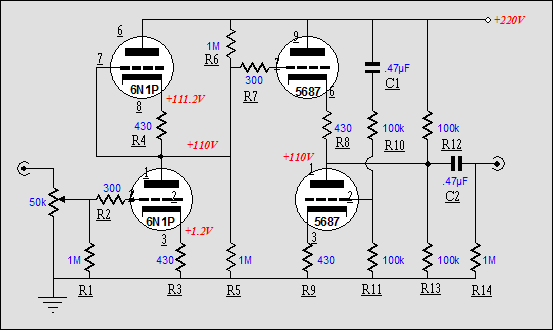

Aikido voltages not equal Post #473
Maynard
According to the circuit board I have pasted the resistor numbers in order to make it easier to track.
