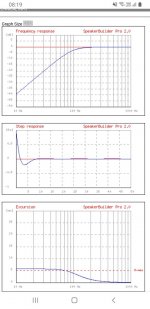

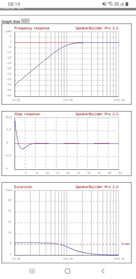

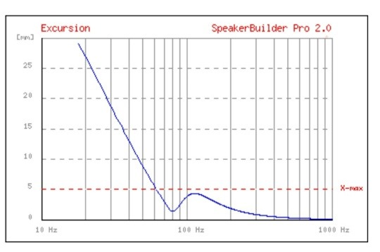

I did a quick simulation for you at this website.
http://sbp.softica.dk/2.0/en/
For bass reflex this is how it looks like at 40W. Which is as much as you should go without frying your satori.
In fact if 80Hz is all you intend it to go you should consider sealed for better bass transient and a smaller cabinet actually at only 3 litres.
