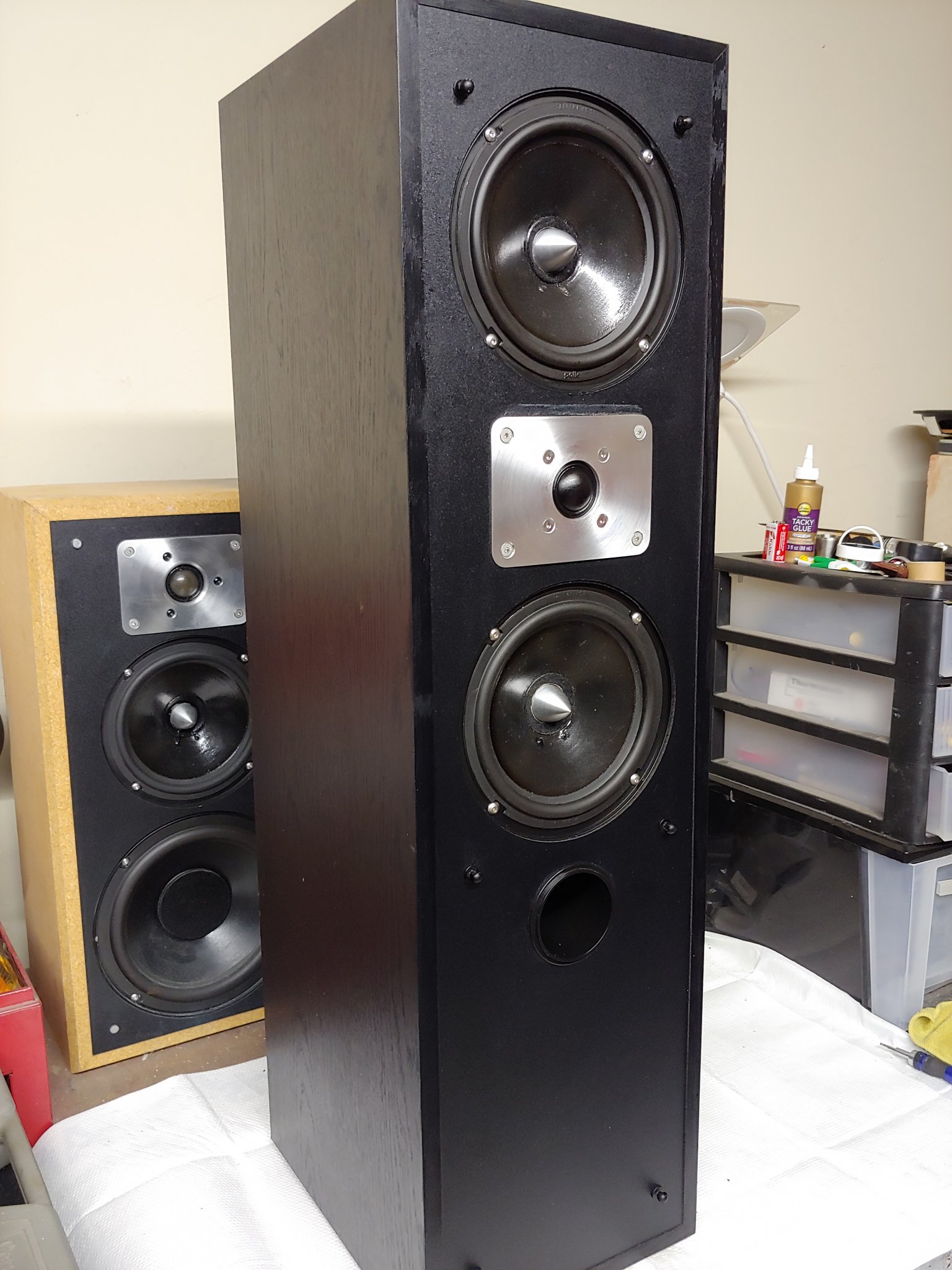

Although I agree with your statement for most vintage factory Polks, I haven't owned a set that I didn't modify to the hilt.
8TLs are no different. The sound is exceptional...

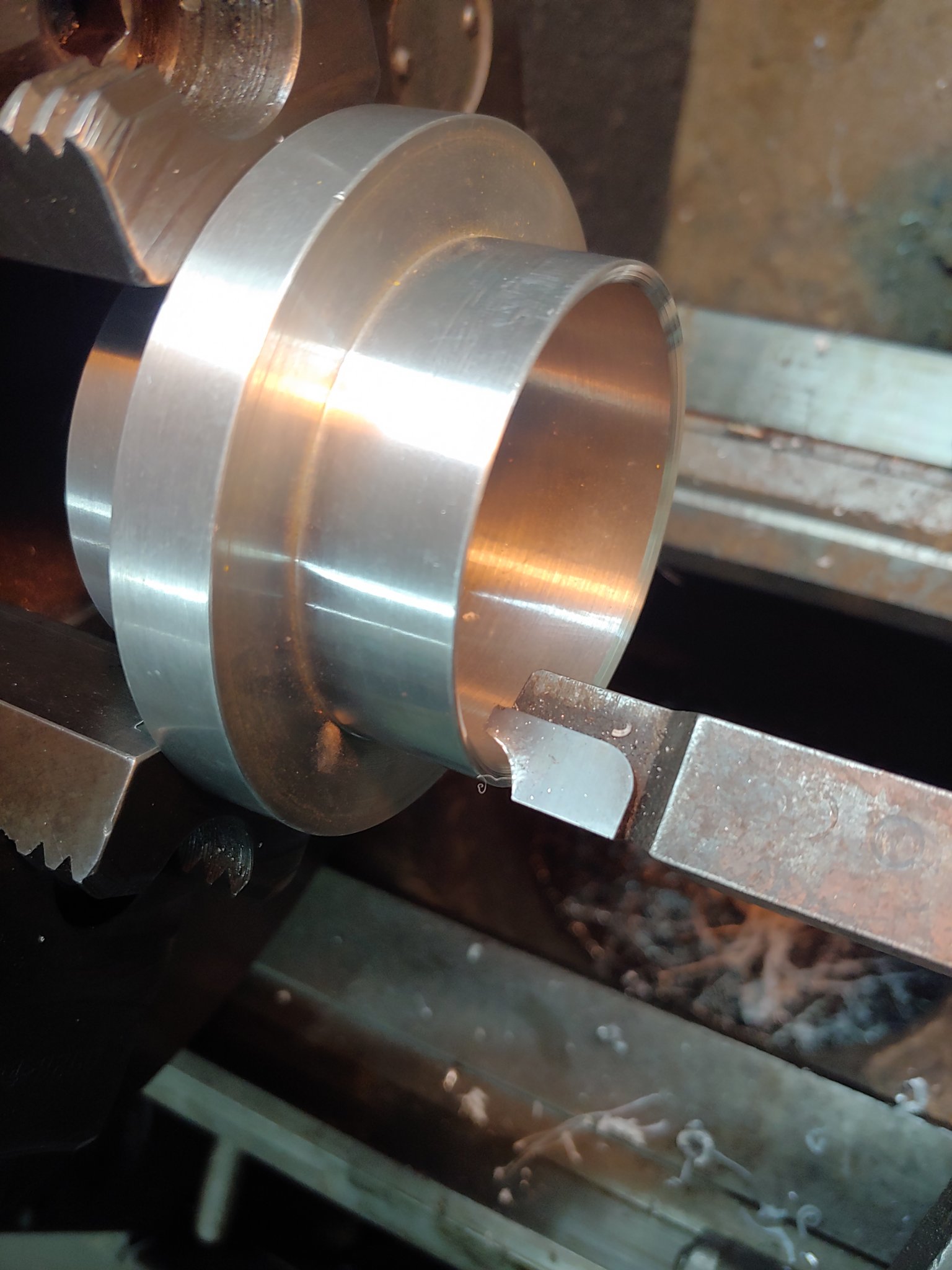

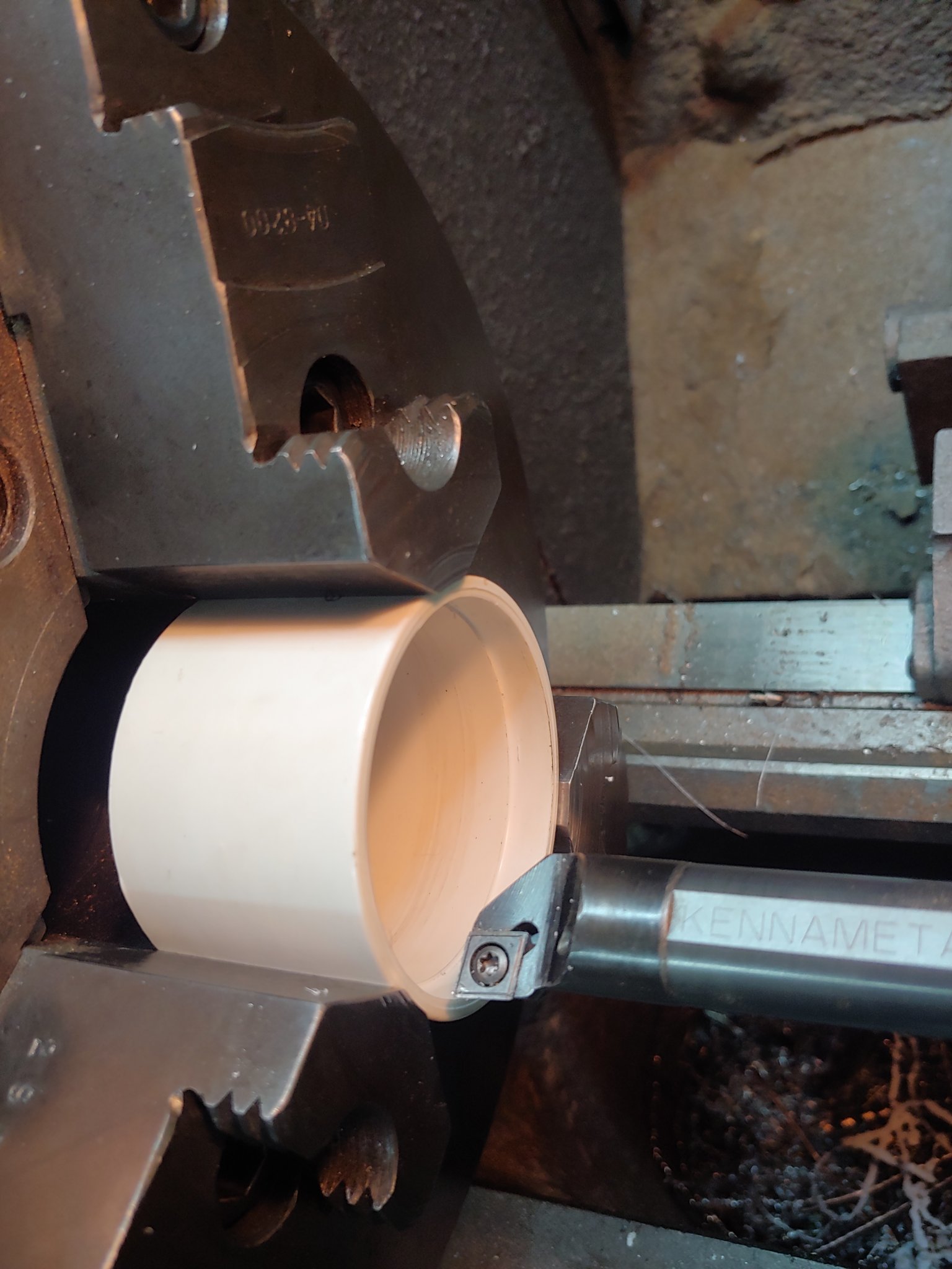

Glue is dried. This time I used Liquid Nails as it cures better than Power Grab to the alum and pvc plastic. I simply used a 2" PVC coupler because I only needed an extra 2" length (3.5" long by 2.25" ID. and I can test and pull out cabinet and lathe turn 'til I like the bass tuning)
I also glued and punched out the factory rubber pad for easy access to cabinet mount screws this time. I Don't know why Polk didn't do this originally, but this added alot more mass and damping to the platform, and I don't have to peel back the pad for access...
