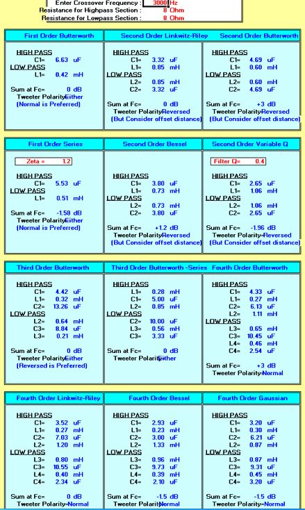

Jeff Bagby for 8 ohms:
626561d1500481207-crossover-amplifier-output-impedence-jeff-bagby-filter-values-jpg
Nice calculators:
RF Tools | LC Filter Design Tool
2-Way Crossover Calculator / Designer
I tried Jeff's 8 ohm values for BW3:
591258d1484013729-flat-impedance-flat-power-response-design-flat-impedance-series-filter-circuit-png
591257d1484013729-flat-impedance-flat-power-response-design-flat-impedance-series-filter-fr-png
591259d1484013729-flat-impedance-flat-power-response-design-flat-impedance-series-filter-bw3-18db-octave-electrical-png
Not a bad BW3! Expected flat impedance from a constant power filter. No bafflestep correction, though the high-inductance bass has it built in largely. In practice, 6 ohms is usually nearer for 8 ohm nominal.
