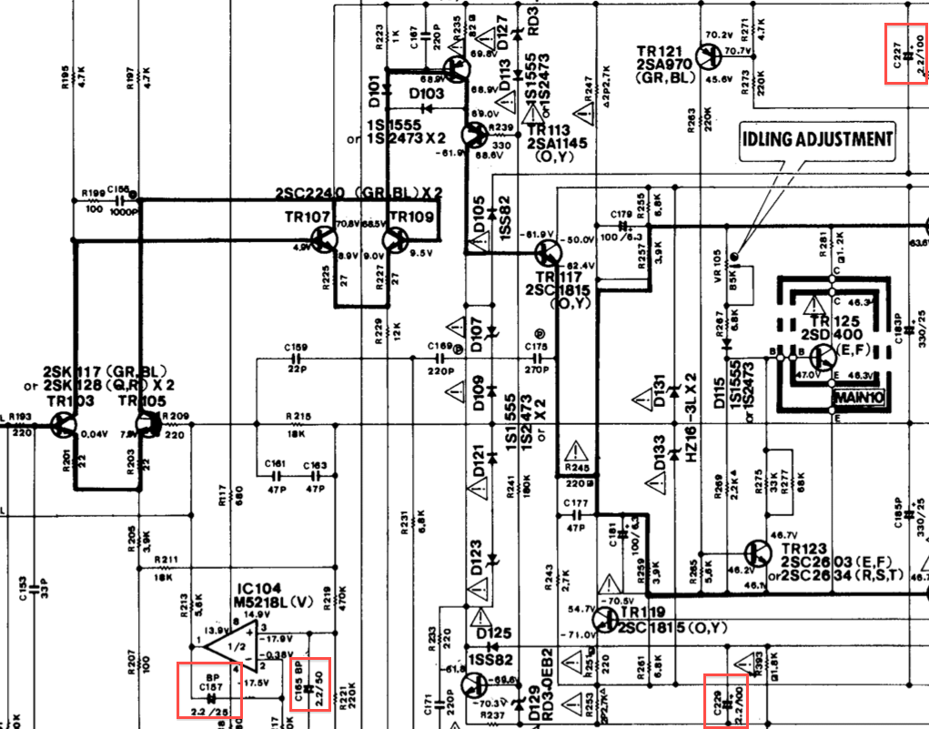

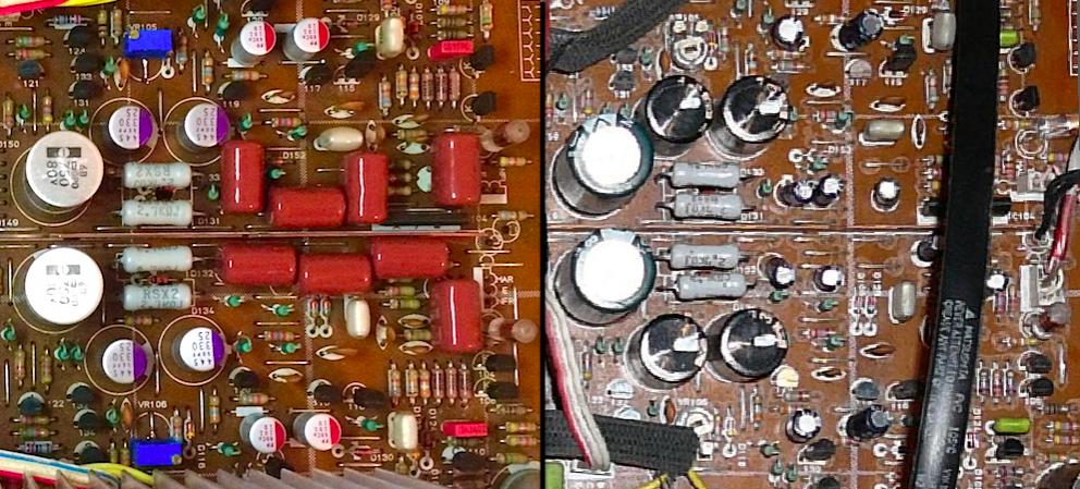

I thought it might be better posting the schematic marking the capacitors in question along with a photo showing the orientation, this is probably an extreme case since the replacements were polypropylene (Panasonic ECWF) and notably larger.The bipolar electrolytic is likely to be smaller so it is possible that in some applications it would have smaller stray capacitance to other nearby items.
Schematic shows (4) parts for one channel, the 2.2uF 25 x1 and 50V x1 (both BP) are for the DC servo, and 2.2uF 100V x2 (polar) are general filtering from my understanding.
I can't notice any difference subjectively (when those parts alone were changed) but am curious if you see any obvious theoretical flaws.
Two main things to look out for when thinking about stray capacitance are:
1. AC mains (or heater supply) on nearby conductors - mostly a problem at high impedance points in the circuit - the effect is increased hum
2. another circuit point with significant size (e.g. another cap?) which carries the same signal with the same phase but very different amplitude - scope for positive feedback leading to instability or at least an HF peak
Polypropylene or polyester or any other film cap is likely to have low ESR so the same issue arises if the original circuit designer was relying on electrolytic ESR (either deliberately or accidentally) to dampen a resonance.
In many cases the only way to find out (for both issues mentioned in this post) is to try it. Sometimes it works OK, sometimes it does not. The main point is that naive 'upgrades' can sometimes do harm. Be aware that a small amount of signal degradation (e.g. HF peaking falling short of oscillation) may be heard but could be misperceived as an improvement - especially if lots of money has been spent.
