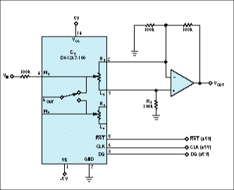

Dual-polarity amplifier has digital control
I stumbled upon this page tonight Dual-polarity amplifier has digital control and thought that it might be useful for DIYers.
"The circuit in Figure 1 can amplify a signal either in an inverting or a noninverting mode. When switch S1 is on and S2 is off, the circuit behaves as a regular inverting amplifier. When S2 is on and S1 is off, the circuit feeds the signal to the noninverting input of the op amp; thus, the circuit behaves as a noninverting amplifier. If S1 and S2 are monolithic analog switches, you can control this circuit using a digital signal.
I am not sure if the attached images are copyrighted.
Eric.

This is a digital pot version of the WW/EW circuit that I referred to previously.
You can implement the same idea using a potentiometer instead of switches (Figure 2). Setting the wiper at the high end of the potentiometer selects inverting-mode operation; setting the potentiometer to the other end selects the noninverting mode. IC1's linear digital potentiometer digitally controls not only the polarity, but also the gain of the amplifier. Because many digital potentiometers come in dual configurations, you can use the second potentiometer for the gain adjustment. "
