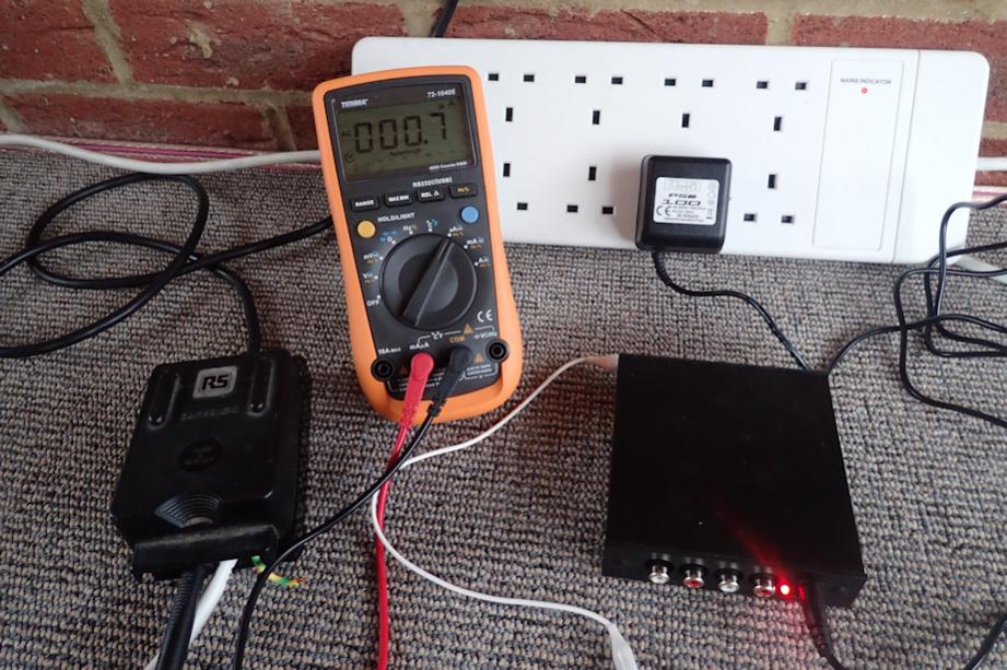

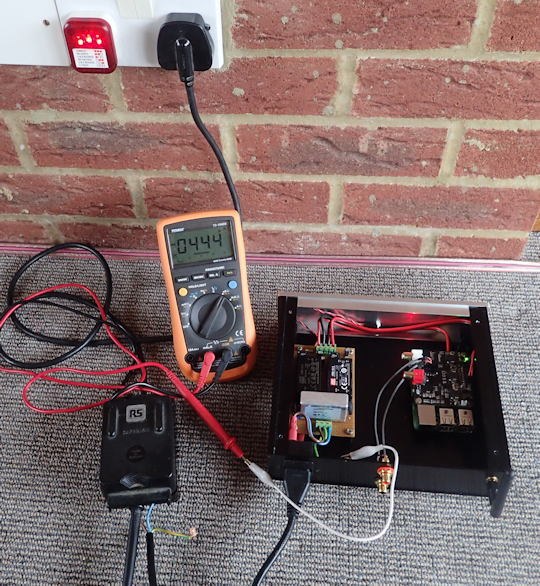

My Audio chain is short, deliberately so, typically it is just my media player, amp & speakers.
The source is a RPi media player that has two internal SMPS's (DAC & RPi) and a EMI filter on the mains side. Measuring that gave me an earth leakage when wired correct (LN) of 444uAac and phase reversed (NL) 444uAac. So no surprise there given the different PSU topology.
Next I thought I'd look at something that uses an AC wall wart that does not use a safety ground. My Rega phono preamp. I also took the opportunity to measure the output of the PSU when disconnected from its load, the preamp.
LN 0.7uAac floating output of 29.60Vac, NL 0.5uAac floating output 29.58Vac.
So in this case, according to the blurb I should swap LN around to make the most of the 2uA & 2V difference. Being a moulded wall wart the only way that can be arranged is to have a separate plug / socket assy. This would not pass UK specs and I would suggest that the added resistance caused by those 2 extra connections may well undo any benefits.
In the test described I'm not sure of the value of voltage testing in respect to the fact that in reality this connection should NEVER be disconnected. It is there for your safety! That is why I measure the leakage current.
