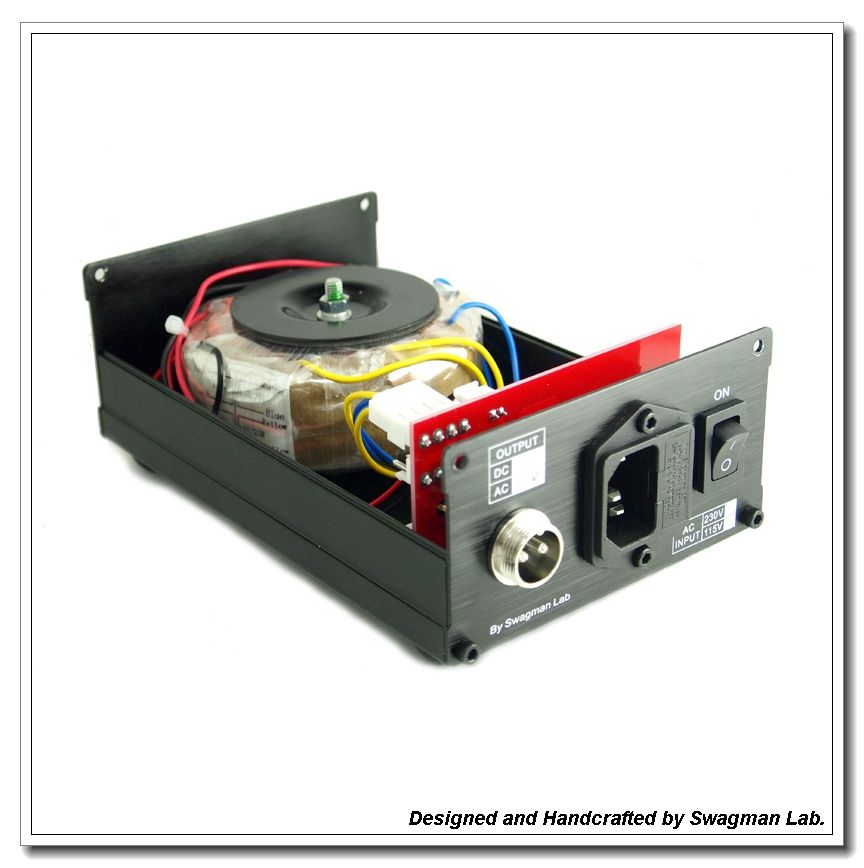

Every component I now have has a toroidal transformer. If I flip the plug at the outlet and measure by connecting to a ground on the chassis of the PSU with nothing else connected to it? One plug orientation will read lower than the opposite plug orientation. Every time.
now... If I connect the PSU to power a component that requires and external PS? And, this time take the same kind of measurement at the component? The same phenomena takes place. One plug orientation at the wall outlet will give a higher reading than the opposite orientation at the component's chassis.
This can be measured and verified.... I do not claim in the least to know what is the actual cause. But, we have been taught the lower reading will give the lower noise (distortion) added to the music. And, my ears testify to that being true. When the lower level is found the music becomes audibly smoother and more relaxed.
I may not know what is taking place when the lower plug setting is determined by a VOM... But, my ears have been telling me its a good procedure to follow.
Like I said. You can verify it for yourself. Just make sure what ever component you measure is isolated and not connected to any other component. Remove all interconnects.
I understand how that would be the case with a piece of equipment when using it's internal transformer, I'm at a loss as to how or why it would also be the case with an external transformer. I have no means to verify it myself unfortunately as all my equipment has internal transformers.
Does the component connected to the external PSU have an earthed chassis?

In almost all transformers the primary is many layers. The layer closest to the core couples more to it than the outer layers. Even with a remotely mounted transformer there is capacitance from the primary to the secondary. That is why with even a wall wart the is a difference in AC primary feeds to chassis noise.
I don't understand that, if the chassis is isolated, how is an AC feed coupling to it?
Yes.... even the original wall wart that came with the unit showed the same preferred outlet orientation when chassis noise was measure. It was counter intuitive. For, I had to turn the wall wart so the power leads were facing upward. Intuitively, most would plug it in with the leads dangling down.

Two transformers could still be "out of phase". You are not measuring the phase, only the voltage to ground. It is quite possible that a second PSU could measure or be connected differently.
So...One might want to check to make sure that the plug orientation of all the components in their system are in phase with one another.
This I do know... When I get all my components "in phase" with the AC outlet with how I have been measuring it? The music is smoother and more enjoyable to listen to. That is why I check for plug orientation... It might prove to be a matter of getting all the components in a system to work in phase with one other. That way everything in ones audio system is flowing in the same way acting as a single unit. Possibly whats taking place?
Re-read post 30. It's not a matter of matching each components 'phase'. You are selecting the lowest leakage/noise arrangement per component. One leg will always have more leakage than the other. The higher leakage leg is ideally connected to neutral. Get each component correctly oriented, you have the lowest leakage and lowest noise. There really is no 'matching phase' between components; this isn't a real-time alignment going on, this is impedance selection.

The Guitar amp have a "GROUND REVERSE SWITCH" this give the user a little hum or more hum. The switch injects or sucks out some leakage currents into or out the chassis. The switch is connected to the HOT or the NETURAL of the AC LINE then through a capacitor to the chassis. This work to balance out the leakage currents to reduce any hum currents.
The power transformer primary winding is not balanced and the START or FINISH of the winding has more leakage to the core. As you say reversing the primary wires causes the change in hum/leakage currents to the chassis.

That's the thing. AC "phase" has meaning only in-reference-to another AC signal. Left and right. Red and Black (on a US split-"phase" 240V feeder).
You may instead be, as someone says, testing for lowest *leakage*. A very different matter.
