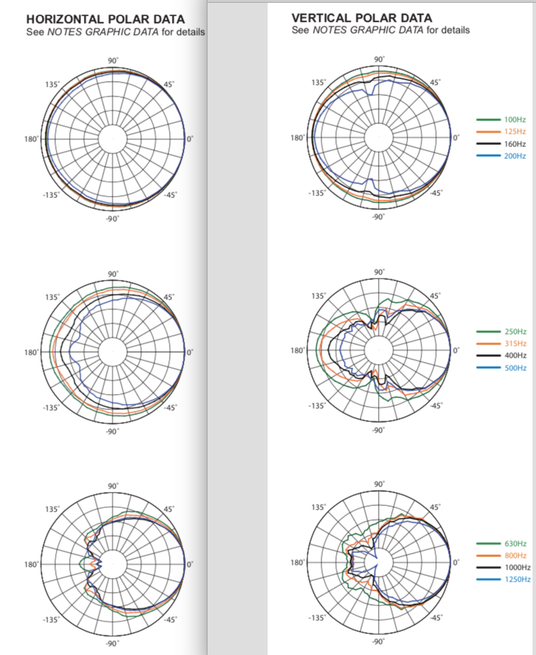

I need opinions from some pretty smart people on this one, as it's just slightly past my pay grade:
The basic question concerns polar response graphs, and how to interpret them as to how the speaker will sound / react in an actual room.
It’s a good question on general principles, but also (of course) pertains to a specific quandary I have right now. Here are the details:
I just bought a used pair of EAW KF394’s.
They have a basic dispersion of 90º H x 45º V.
They are a 3-way box, using the BMS 4594ND coaxial for the mids & HF. This is attached to a 90x45 horn, but this horn’s outer dimensions are square. I don't yet know where the tens cross to the coaxial, but it surely must be around 400 - 500 Hz, as it typical with the 4594.
For both ergonomic and aesthetic reasons, I am thinking about rotating the horn 90 degrees, and then mounting the cabinets sideways. In other words, the horn would remain 90º H x 45º V, but the tens would now be at the left & right, instead of the top & bottom.
Because the tens are simply vented, with no apparent dispersion control, I assumed that this would make no difference in the expected 100 - 500 Hz “low mids” range. - But then I checked the polar response graphs. I’m now a bit puzzled.
There is, to my surprise, a serious variance in frequency coverage in the (stock) vertical direction, from 100 to 500 Hz. (esp above 250 Hz)
## But I’m not even sure which way would sound best in an actual room, which is why I’m posting this query. I’m trying to decide if this “sideways box” orientation (again, with the horn remaining as it was) is a bad idea, or could possibly be an improvement. (Again, in an actual room, with real-world reflections.)

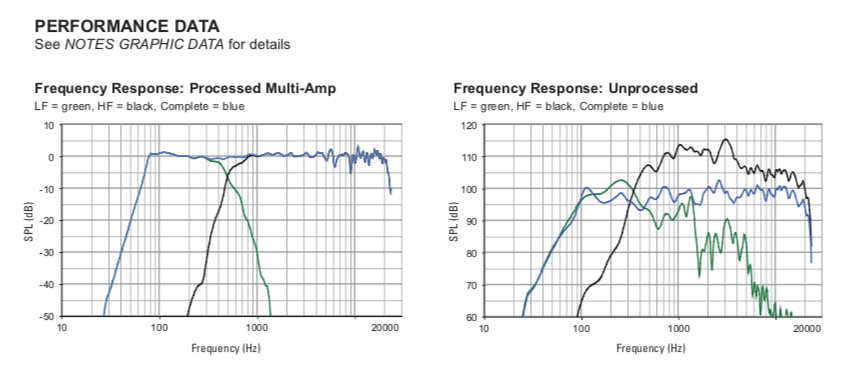

The response graphs can be seen here:
https://eaw.com/docs/1_Current_Products/KF/Spec_Sheets/KF394_SPECS_revA.pdf
I've also pared down the pertinent data to a single jpeg, so it's easier to see, but I don't know how to post it. (Any ideas?)
So, what do you guys think?
Am I reading the graphs wrong?
If not, should I worry about this? 250 - 500 Hz is the “mud” octave, anyway. Maybe I’m better off with less on the sides, because that octave tends to build up in smallish rooms, anyway?
Not to mention, stock horizontal gets pretty tight above 600 Hz. Almost as tight as the HF. So really, the vertical orientation has a more even response above 200 Hz ! Why not make that the horizontal instead?

The recommended active crossover appears to be just under 500Hz.
With regards to the original question, it looks like mounting the cabinet horizontally (and rotating the HF horn to keep is 90x40) would give you a very consistent beamwidth in the horizontal plane. That's generally a Good Thing.
However, your vertical beamwidth would end up with a lot of variation. Bad Thing.
Doing as you suggest would mean you're bouncing less lower-midrange off the walls, but more towards the ceiling and floor.

1) The 10" are a spaced pair of offset horns with porting. They are around a wavelength apart at 600 Hz, the spacing results in the vertical pattern control variations, the horizontal pattern gradually and evenly narrows with increasing frequency.1)Because the tens are simply vented, with no apparent dispersion control, I assumed that this would make no difference in the expected 100 - 500 Hz “low mids” range. - But then I checked the polar response graphs. I’m now a bit puzzled.
2) 250 - 500 Hz is the “mud” octave, anyway. Maybe I’m better off with less on the sides, because that octave tends to build up in smallish rooms, anyway?
3)Not to mention, stock horizontal gets pretty tight above 600 Hz. Almost as tight as the HF. So really, the vertical orientation has a more even response above 200 Hz ! Why not make that the horizontal instead?
2)The stock KF394 configuration keeps some of the low mid "mud" off the floor and ceiling, where standing waves tend to make those frequencies more problematic.
In most rooms, the horizontal response is more important than vertical, since the audience is dispersed wider horizontally compared to vertically.
Rotating the cabinet will make the low mid response less even across the audience, and put more low mid energy on the floor and ceiling.
3) Above 630 Hz, most of the control exhibited in the polar response graphs are due to the HF horn.
Your aesthetic and ergonomic considerations weigh against a relatively small low mid dispersion difference, but rotating the HF horn will result in a compromised, negative sonic effect in a frequency range you seem to be critical of.
Thanks, Art. This is very helpful.
A very good point about low-mid standing waves, which Chris also mentioned & which I should have realized myself. Whatever the actual comb filtering, those effects will be much more prominent floor-to-ceiling than wall-to-wall. (unless the ceiling is REALLY absorbent.)
- And believe it or not, I actually understand your first paragraph! I have been reading today about MTM designs, and how critical the two outer speakers distance is for pattern response, in conjunction with the crossover point & slope. (My head hurts....)
I'm guess that they are using a 2nd order x-over at 500 Hz, because that does in fact tighten the response within the x-over region, so would certainly have some effect down to at least 250 Hz.
Would you agree, or am I understanding this wrong?

I don't understand what you mean by "tighten the response within the x-over region".I'm guess that they are using a 2nd order x-over at 500 Hz, because that does in fact tighten the response within the x-over region, so would certainly have some effect down to at least 250 Hz.
Second order is only a 12dB per octave slope, the processed response of the KF394 shows a 500Hz fourth order (24dB per octave) response for both the LF and Hf sections. The unprocessed response of both HF and LF sections are different, requiring different filters to arrive at the intended acoustical response.
.... The unprocessed response of both HF and LF sections are different, requiring different filters to arrive at the intended acoustical response.
AH, that's how they're doing it.
I understand now. Thanks.
FWIW, what I meant by "tighten the response within the x-over region" has to do with the way the polar response narrows, in an MTM system, with a 2nd order x-over. - I had just been reading about this stuff the entire day. But I guess, had they done that, it would have tightened in both vertical and horizontal.
