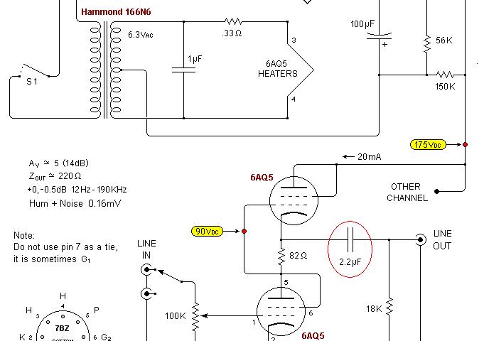

dstockwell said:...can I substitue the 2.2uF 1200VDC Mundorf SS cap with either (2) 4.7uf 630VDC in series or will it hurt to drop down to 2.2uF 1000VDC..
One 4u7/630V will be just fine.
(I'm not an expert.)
Milan
dstockwell said:Do you not need two 4u7 in series since the circuit calls for 2.2![]()
It's only a coupling capacitor, so 4.7uF will be better than 2.2uF, giving better low frequency performance (although it's probably too low to make any difference).
You only need 2.2uF 250V for this coupling circuit. 400V is more than sufficient.
