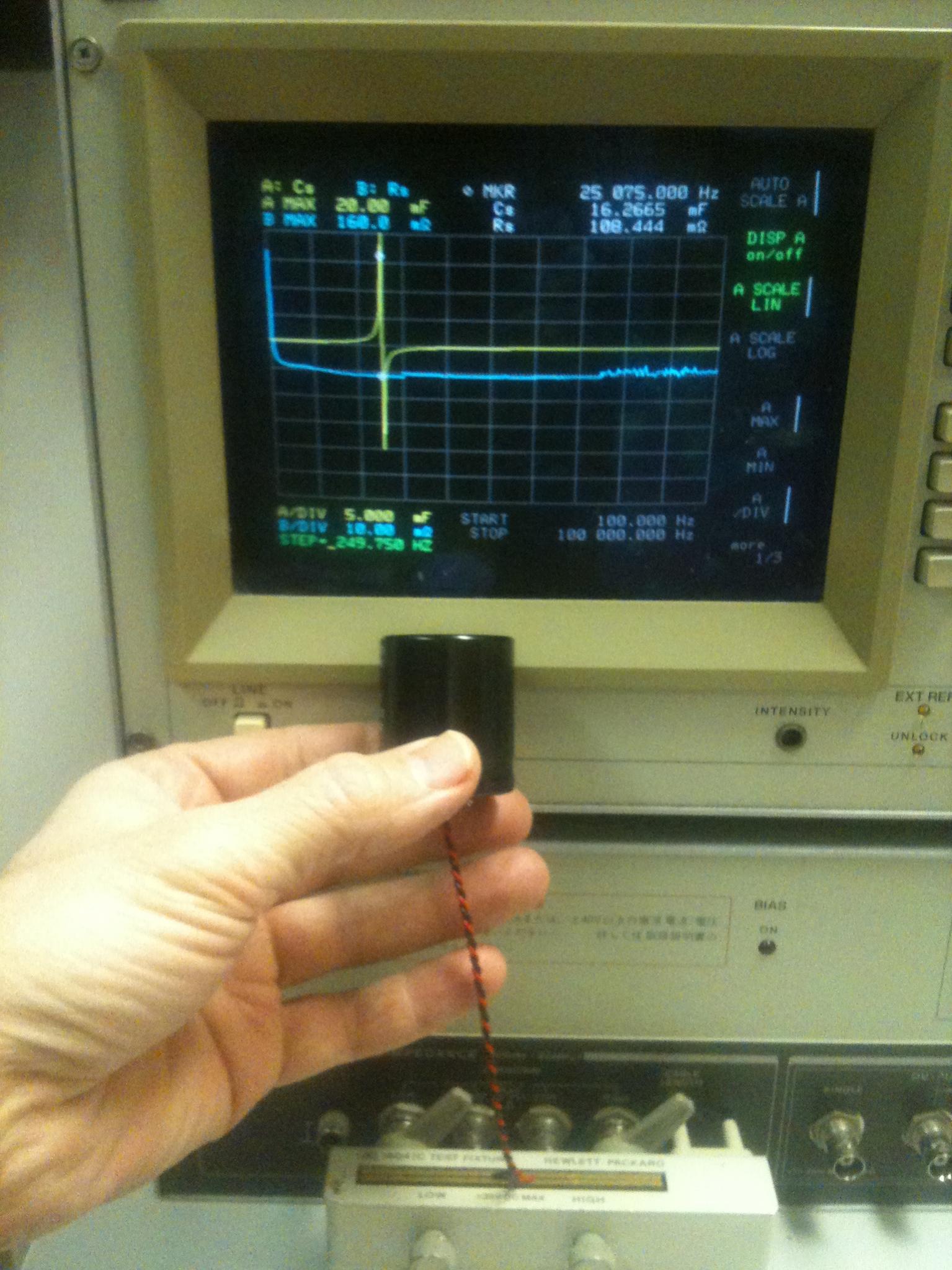

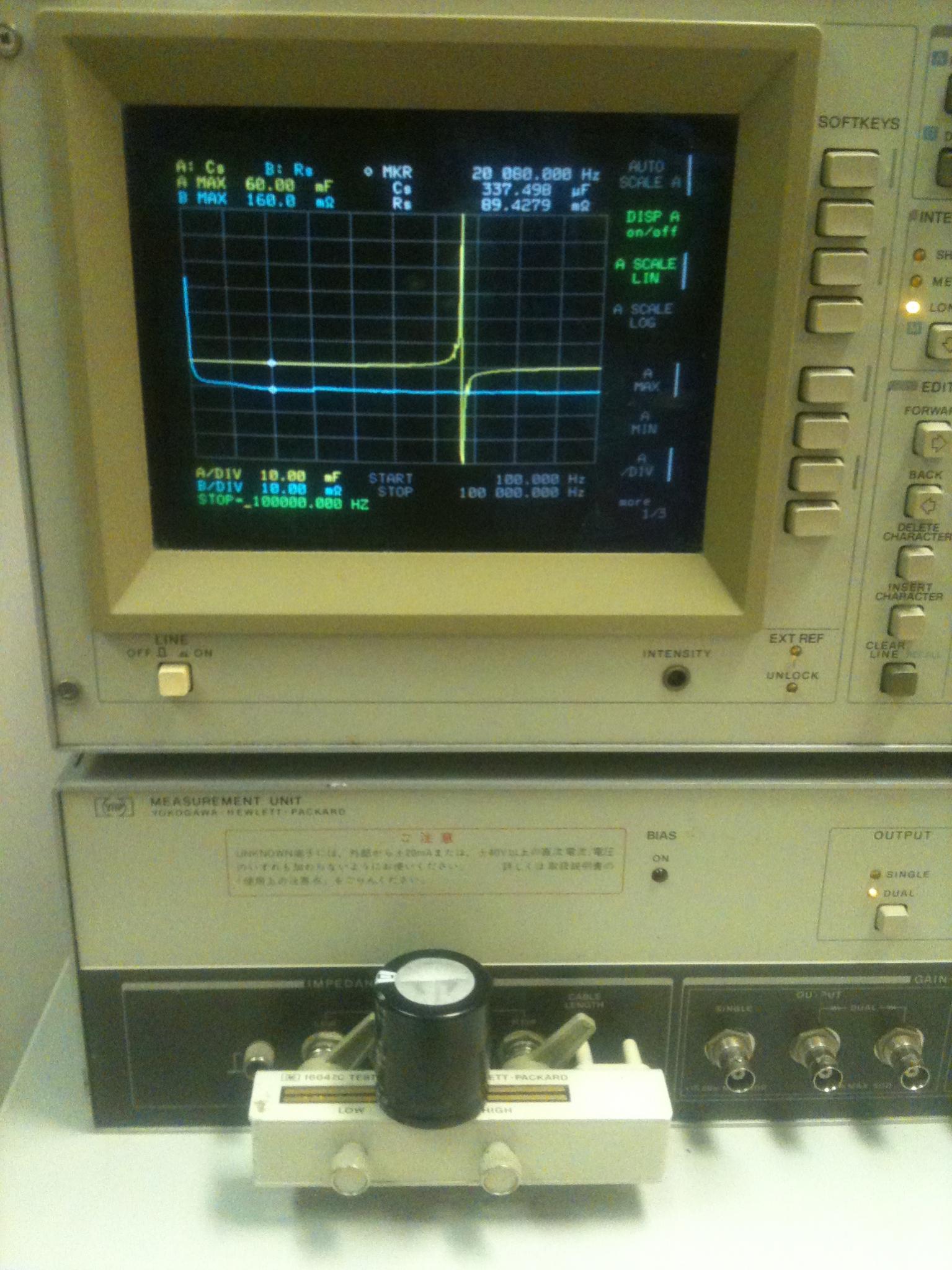

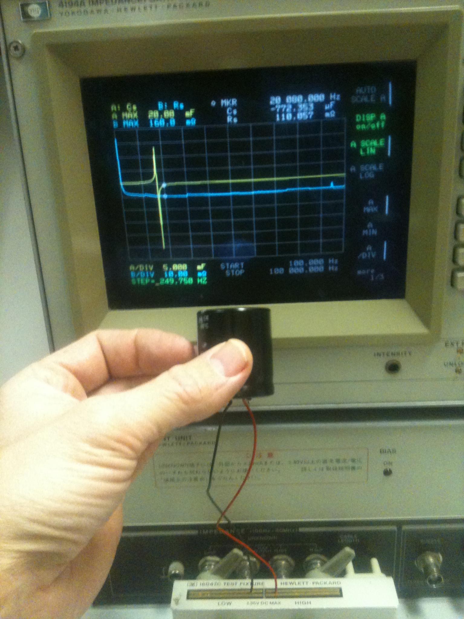

Either way, here are some shots done on the analyzer of a 390uF/450V electrolytic with and without 5inch wires. Note how the resonant frequency goes from 65kHz without wire, to about 15kHz with straight wire and back up to about 25kHz with the same wires twisted.

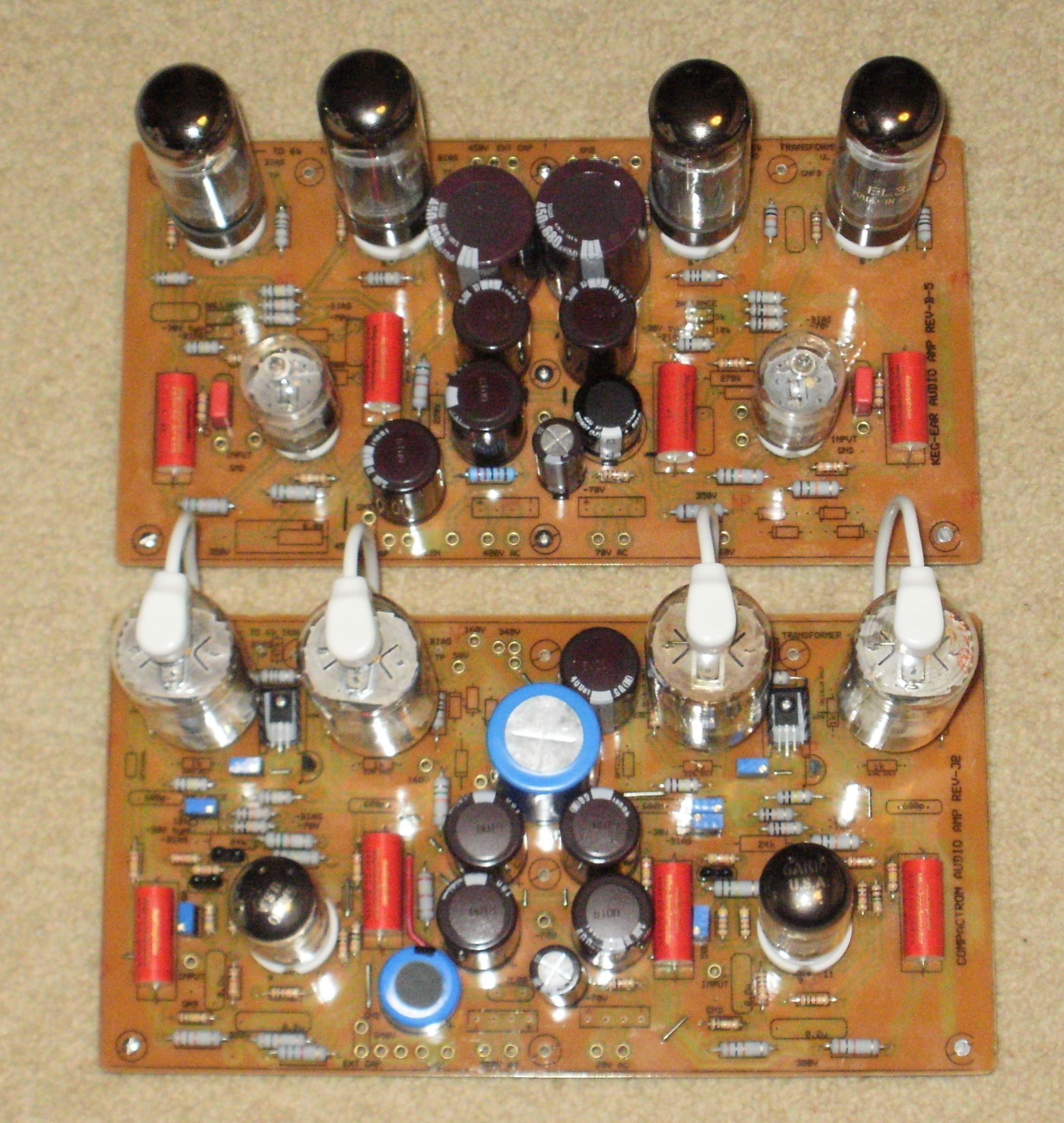

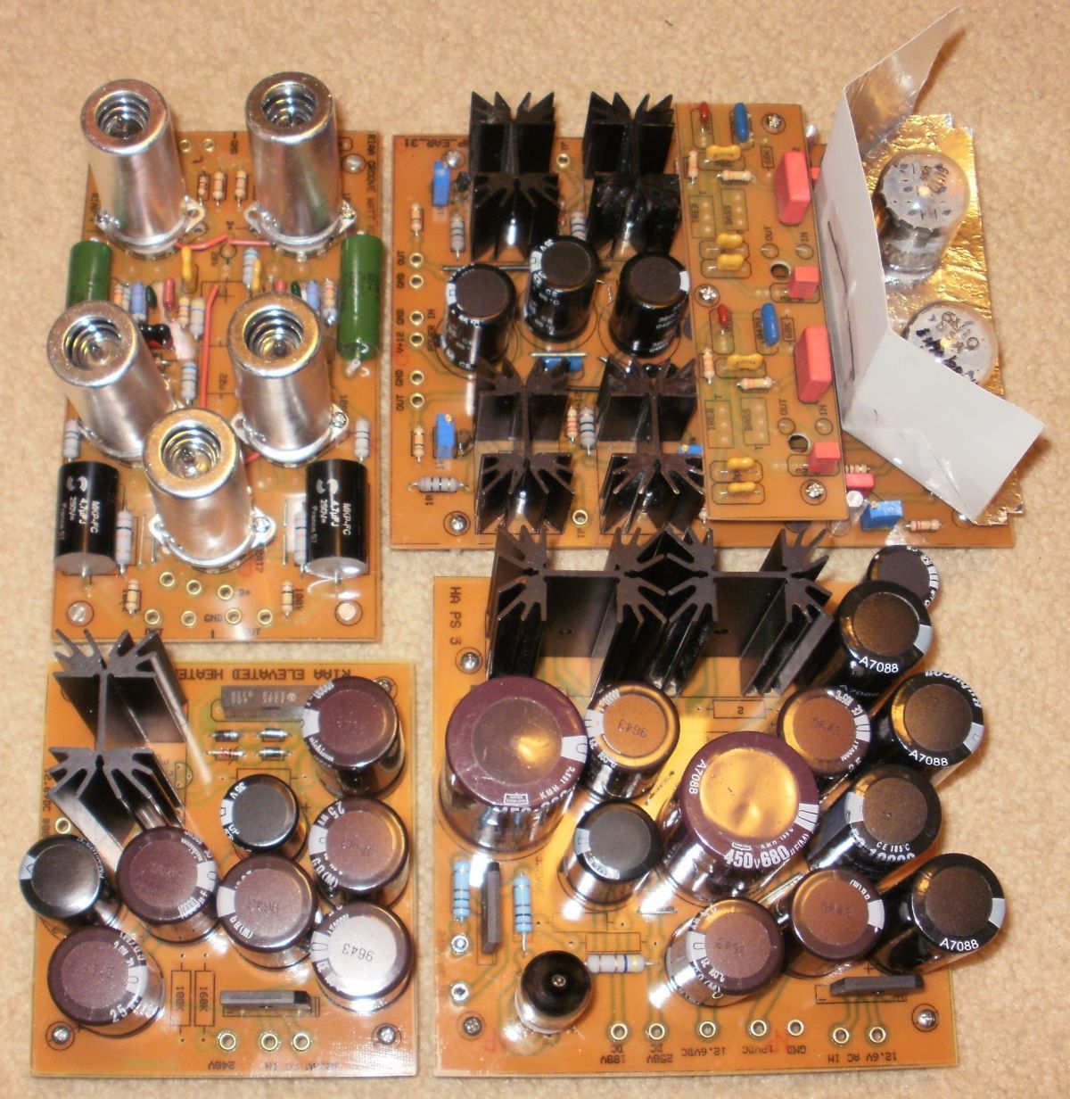

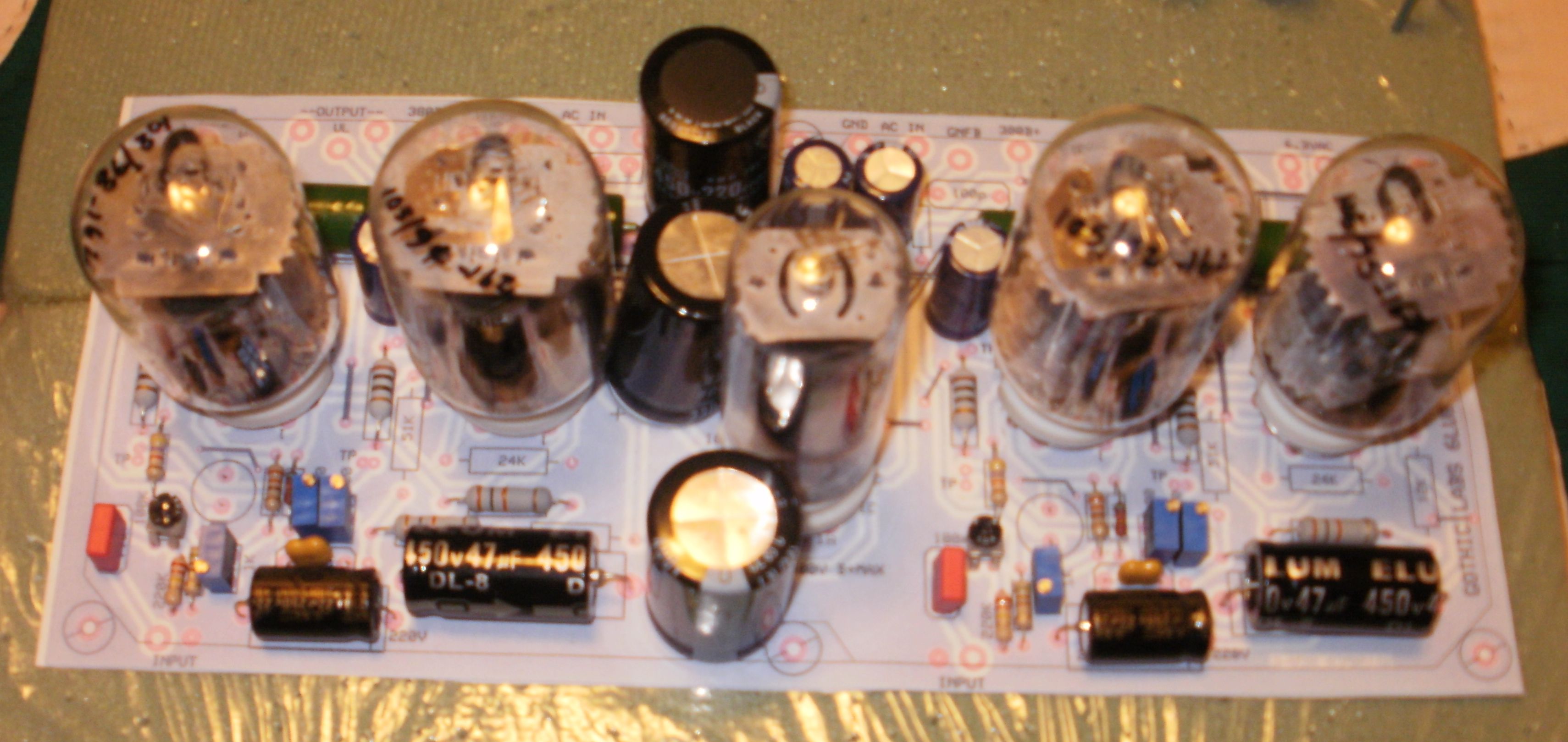

I have done 2 amps with all in one with PCB's (EZ10 and EZ260 search) I have also built and rebuilt a few Dynaco's that are hybrids. Some people like the vintage look of PP wiring and some don't care as long as it sounds good.
The cost of the one off PCB's can be more expensive as well as more difficult to fix errors if you make one that is parts placement or track placement oriented, i.e. routing filament too close to something etc. Toss in thicker PCB or High Temp material and it's nutty.
On the flip side assembly is very quick and makes for a tidy project if others want to build the same thing.
I have been lucky on the 2 PCB's that I made, each had only one easy to fix glitch.
I think one challenge is fitting components in a 2D space while keeping things small and traces where they should be, but hey that's also some of the fun part!

IF you have mastered the toner transfer method of PCB's they are simple and easy to fab. You must be wise in layout to prevent cross talk/unwanted feedback, and parasitic capacitance or inductance from interfering with the design intent. Tube PCB's are much easier than bipolar IC designs where you must also consider monolithic thermal feedback into the design as well.
I use the green floral foam to pre-stuff a paper layout of the amp to verify correct component spacings after I've started to scrounge the components. I cannot mount the caps to the back side on paper, but their mounting requirements can be verified.

This is very interesting!
I am all for point to point over a badly designed PCB. You have hum pickup, you move the resistor a little to the side. Try doing that on a PCB.
Nice!SemperFi said:here are some shots done on the analyzer of a 390uF/450V electrolytic with and without 5inch wires.
