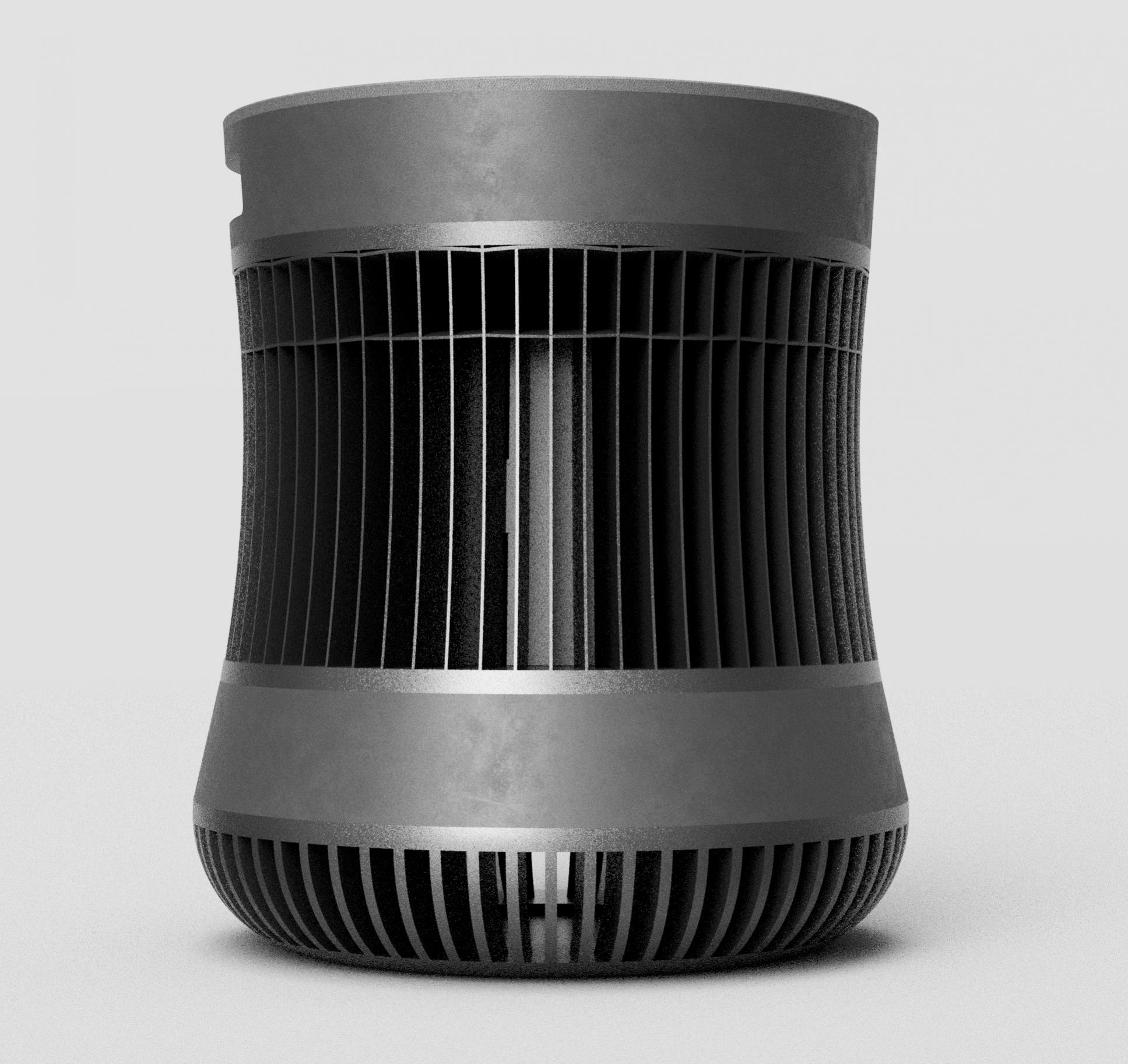

Point source omnidirectional speaker.
Platinium Air pulse 3.1

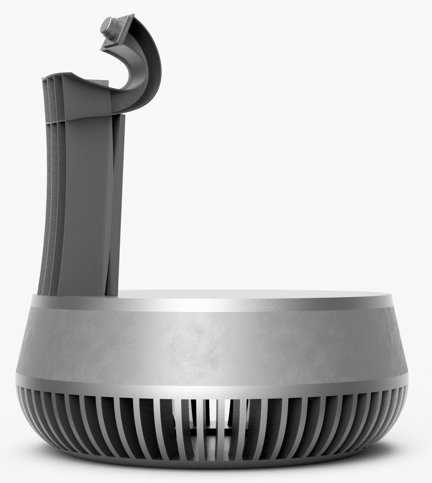

@mattstat, . . . I'm doing some more reading but would like to know more on your concerns you pointed out.
My concerns are mostly about how the sound is going to combine from your 16 slices. Depending on the dispersion and acoustic center of each segment at each frequency you may wind up with variable lobing.
But, with so many sources, it may also average out and not be a problem.
Or still be greatly improved compared to the lobing you previously experienced. Ultimately my worry may be more of a theoretical issue than a practical one.
It’s a magnificent built. However, not a commercially successful product.
Wow, it is very close to what I am attempting with the segmented horns, but they use a centrally mounted driver whereas I am attempting to design with multiple folded horns.
Any idea on the performance of the Platinium Air pulse 3.1. I'l. see if googling helps me. But looks awesome.
