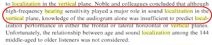

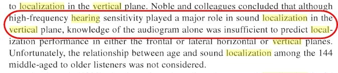

Not insensitive, but poor, more poor than horizontally. Vertical localization happens by analyzing reflections in the ear's pinna, which means it happens only with high frequencies (>4000Hz), but still this is not a totally solved question.
Most hearing tests are done with simple test signals or speech. Music is always multitonal and even a single instruments's sound often covers several octaves of harmonics that give the timbre. A kick drum or organ's pedal notes are examples of "pure bass sound" in music. So this "vertical localization in small rooms" is a very difficult question. Visual information helps hearing a lot, and when we see a large speaker with the woofer down low, that sets some guidelines to our brains!
Google - hearing localization vertical
