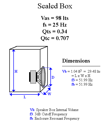

Thanks ! I’m trying some of the online box calculators and they are giving me the volume but not the dimensions.
Square dimension boxes are supposed to be the worst in theory, yet i see all these subwoofer enclosures which are roughly square
Boxes with a dimension ratio of 0.6:1:1.6 are better
Seems to be something to do with standing waves, minimizing something about the air pressure bouncing around inside the enclosure. What should I use on the internal walls of the speaker enclosure to address that. I can staple some of that white wadding stuff on, or is there anything better

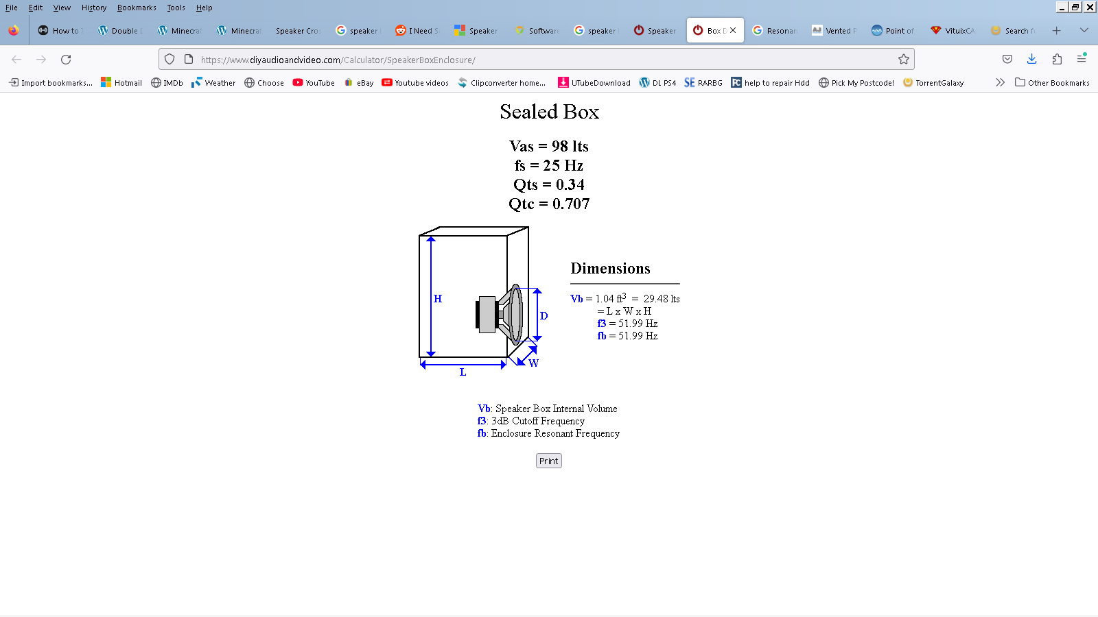

Thanks ! I've see a pair of seas w22ex001 e0022, price is going at £200 ONO for a pair
What do you think, are these good drivers
Seem to work well in a one cubic foot enclosure according to online box calxulator

An interesting woofer, at a sensible second hand price, if you can afford that.
Probably not the most sensible choice for a first design, but with help from the community it could be made to work, but at the same time I think it would need a robust and therefore a more expensive tweeter to make a two way design.
Expect to be possibly below 2KHz for a suitable Xover and the resonance peak of the bass cone at 7-8KHz will need some extra care and more Xover components to notch it out.
Just out of interest, your first post mentioned both Seas and Visaton drivers you aren't thinking of their full range devices are you ? Maybe have a quick look in the full range forum to see if there is anything of interest there.
You now have a candidate woofer in a 28Litre box, you now need to pick a tweeter that can be used down low or a full range unit crossed in the 300-800Hz region. Possibly a FAST design like that would help suppress the woofer breakup peak enough for it to not be a concern. However a low Xover point will definitely need larger inductor and capacitor for the woofer. Have a read here:
