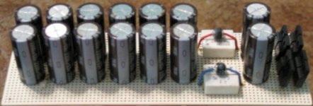

Got the new little CRC power supply done!
It has 2200u first caps, and the tank/reservoir section is 6x2200u per rail. The CRC resistor value is 0.3R and diode bypassed to prevent sag. The dual bridge rectifier is Fairchild Stealth. It has 2.2K drainers at first caps locale. It has orange LED indicators for each rail, near the output side. That board is 2-5/8" x 8" size.

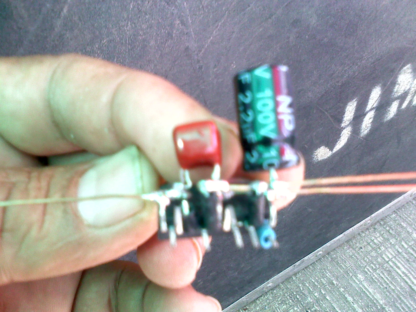

Hi there Mr Daniel. this past days a friend came with a 8¨+tweeter active speaker;
it was a discrete amp about 50W, it was so burnt with a big hole thru the board.
So with the same psu as original, put in a 3886GC this i had it almost finished ( less
PS) so just try it! Maybe not sogood design its almost the same at M Feuerbacher
site.Tried it and sounded good,think it needs tweaking, but my friend just loved it and as he needed for playing, just took it like that.
Now reading thru your postings, i´m aware now that maybe the 7293 bridged conf. that i was considering, now i see what your answer was; the ps xformer is the limiting factor,
so i´ll try with a single chip, and go for your first post schem.
my xfrmr is center tapped, good quality , dual bridges cannot be used? trying to find out.
Well enough, have some duties before solder time.Parallel chips dont increase output
cause its an 8 ohm spkr. right? maybe just to make it more reliable? what would you suggest?
Anyway i think i´ll settle with 68k-2k7-220u for the feedback circuit i has a preamp and equalizer integrated at the input board.
Ok thanks for all your attention and time to answer our postings.
Martin Martinnez
Uruapan Michoacan
Parallel chips dont increase output cause its an 8 ohm spkr. right?
No, this is not a discrete amplifier.
The theory is correct, except for chip amplifier limiter engagement point of about 45 watts, whereupon the LM3886 will begin screeching an internal hard clipper or TDA7294 will omit the bass via internal soft limiter and in either case, it becomes more difficult to hear bass when you turn it up past about 45 watts or so. The limiter influence is either mild or inactive until you turn it up and wonder why it isn't as good as a discrete amp.
With your transformer, a PARALLEL chip amp and an 8 ohm speaker, the on-chip limiter (45W+45W=90W) can't interfere with your 70W application. Each chip sees half of 70W, 35W apiece and then on-chip limiters never switch on.
So, I have to report that the Parallel TDA7294S/TDA7293 Master/Slave configuration is ready to use and fits your application. This is the easiest parallel chip amp possible. I will be using it to upgrade my receiver as soon as the LM3886's are removed.

Martin Martinez asked about a chip amplifier to use for one 8 ohm speaker and he has a 25+25vac transformer of 125VA. On the list above, there are three linear amplifier options, #4 is overly complex, #5 doesn't work with his transformer voltage, so #6, parallel output devices is the logical choice.

They usually sound nicer and louder, and more abuse withstanding. so its gonna be parallel 7293, p2p, and still deciding the feedback string
http://www.diyaudio.com/forums/chip...r-slave-style-no-lossy-emitter-resistors.html <--click there 😀
I've described it (with the new values) in that parallel amp thread at Post#1, but did not have time to make a new schematic. If you can go by the description to get the part values, the operating voltage is same as yours and should make same results, a storm of hi-fi.

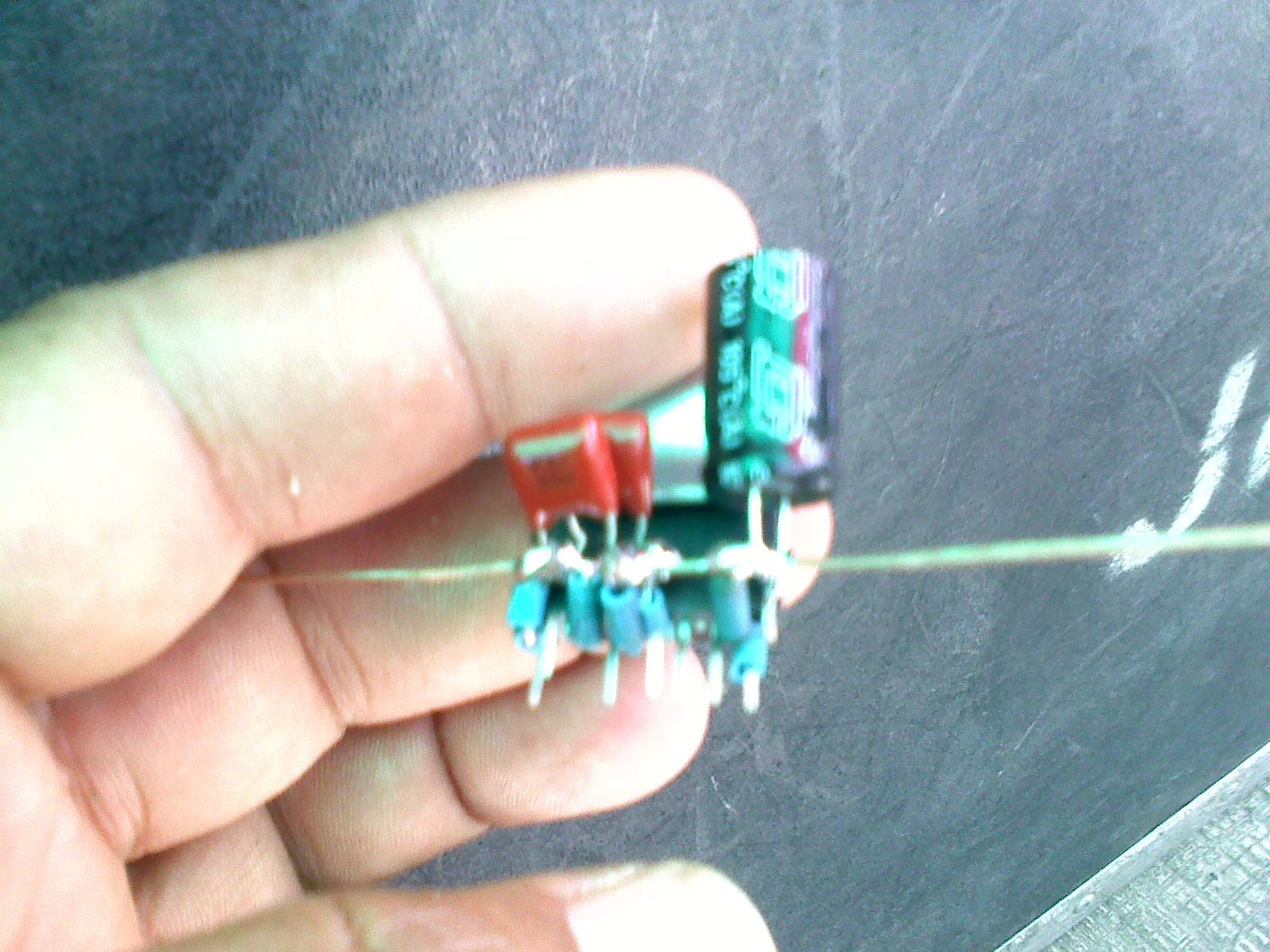

Recipe for TDA7294 "mids&treble" amplifier:
120k feedback resistor, but 2k7 resistor series to 500R trimmer for feedback-shunt resistor. Cap sizes at small signal, is 220u+1u electrolytics for nfb-shunt cap, and the input cap is not larger than 0.47uF (preferably smaller). Speaker negative has a series capacitor not larger than 330uF (preferably smaller). And, due to reduced bass current, the amplifier can be run easily from regulators for high quality sound. This Mids&Treble amplifier does quite well at amplifying the little higher pitched audio signals to huge proportions for much amazement. Each chip can drive an array of midranges and tweeters. You'd need very powerful bass amplifiers just to keep up with it--about 500W to 1 kilowatt Class D to a woofer with a passive crossover may be enough, but that depends on speaker efficiencies.

Does it need compensation if i use RC filter: c in series with +,
R series w -, at the tweeter?
i use something like 4x series-parallel 2,2uf and 1x 15-20W, 15-52 ohm.
Does it need compensation if. . .
It doesn't need external compensation added when:
1). There's good amplifier power layout (not all boards meet that criteria)
2). When run at a gain of in the neighborhood of approximately 38X*
*Both voltage and layout can change that gain factor.

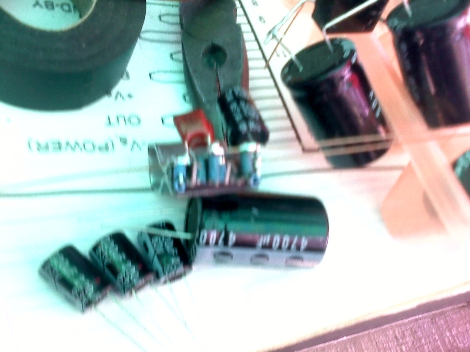

then maybe is enough with
what is already in the circuit.
need to check for temperature.
well this pair is 2x 75k-2,7k-220uf
noninverting so 29x gain, right?
and the rest goes by your schematic.
It´s gonna be bridged with the
25-0-25 xfrmer and 4x4700uf.
(local 2x220uf on each chip).
as soon as i get back will
finish and test it.
Martin, that's my older schematic and designed for under-volting. I did not realize at the time that it was the low voltage that made for good tone despite low gain. If you have some trouble with the tone, replace the 75k with 100k and it should be really very merry (at exactly 38X).
