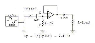

Plz check these buffers, actually i like the one posted. Plz recommend me a good buffer.

May be I just need a simple buffer like one of these.
That sort of buffer is unlikely to be needed. Except for acting like a wire, it puts in noise and degrades audio resolution. I'm sure you'd prefer an ordinary wire instead of that thing.
