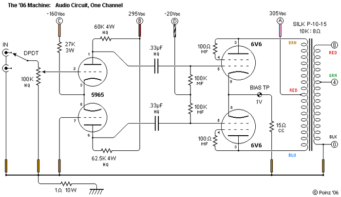

I'd be most grateful if anybody here could provide a copy of the 5AR4 power supply schematic for Poindexter's Musical Machine. The web is rife with the sand version, but the "new and improved" schematic seems to be lost to the sands of time (and yes, I've already searched this forum). The Wayback Machine has numerous references to his old site, but many of the schematics are missing - including that one.
And while I'm thinking of it: was there ever a specific schematic for the 6V6/6GK5 version of the MM, or was the builder just supposed to take the 6GK5 stage from the EL34 PP schematic?

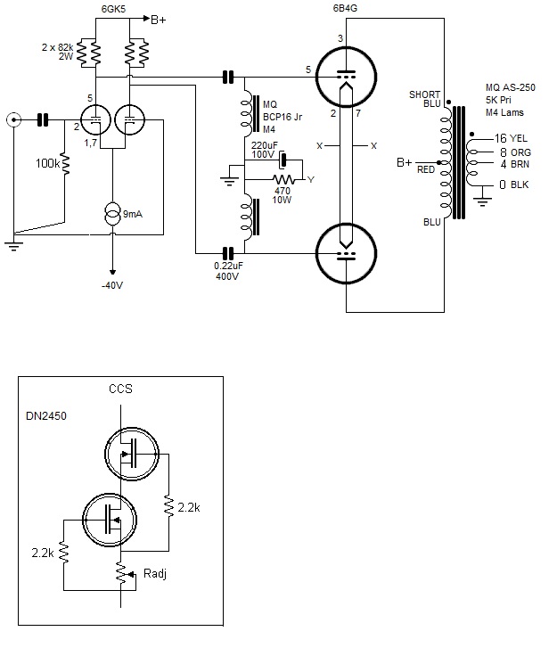

There are newer versions of the MM circuit, specifically using 6GK5 as the long tailpair and including a CCS as the tail load. I built this one on a breadboard a few years ago and it sounds really nice.
https://www.diyaudio.com/forums/tubes-valves/149211-6v6-music-machine-build-help.html#post1904511
There are also versions using EL34 and 2A3 output tubes. I built mine with 6B4G which is a 2A3 relative.

Could you point me to the 2A3/6B4 version? I'm curious.
Thanks,
Jim
Here are a few links:
an early DIYaudio discussion: New project; Musical Machine

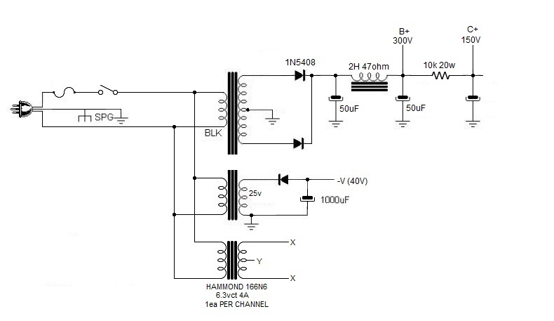

You should be able to adapt the triode 6V6 version for 6B4G or 2A3 with the addition of an appropriate filament transformer for each channel. I dropped the B+ on mine to 300V. Can't find the official 6B4/2A3 version right now.
Am attaching my schematics. You don't need the grid chokes on the output stage. Just use an appropriate grid resistor based on 6B4 or 2A3 data sheets or maybe the 6V6 original schematic.
