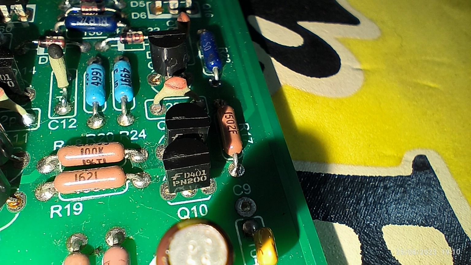

I imagine something like bc546c and it's partner might work, noise is low, buy large quantities and get good matches, we had this subject up in the bryston 4bsst clone thread,
Probably, but pinout is reversed compared to the PNs and Onsemi has obsoleted the C-version of the BC556 so it is much harder to get them and be sure of their provenance.
What a shame they stopped production, how about some of the lower volt bc transistors, bc550/60Ctheir noise floor is even lower and looks like mouse has them, I'm aware about pin configuration, but it seems you just have to mount them reversed
Available pn100a/ pn200a

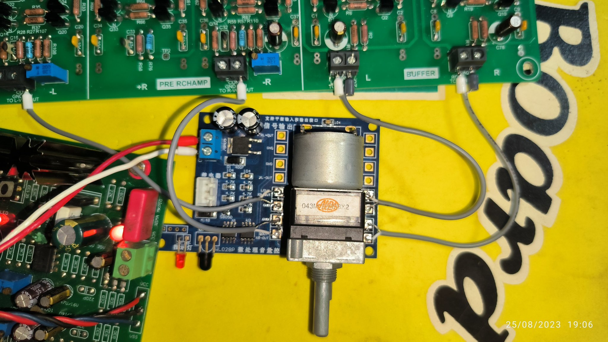

I used this for remote control: (DIY kit) Remote volume control kit + Aluminum remote control | eBay
Placed it in the psu section to avoid digital noise interference.

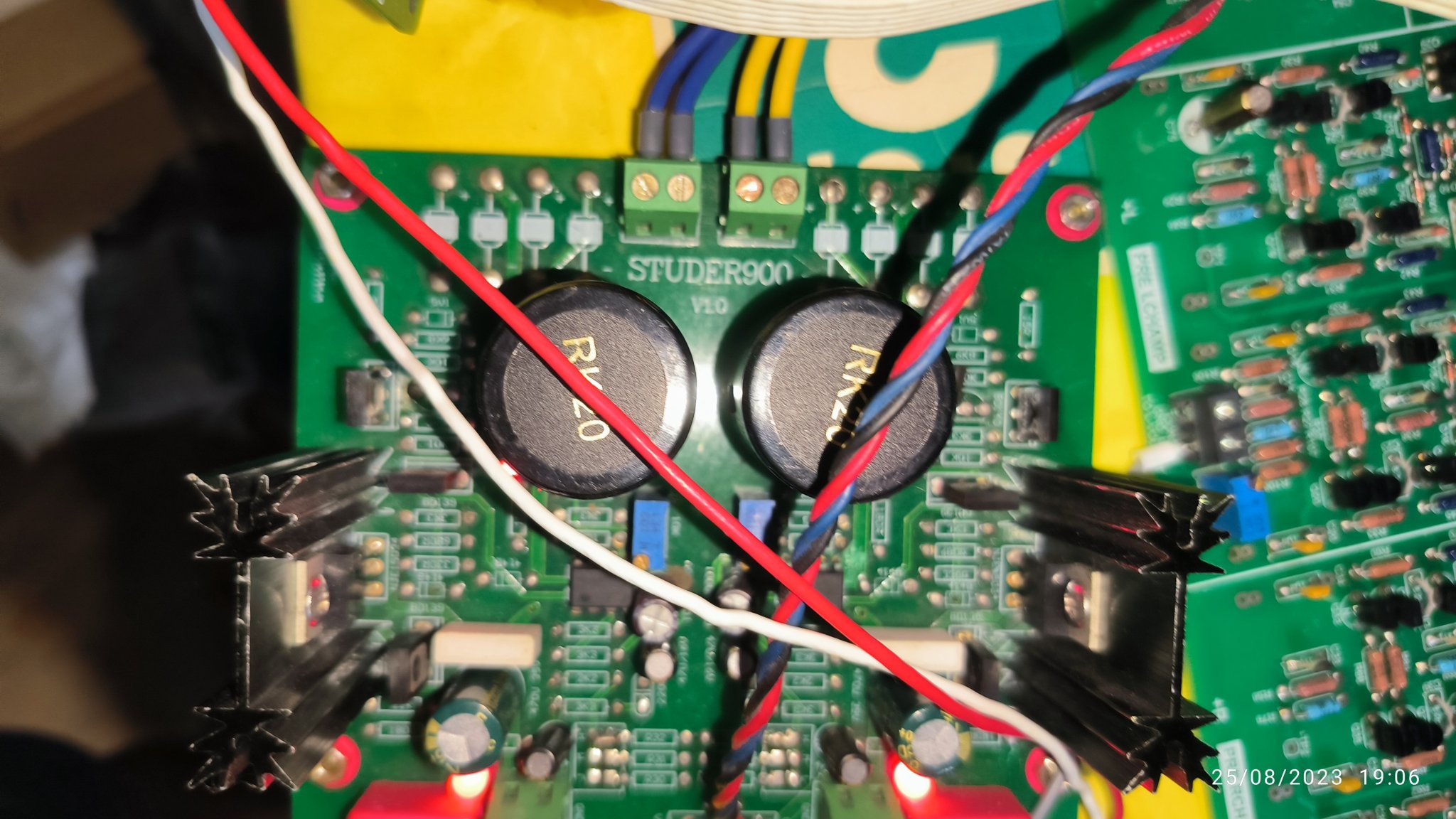

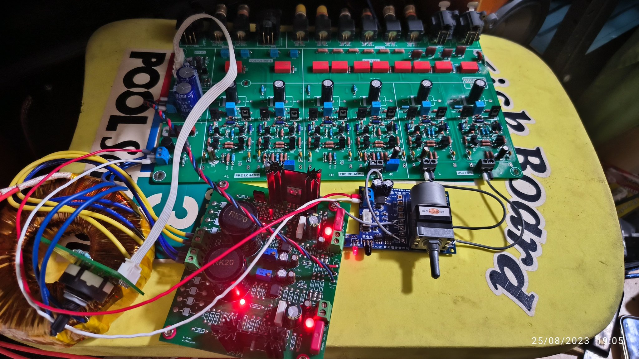

I finally got around to wiring these together. I had to add an extra winding to the transformer for the relay section and also for the remote volume control. Can't recall where I got the transistors from. The Studer PSU is very nice. I completed a chinese discrete BP26 PSU but I'll be sticking to this PSU. An alloy chassis is on the way from China. Normally I'd use local casings of thin sheets but the SQ of this board demands a decent case.
rough512 Impressive build. I am actually doing my own right now. After assembling all elements I see +24V DC is dropping to +19V, so probably I got a stort circuit somewhere. I see the output is short circuited (L and R channel) - it shouldn't be like that. I am searching for the suspicious elements.
