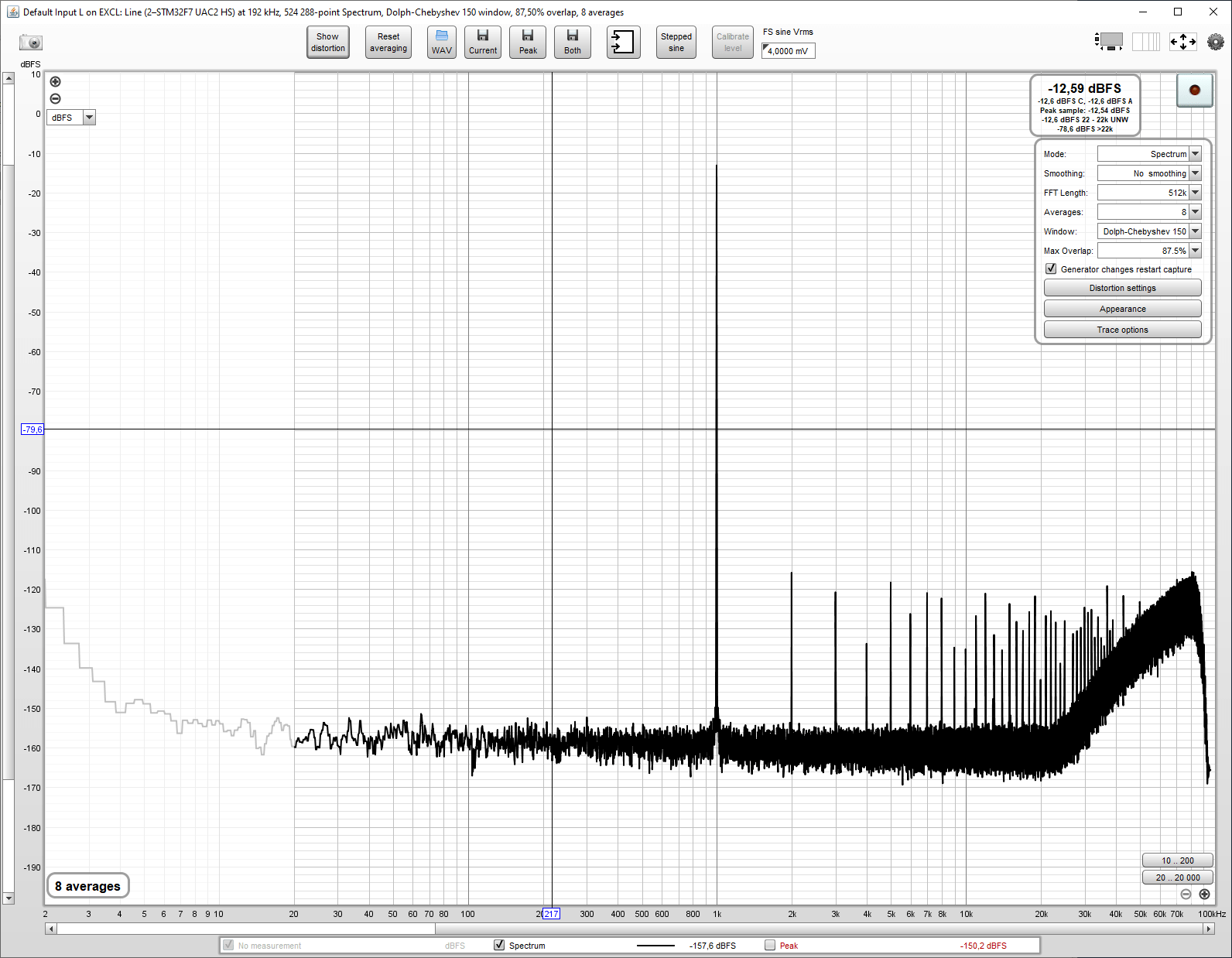

I made some measurements to see how the dither modes work. I used the same PCM1702+PMD100 DAC as in here.
This is the dither setting (mode 0) available in PMD100 stand-alone mode.
Quite a lot of "grass" but at levels that are probably not audible.

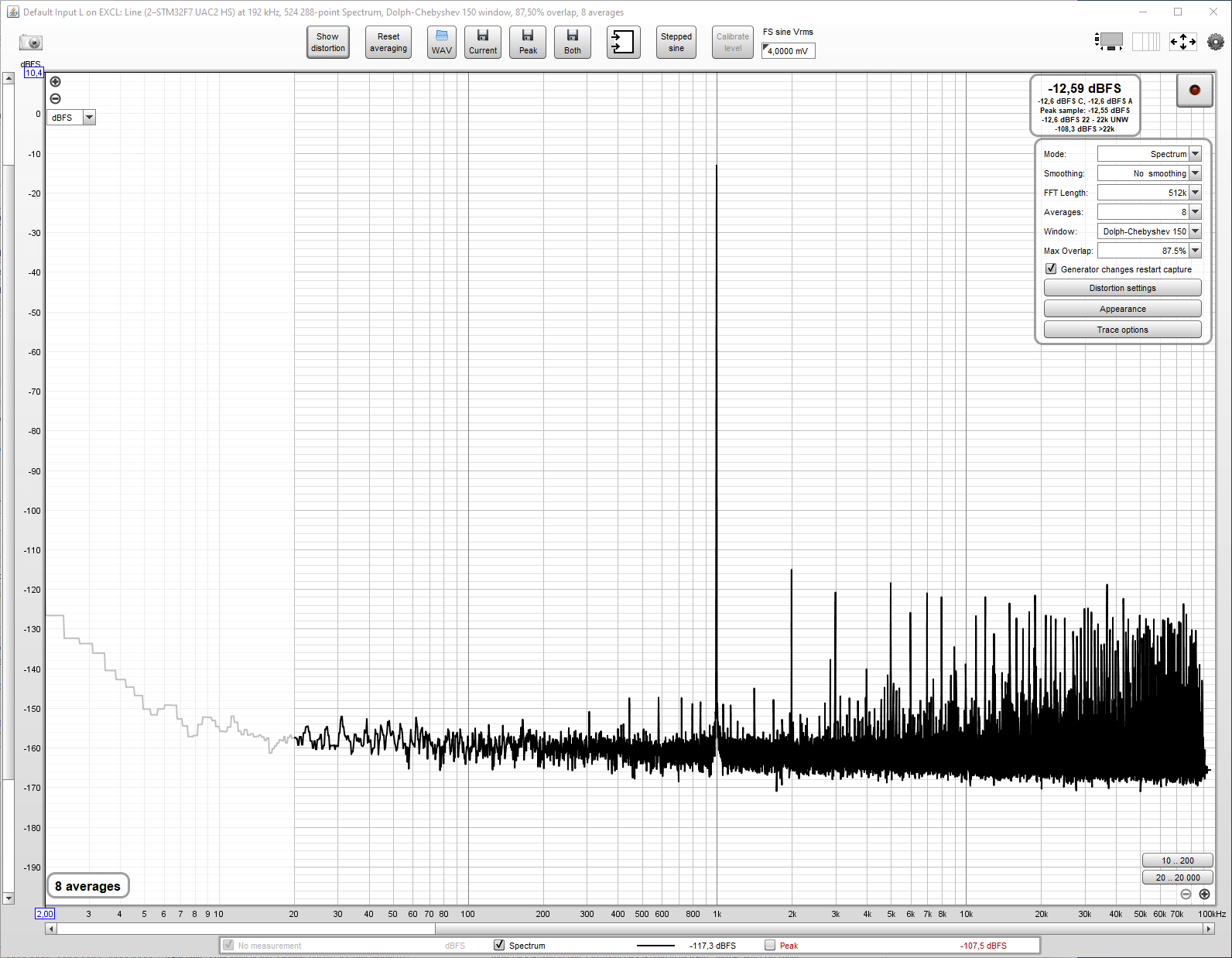

Here is the dither mode 6 which according to datasheet should work well with multi-bit dacs.
Most of the "grass" is gone.
It's effectively turning small signal data into pseudo-small signals and makes the DAC rely on its thermometer segment so it's a form of feedforward (opposed to sigma-delta). Didn't help with MSB nonlinearity expectably (scrambling, DEM does that).
