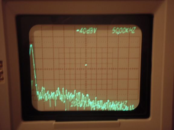

I'm running in sw mode and can switch between the various modes. I cannot recall that i've heard a difference too. Depends on the rest of the chain, including my ears.
But i could measure a difference.
Witout dither.
With max dither, same settings on the 7L5.
centre of the screen is 50kHz and it's 10kHz per division.
So you see 0 to 100kHz. Peek at 0 kHz is not there in real live, comes from the SA.
Top is at -40dB and it's 10dB per division. So -40 to -120dB on the screen. But don't think this thing is calibrated after decades.....
But you can clearly see the difference: Much more noise outside the audio band, but a few dB less within the audio band.
