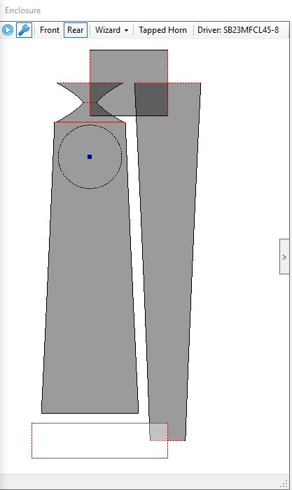

Been playing around with Leonardo's TL calculator and a model of an OB1.
I have modelled a SB 23MFCL45-8 (8" mid range £ woofer/subwoofer) with the same geometry as the OB1 (as close as I could guess from various internet pictures) including the inclusion of a reduction due to the Mid driver enclosure. And the results look pretty good if you heavily (?) pack the TL out with stuffing at between 5 and 9 Kg/m^3 (0.3-0.56 lb/ft^3) to get rid of the higher frequency wrinkles (is this stuffing possible/appropriate?). I have added a 380hz 24db/octave low pass as per the OB1. This give a s nice f3 of 24hz and a f10 of 20hz.
Here is a screen shot of the TL calculator input/output and the SB data sheet. Can anyone verify that I have done this right - TL is 2.33m long and starts at 500cm^2 reduced to 150cm^2 at the mid driver (5" tube) and back up to 350cm^2 and finally down to 200 cm^2 at the exit. 22cm wide box give a volume of 73litres. I did re-organise this to be in the same orientation as the speaker but it made very little difference to the response.

Hi Ugg10
I've tried to reproduce your setting but I'm not sure if I understood enclosure dimensions.
Btw why did you use geometry reduction near the speaker? Is it used in PMC design? Can you send your Leonardo file just to load and check?

The reduction in area is to model the mid driver enclosure in the OB1 that cuts through the transmission line. This is a plastic closed tube. if you play around with the model it does not make a lot of difference. PMC seem to use the Driver being art way up the TL to reduced the ripples in the upper bass.
Image here - OB1のカットモデル: koulog
Approx dimensions can be seen here - Zaph ZDT3.5 in ATL config
I have tried to attach the Leonardo file, let me know if you can read it. You will need to change the extension from .txt to .tlp before using it the software.

I've loaded finally in my idiotic windows10. Seems that reduction doesn't cause any change. I think you can remove it. Then try to delete all stuffing and move driver little bit right. You will see that first ripple almost gone. After that add stuffing. Yesterday I first time loaded this sw Leonard so I don't have much experience. If you want to be sure ask MJKing he is expert for TL.
Thanks, issue with moving the driver right (upwards in the actual speaker) is that is where the mid driver in the OB1 sits. If I were going to make this I would like to keep it a three way with the mid close to the tweeter. Here is a picture of the same model but folded in actual position with the front of the speaker on the left i.e. as in the OB1 with the TL exit as a front port and the mid driver where the reduction in cross section is.
I think you can remove reduction just to not produce confusion. It looks fine and SPL is perfect from 30Hz until almost 300Hz. Actually stuffing most dictate SPL curve regarding ripple reduction. I don't have experience if it is possible to put so much. This is much more than heavy in Leonard sw.

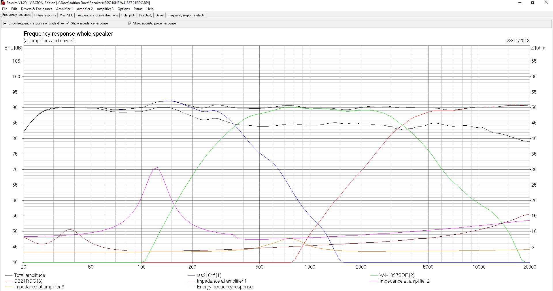

A very quick sim using Boxsim for the RS210HF-4 plus w4-1337 and SB21RDC using active filters at 24db (4th order) and then adjusting the gain in a 65l box tuned to 25hz give a pretty decent first stab (approximates the TL). Note that the tweeter and mid will need significant pads to reduced to woofer level. Will have a go at a passive crossover at some point but looks promising and points towards a true 20hz to 20khz box.
A very quick sim using Boxsim for the RS210HF-4 plus w4-1337 and SB21RDC using active filters at 24db (4th order) ... looks promising and points towards a true 20hz to 20khz box.
