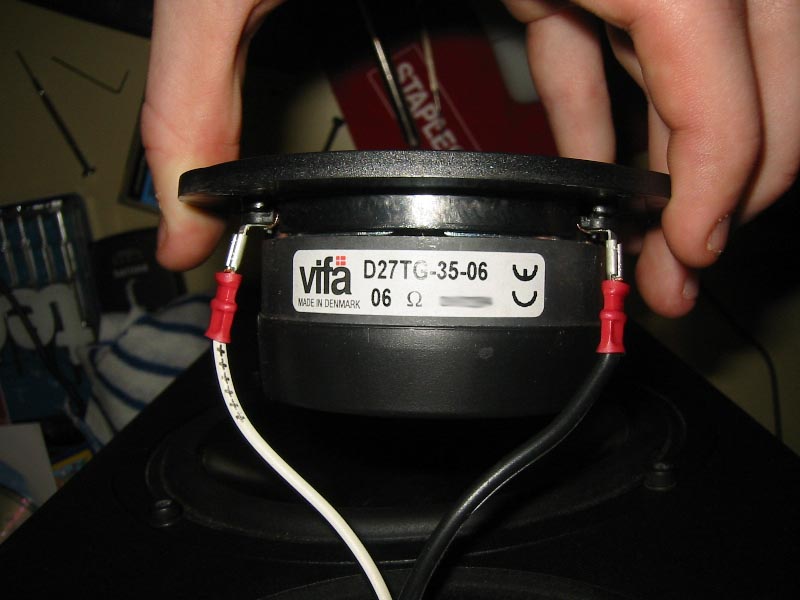

What is the BB5 Tweeter?
Anyone know which Vifa tweeter is used in the BB5? Presumably different in the BB5 SE?
Thanks 🙂

BB5 - Audax TW34XP
BB5SE - Seas 27TFFC
Both might well be some kind of oem versions.

I was in a mastering studio last week, it had a nice BB5XB system. The tweeters looked like the ones used in the PMC AML1, with that perforated grille on top of their dome (the "Acoustic Radiator" as they call it.) Or is that the oem part of what you said? ==> see photo attached here
Cheers

AML1 uses the same Audax tweeter.
Yes, the waveguide and the diffusor are imho oem parts.
