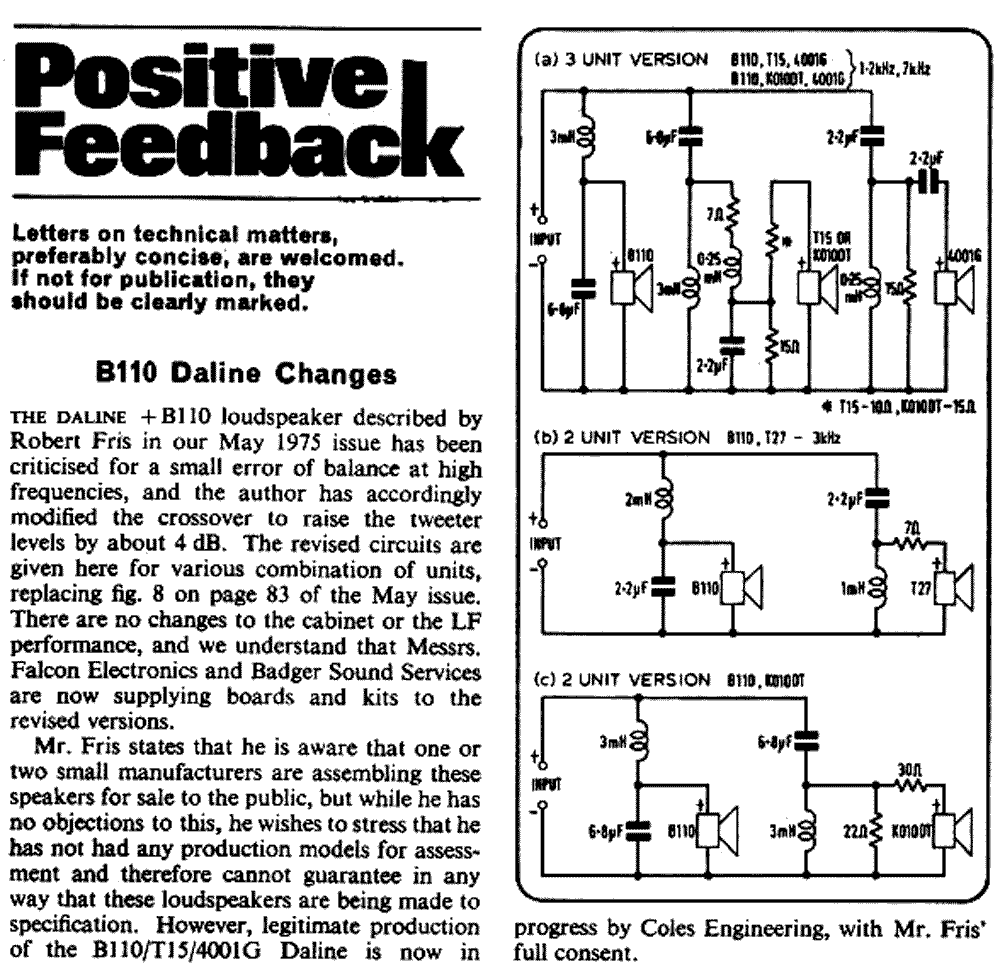

Two articles i made into 1 pdf. http://p10hifi.net/TLS/downloads/DalineB110.pdf
I also have files on my HD that say "Daline-revised-crossover.gif” and another that is a text doc “Fris Daline modification". I have attached those.

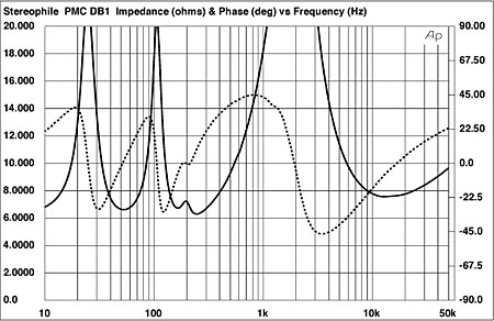

Pardon? Is somebody honestly saying that link 'proves' Dacron does not have a damping effect? That's a cracker. I like that. One of the least effective attempts at a disingenuous example I've seen on the subject for months. Well done indeed. :rolleyes:
That line was not designed to be a maximally flat impedance design. Ergo, it does not exhibit those traits. That does not demonstrate dacron does not have a damping effect or impact upon impedance curves (which is such utter drivel I'm struggling to comprehend how anybody thought they could get away with stating it: for example, see pages 4 - 7: http://www.quarter-wave.com/TLs/Damping_Coefficient.pdf & there are plenty more out there from many sources). It simply shows that the speaker you have selected to misrepresent the subject was not designed for that purpose.
Bullock knew what Bradbury used perfectly well, and his model used those equations, while his measurements were taken of test enclosures using the materials originally specified (long hair wool and fiberglass). They failed to correlate well. Nor has anybody else been able to match measured results to Bradbury's equations with a high degree of accuracy, whereas other methodologies show measurements matching predictions very well, a fact you have anxiously avoided.

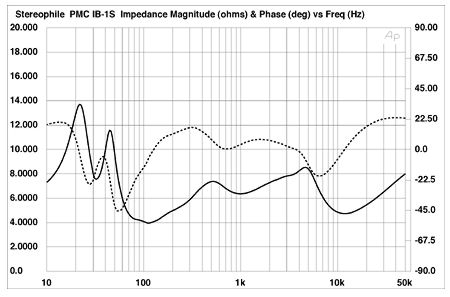

I am glad you hold up PMC as an example of transmission lines with an unreactive impedance curve though. Here are independent measurements (from Stereophile) of the impedance curve of two of their products, the DB1i and IB1S, both exhibiting an LF double-saddle peak in the impedance magnitude trace; a point John Atkinson specifically commented on re the latter, even describing it as 'typical of a bass reflex design'. PMC IB-1S loudspeaker Measurements | Stereophile.com
