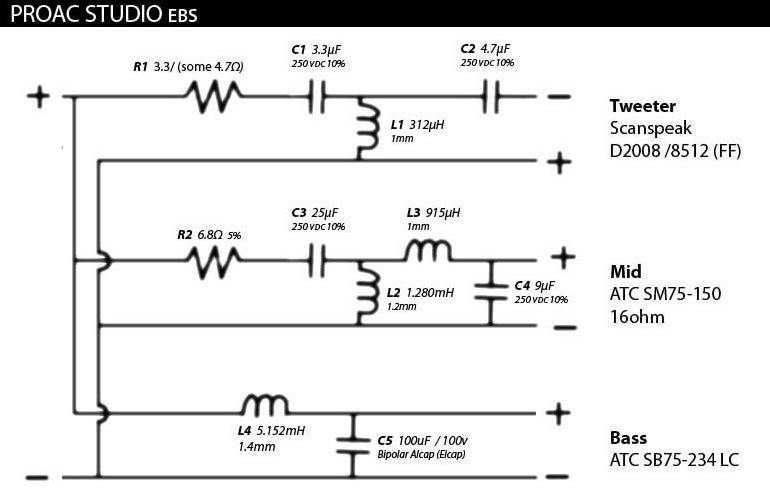

We did a huge and largely pointless thread on the similar Wilmslow Audio Prestige.
FLOOR-STANDING Loudspeakers
It's actually a difficult speaker. But uses 12" Volt bass and 3" Volt dome mid. 750Hz and 3kHz XO, I'd guess.
I have a typical circuit from that thread below. It actually modelled horribly. The dome mid doesn't play nicely with the bass slopes on simple filter. I'd never be tempted by a speaker of this type given a regular cone mid or two works so well.
Ah, we are unlocked again.
Indeed the curcuit design using the VM752 mid was way out in my view, the WM752 unit needs 3rd or 4th order electrical slopes as a minimum. The ATC mid used in the schematic you posted is a completely different unit in all respects. I will revisit the thread for reference only.
