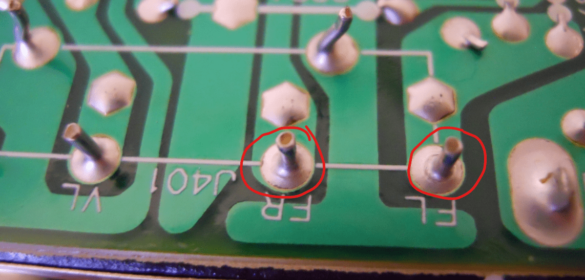

Two things come to mind here. No sound that appears as you turn the volume up can be a symptom of tarnished speaker relay contacts. Its a common problem across many makes and models. A an insulating layer build up on the contacts and as you turn the volume up (so more voltage present at the output) it breaks through this layer and then works OK till the next time. If the relay can be opened then they can be cleaned.
That said it is unusual to have both channels faulty together but it could happen.
Perhaps as or even more likely is a poor solder joint some where, possibly even around the relay or around the input sockets or volume control. Only a careful visual inspection would locate that unless you could perform tests in the faulty state such as looking with an oscilloscope where the signal disappears.
Faulty joints look like this where you can see a ring of cracked solder:

Thanks. Give it all a good visual inspection first. A few gentle taps and prodding with an insulated stick (pen or something) can sometimes reveal poor joints. Normally poor joints are on components and parts that are perhaps not machine fitted to the board such as sockets, controls, transistors on heatsinks and that kind of thing. Look them all over.
