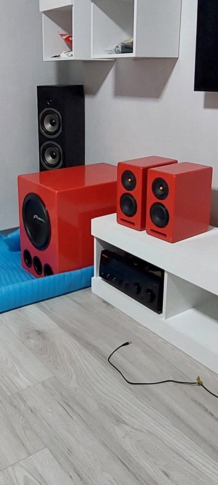

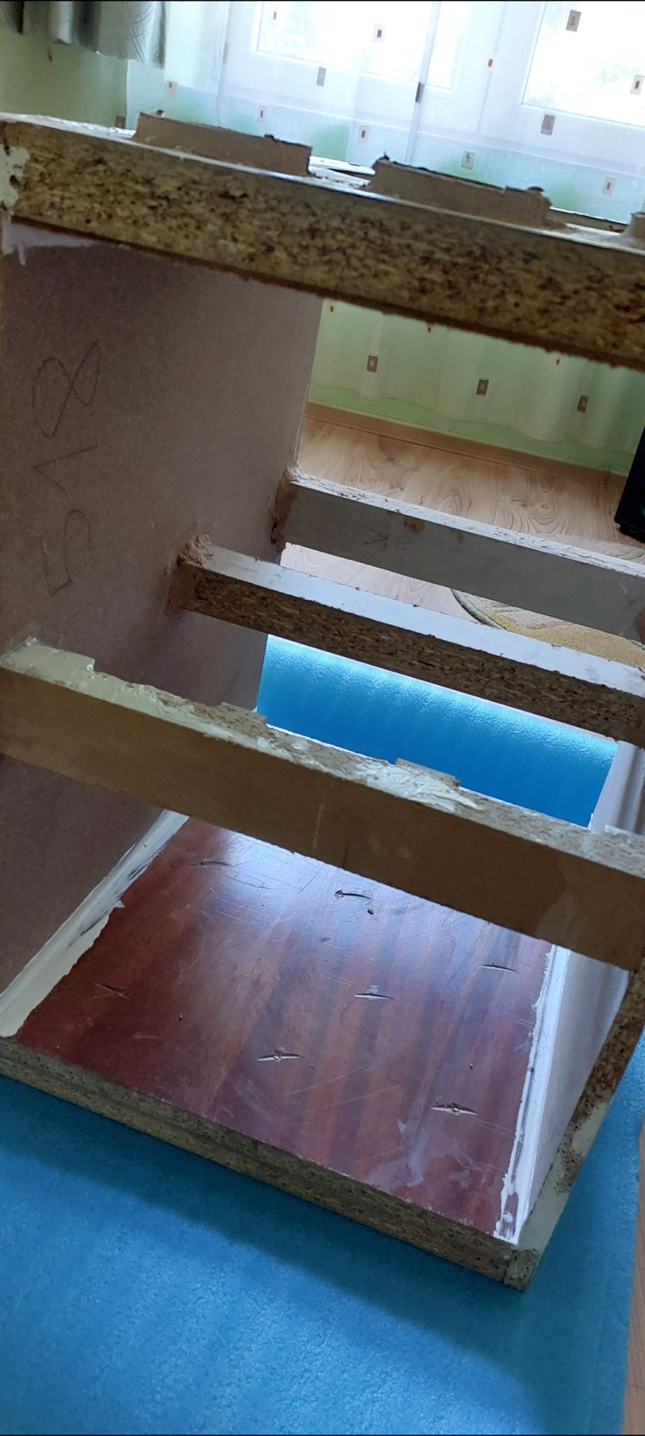

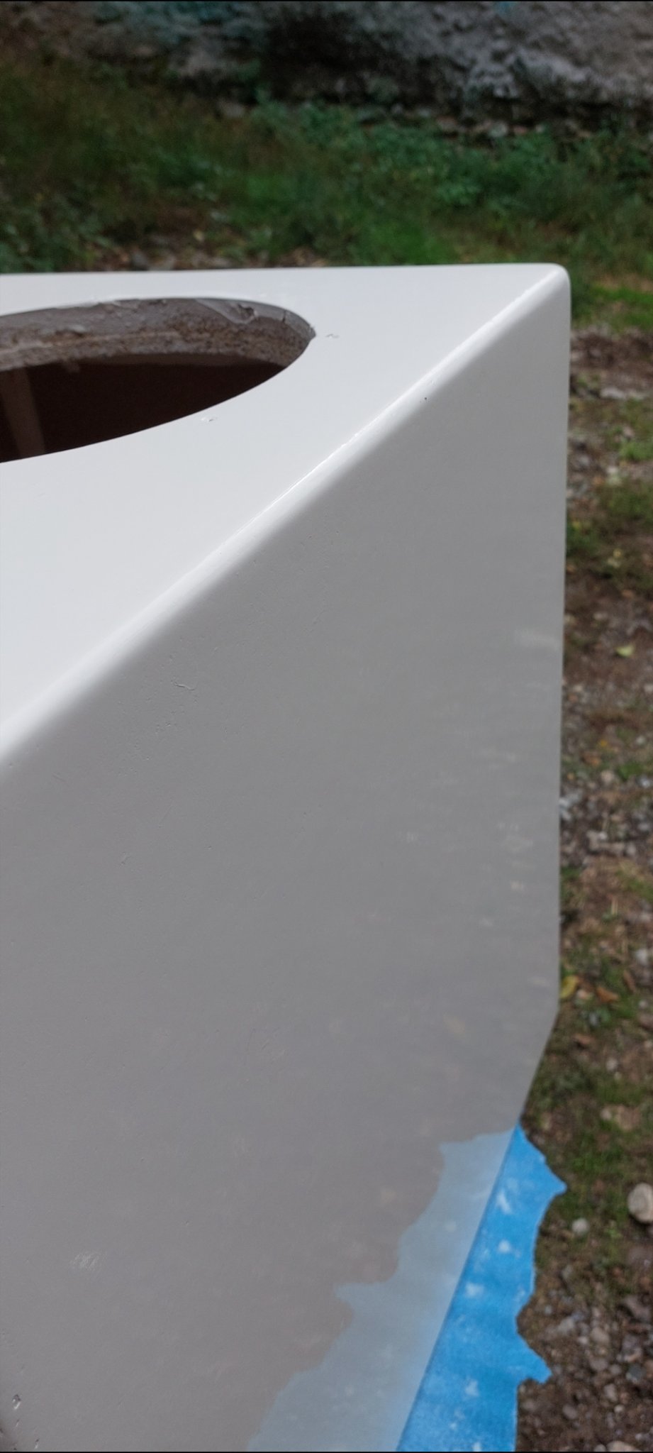

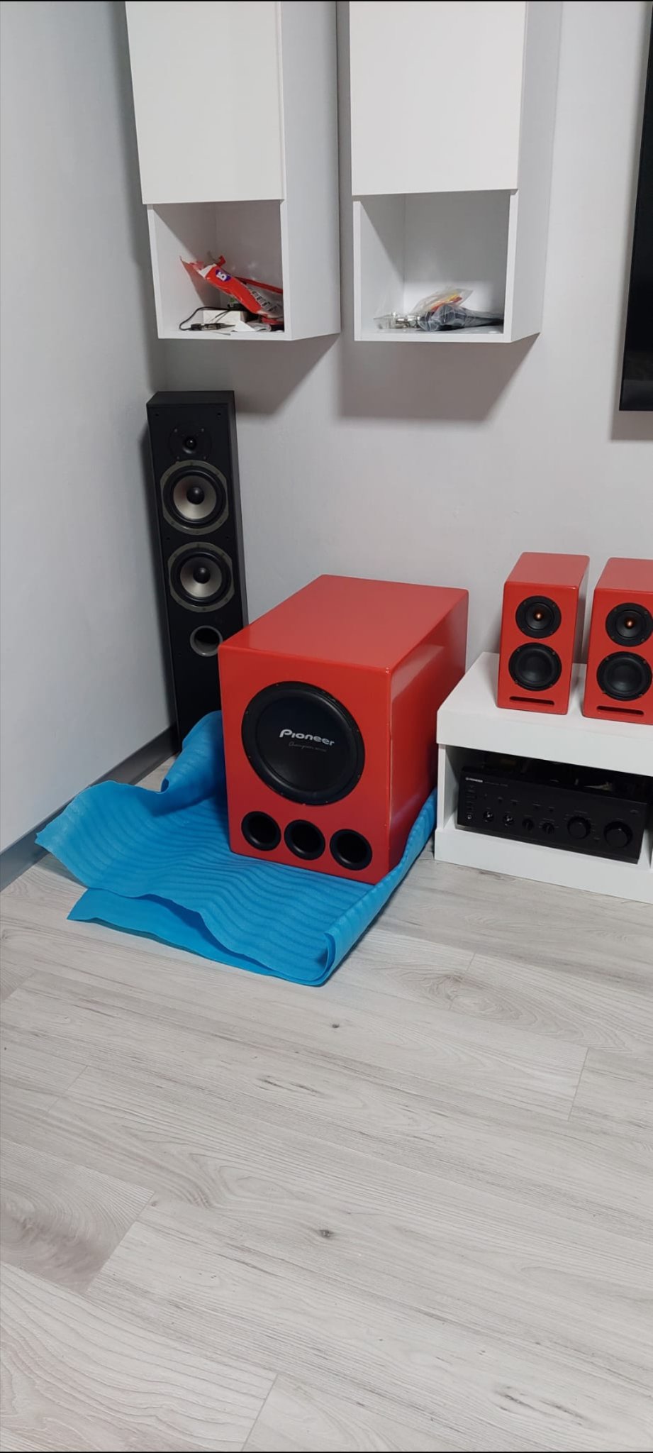

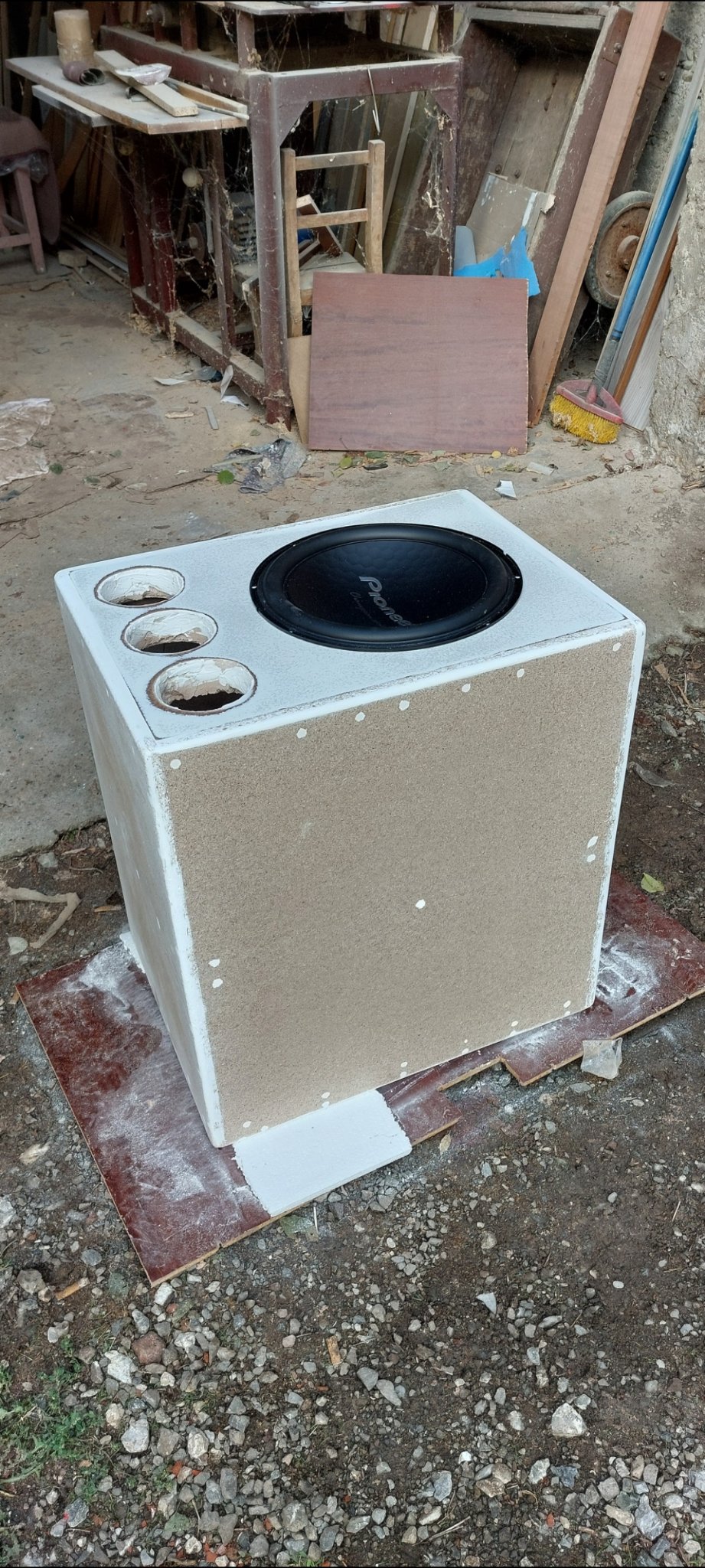

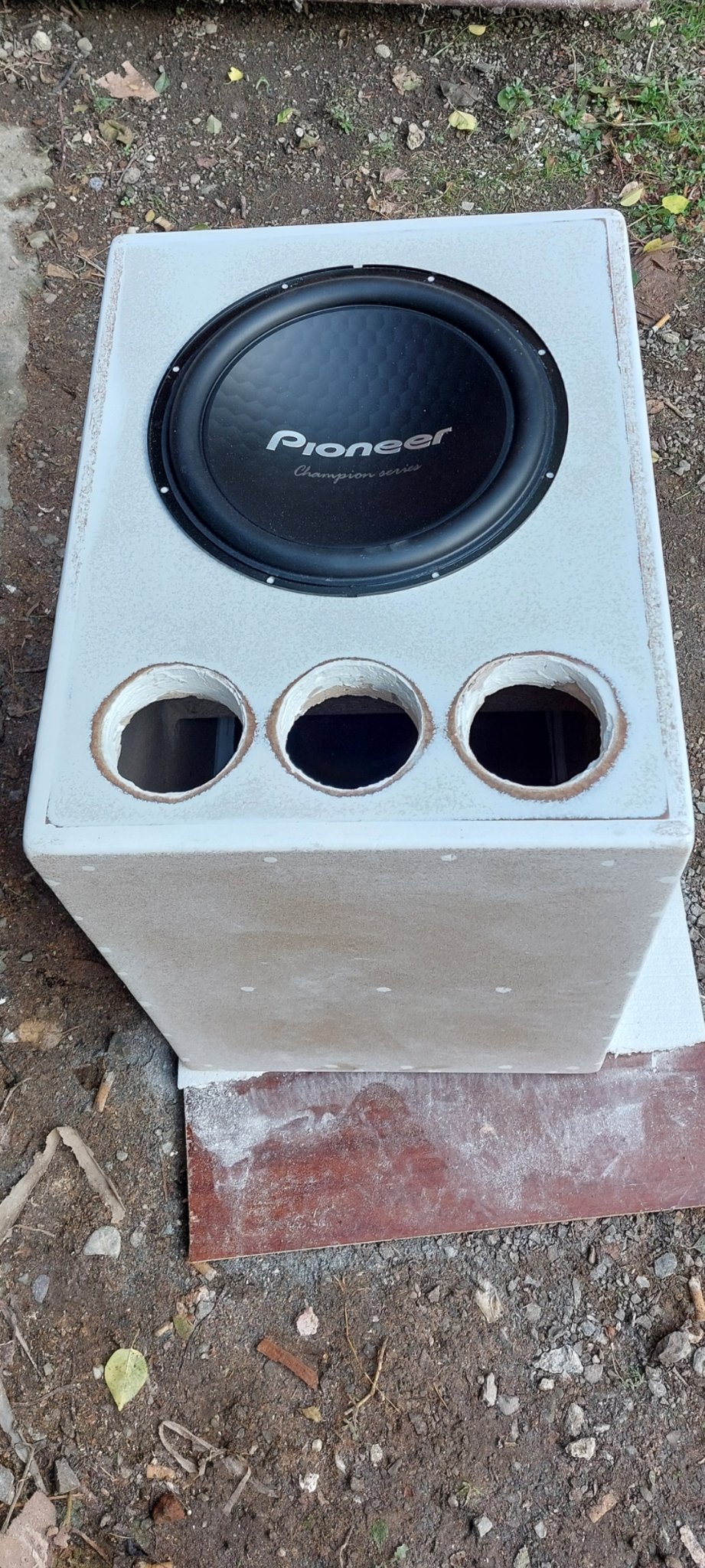

@maxolini I've used particle board , it's a bit weaker than plywood . And the box is kind of big.
