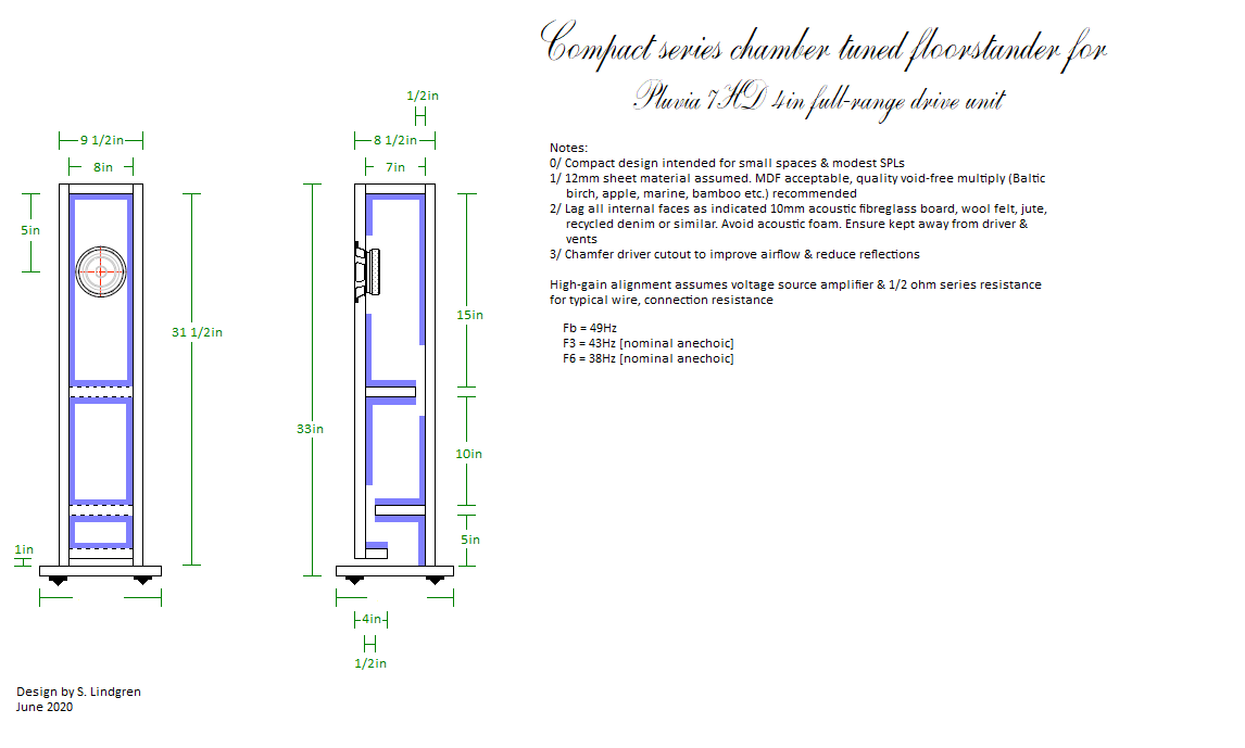

I’ve ordered my Pluvia 7.2 HD drivers and came across an interesting speaker design. Does the design seem viable? Has anyone built it?

For a project with smaller fullrange / wideband drivers.
The tower form factor seems like the more ideal shape
to just have fun.
The extra space you get from going tall.
Is just asking to have a multi chamber port.
Might as well have fun with the space.
Go for it.
Gives room for being creative with final finish too.
Port has been designed already.
Saves some time, all the works been done.
far as maths and measure.

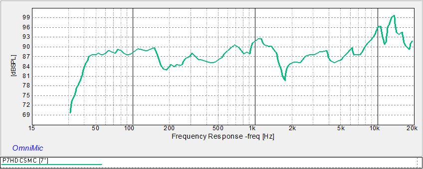

No, I agree (not unfair at all) -I understand where you're coming from, & you're right, it can be a challenge (or a leap of faith 😉 ) if data isn't posted. Sorry I couldn't add earlier but been out most of the day. This is the quick one from Omnimic I took, 6ms window IIRC. Excuse the graph scale; I've got more detailed plots elsewhere with nearfield hard spliced in that look a bit prettier too, but will need to dig them out of the records & this should give an idea of the general trending.
Below 150 Hz is impressive flat and very deep for a small fullrange!
Is that dip around 200 Hz coming from the enclosure, or from the room?
Below 150 is a result of that ported, three chamber, series resonance. If you look at the dimensions of the chambers heights: 15”, 10”, 5” with the total chambers height of 30”.
I’m most likely misspeaking a bit but it is pretty “badass”. 😈
No dsp, no eq, just acoustic wizardry. 😉
