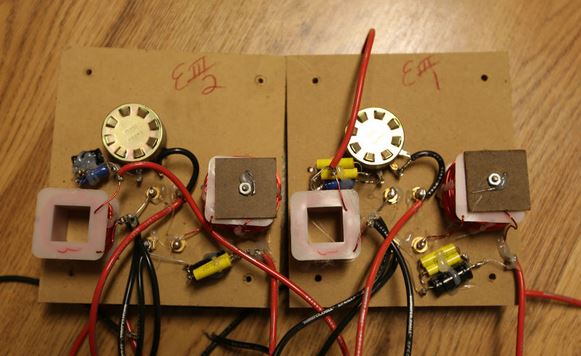

This is memory lane for me, but I once got involved in a thread about the Snell Type E.
IIRC, it was a tweeter filter around 6uF/0.6mH and an adjustable 0-5R resistor after the filter.
The bass coil I can't remember, but 2.5mH and 6uF might make sense. Probably wires negative polarity on the tweeter.
This eBay example seems to confirm most of that, though it looks to me the resistor goes in front of the filter. Which might explain why the guys "upgrade" didn't work! 🙄

I looked the Snell E up today, and this might be more help to fatmarley than anyone else if he doesn't already know this, but the bass section for the Vifa M21 is 2.5mH and 12uF crossing over at 2kHz according to stereophile. Snell Type E/III loudspeaker Measurements | Stereophile.com
Seriously bassy I would think. Especially in that big reflex box. And quite demanding on the tweeter which varied a lot but always a Vifa model. It's an efficient speaker. Much tougher to do in a small box I'd reckon.
The Snell E used a similar woofer but different specs to the one used in the JPW AP, Snell k and Heybrook HB1.
Someone on another forum measured the Snell K components and got this:
"Speaker A .
LF filter 2.3mH and 12uF
HF filter 8.8uF 1.6 Ohm variable resistor and 0.31mH inductor
Speaker B
LF filter 2.42mH and 11.4uF
HF filter 7.5 uF , 1.7 Ohm 0.58mH"

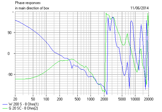

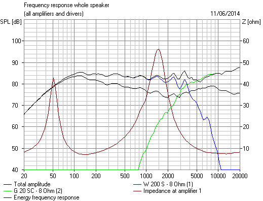

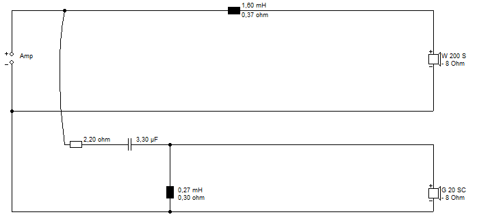

The Monitor Audio R100 was doubtless a Robin Marshall design. The filter is below if I'm guessing right. You can fit almost any 94mm 88dB tweeter without crossover change. Later models got a H0414-08 19TAF/G
I wouldn't modify the cabinet, but some stuffing like a pillow might help.
I know all about that Vifa bass. But it's not the only game in town. For your JPW, see if you can dig up a cheap bass we can evaluate. Like this:
H1471-08 CA22RNY
See it hardly needs any filtering! 😎

The slopes are down to the big natural rolloff that an 8" bass has. There's a much better filter for 8" bass, based on the similar KEF Celeste III and Celestion filters. But it works the bass chassis harder, and I don't really like it with ringing pressed steel chassis.

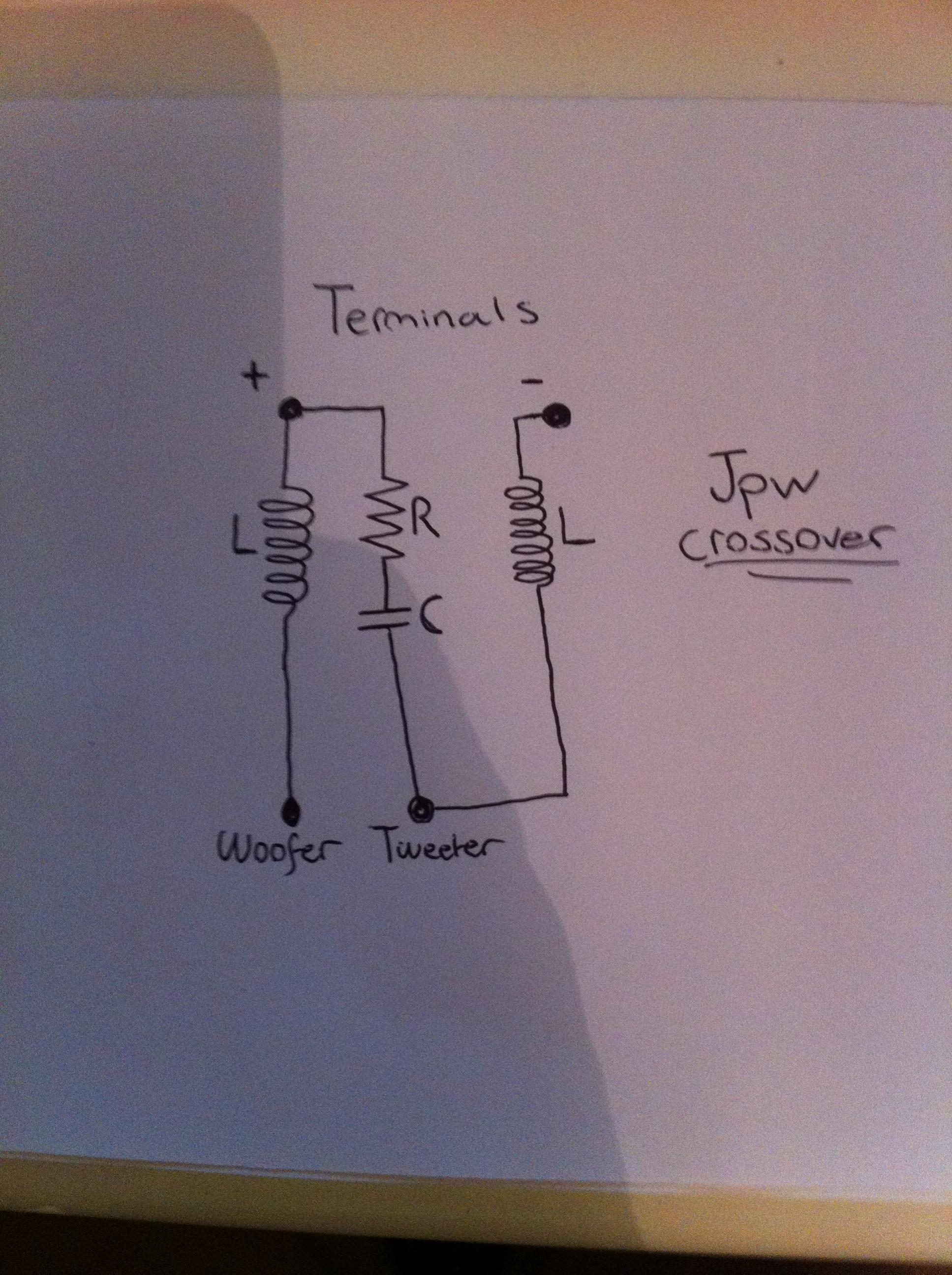

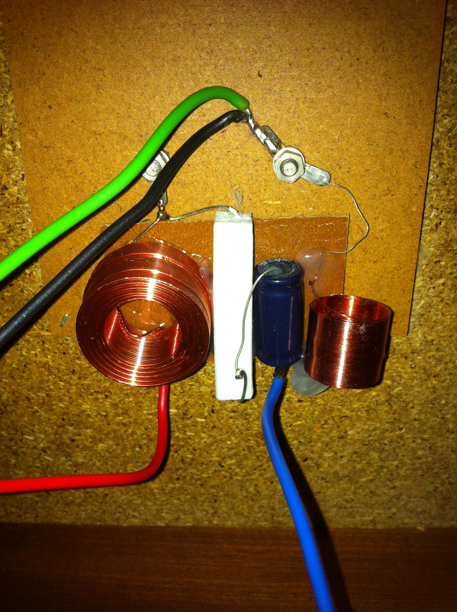

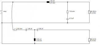

I went and took a photo and drew a schematic of the crossover for you today system. As i said earlier though, unfortunately all the component values are hidden. I also went and got a quote on those seas drivers you linked me and they are going to cost more then the vifas! Hifi here in oz is so expensive.
