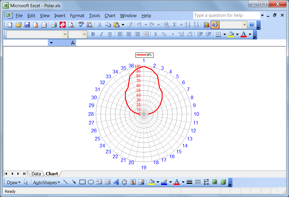

I can produce SPL at various angles/distances/frequencies. How do I plot polar charts? Are there simple software tools?
You could always just use the Radar chart option in Excel.
Also Area chart would be okay, looks the same as area chart in VituixCAD
But why bother because VituixCAD already has everything also for this job. Needs one wire to XO and loading of frequency response files to driver with some rational off-axis angle coding in filenames.

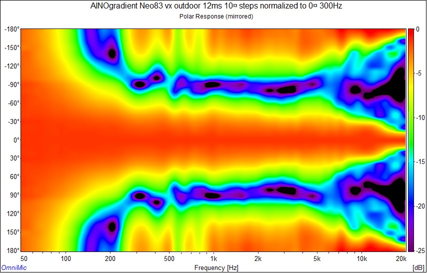

..not so fast there, Omnimic has a cylindrical balloon display that's interesting.

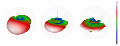

-and speaking of "balloon's" there is CLF:
CLF Viewer
I asked Ivo for Arta to have CLF export a while back, but nothing so far. 😱
-and while it's useful just in the context of the CLF viewer, it's more useful in the context of other programs.
As for the best balloon's I've seen, that's from Clio? ..nope:
Ease Speakerlab.
Reactions: els42
^Cylindrical balloon display is an alternative to waterfall/surface chart, but individual frequency responses are not so easy to compare.
Balloon would need actual spherical data which means measuring with dual axis rotation table or compatible mechanism for orbit rotation. Applies also to XO simulators so OT: Exporting of balloon data as CLF would be easy to add to VituixCAD, but orbits of virtual mic within measured horizontal and vertical planes would be results of response interpolation. Same function as orbit rotation with Planes phi deg parameter in Drivers tab.
