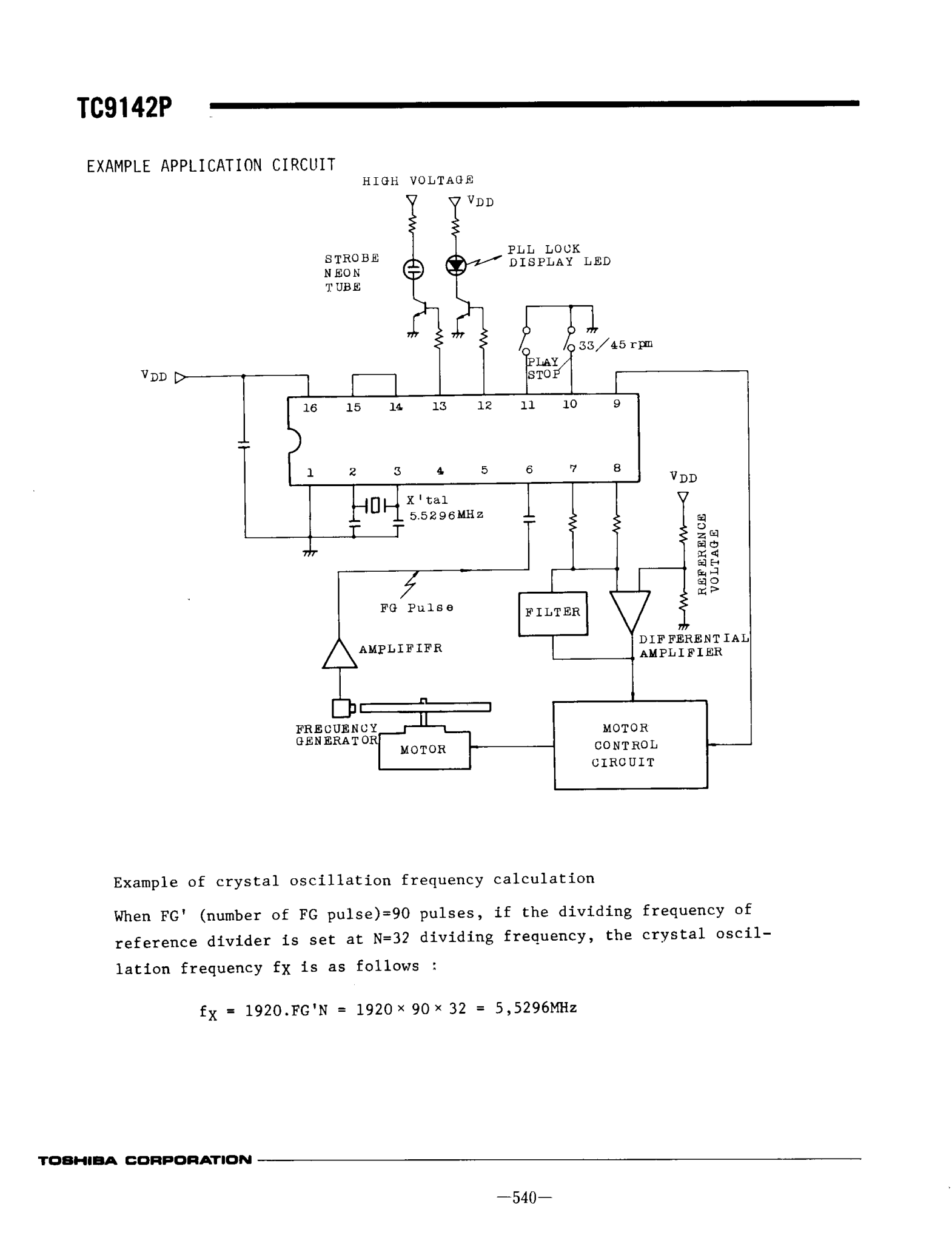

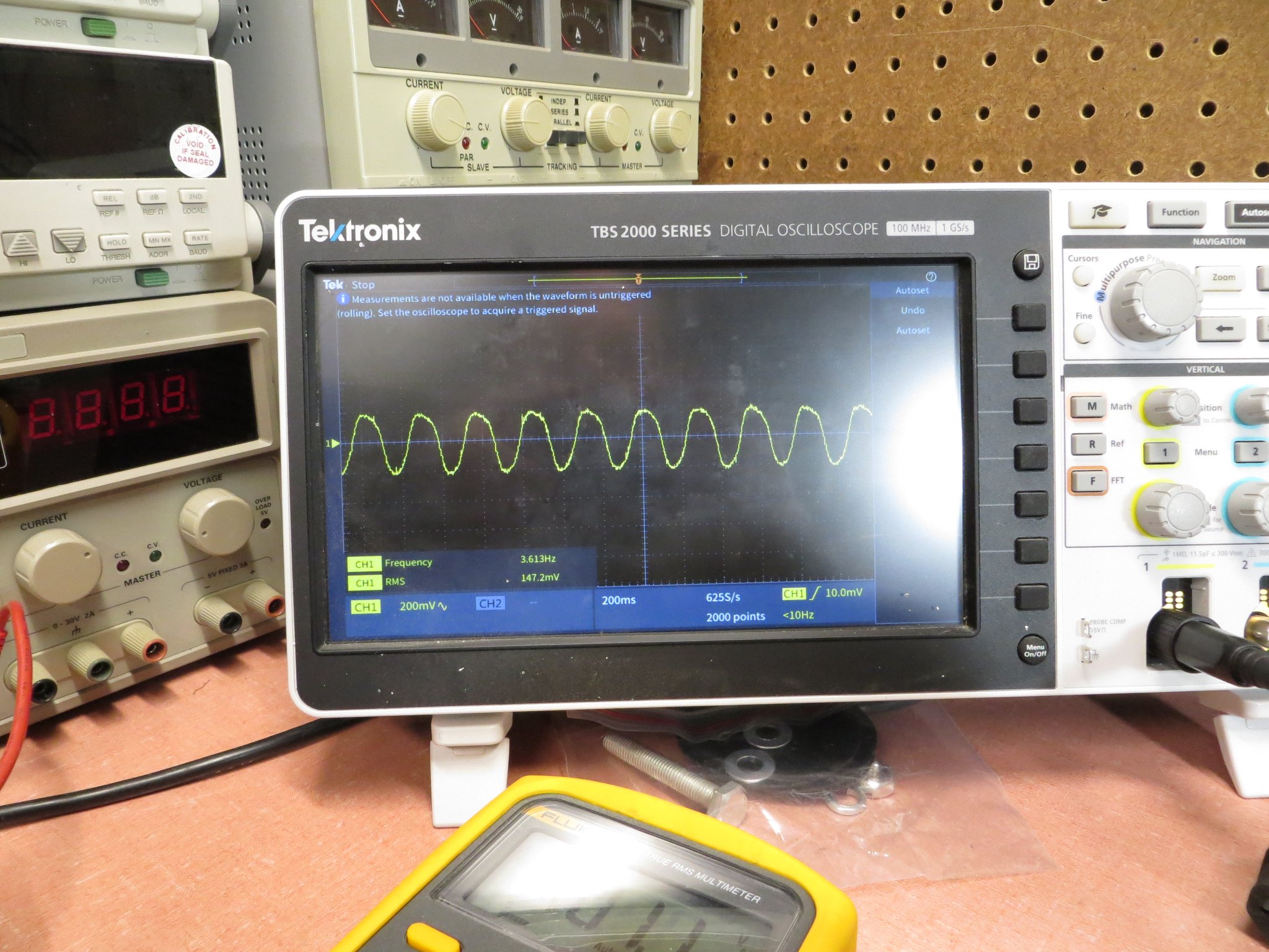

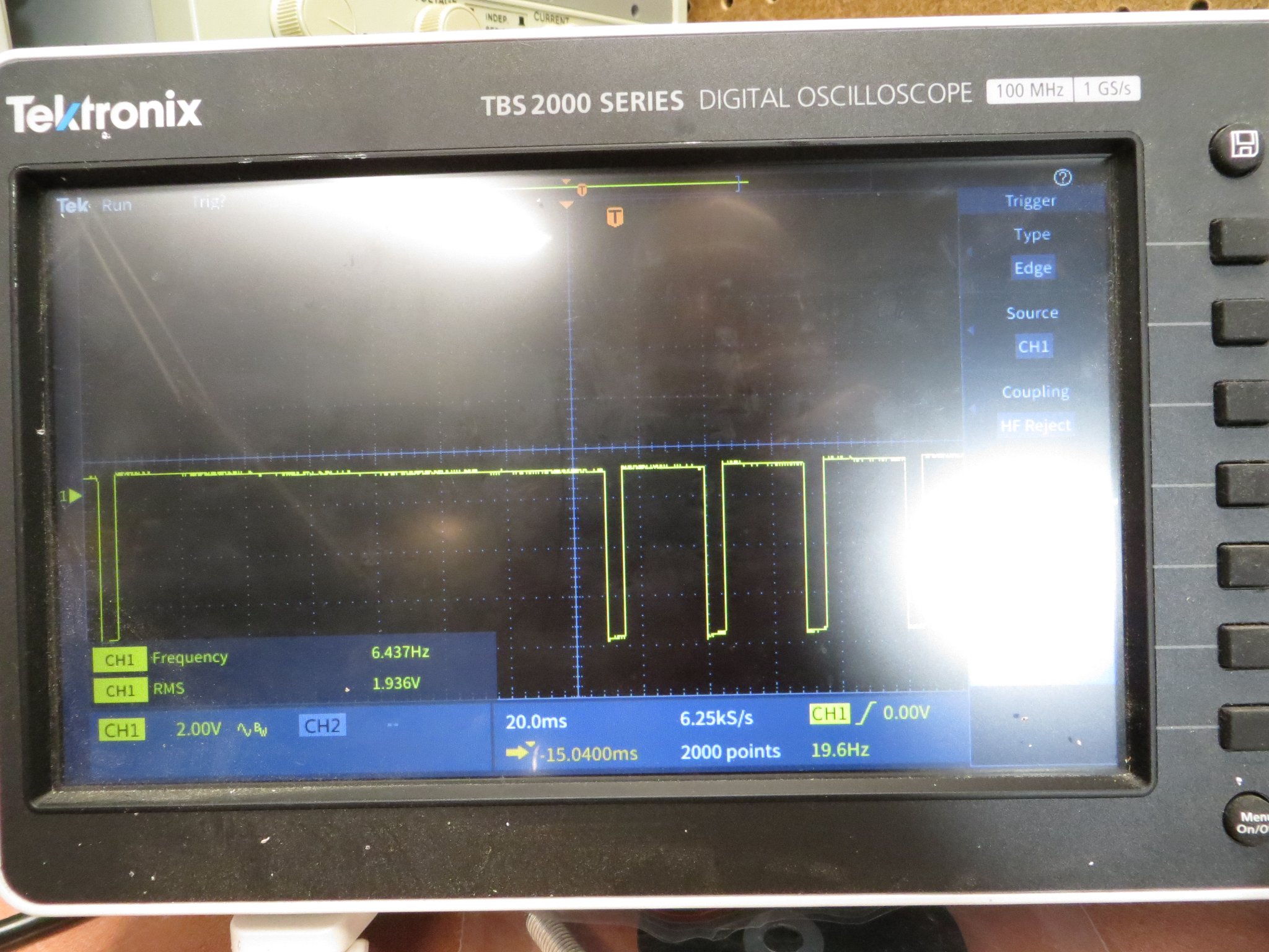

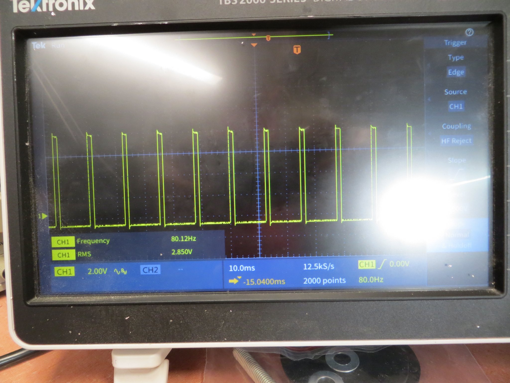

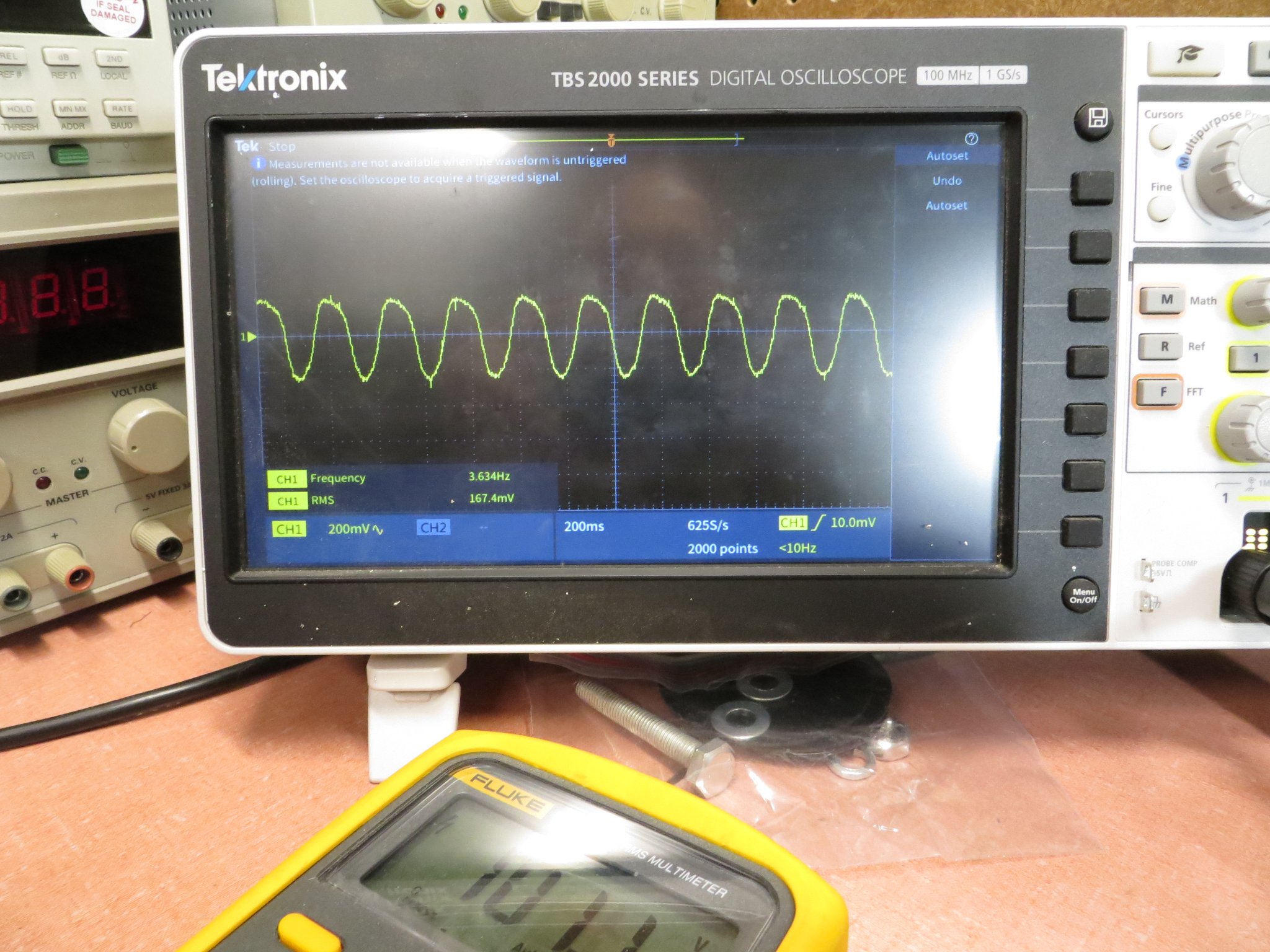

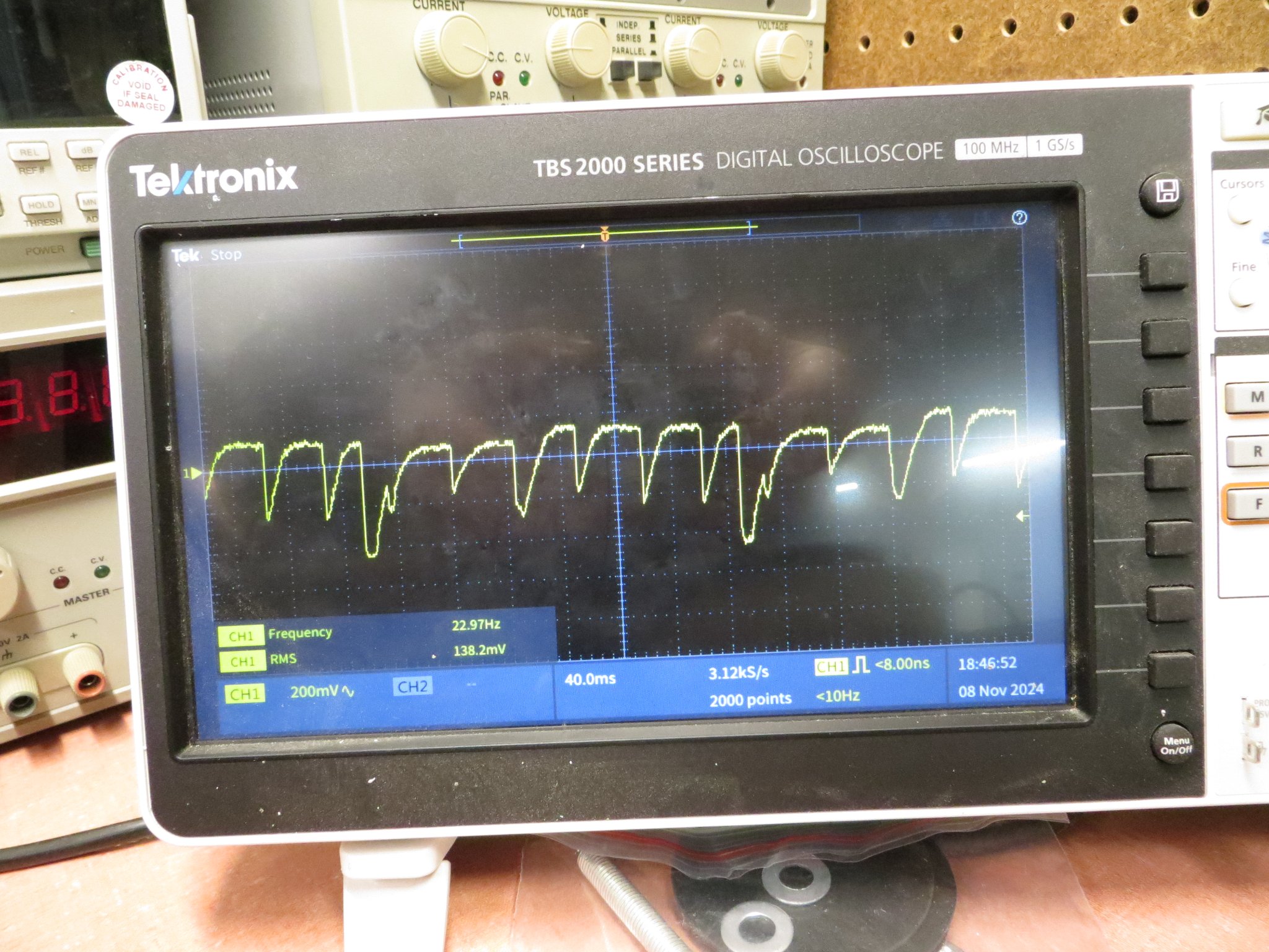

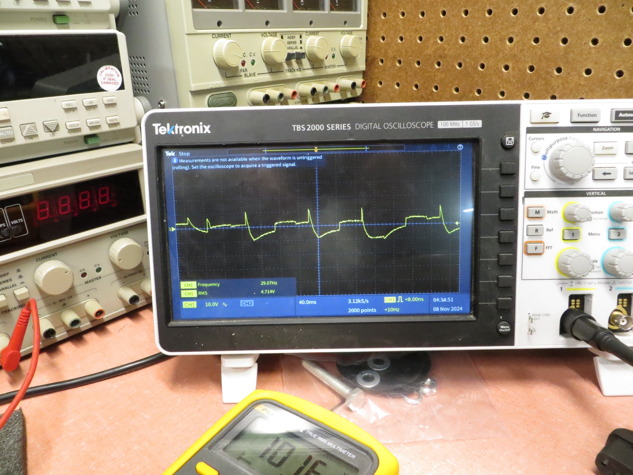

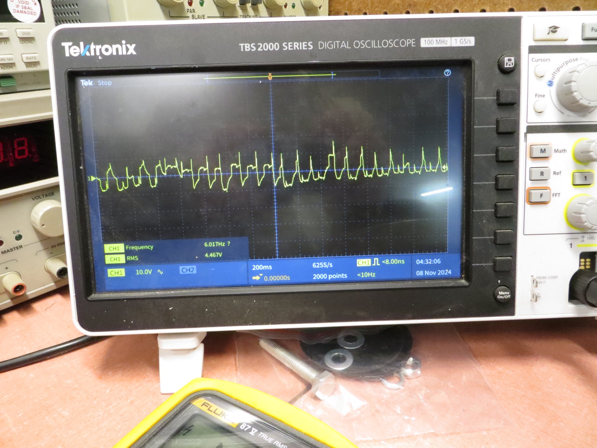

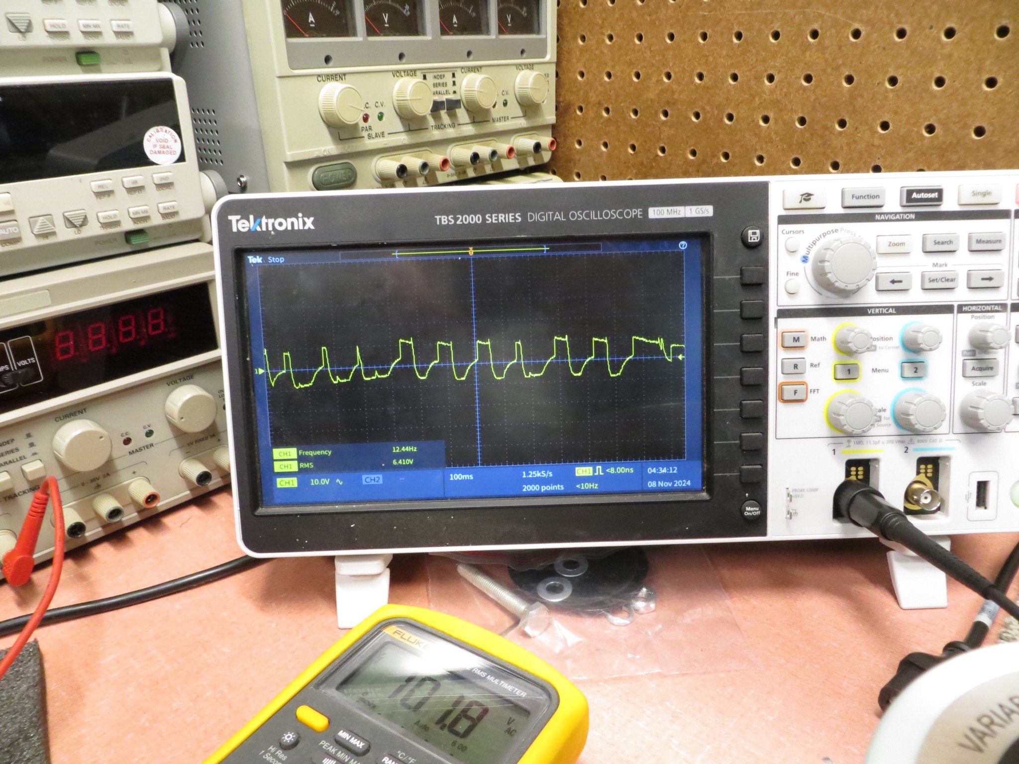

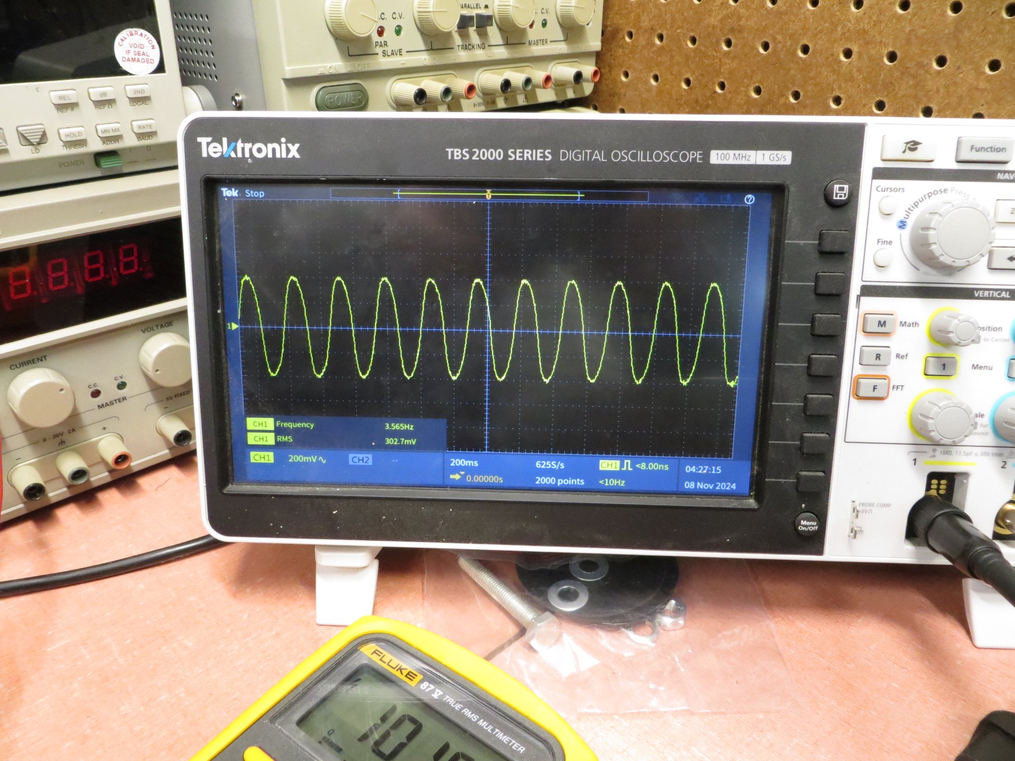

OK, problem solved. Somewhere along the line, C20, 21, and 22 had been replaced. These are supposed to be 100mfd/10v but had been replaced with 10mfd/100v. This 10x reduction in capacitance was keeping the FG signal from being converted to a square wave, as I interpret it.
So the seller ran the table and it spun, but he/she didn't test the speed.
Thanks. I wouldn't have found this without your suggestion to look at the FG amp.

Yes it does. Amazing what a simple mistake can cause. Wish I would have been the one to replace the caps - then they would have been the first thing I'd check after a change.
Erm, really? The AN6562 is single-supply capable...The 5532 and almost any op-amp will work.
As are most op-amps !Erm, really? The AN6562 is single-supply capable...
I did replace the 6562 with a 5532 and it works like a champ. Maybe it wouldn't be a good idea if you were expecting sound from the amp, but it's just the FG amp so fidelity isn't important.
