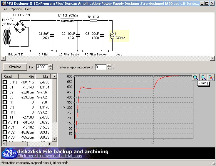

Seeing I have read a bit of bull about valves being less noizy than diodes for rectification I am now considering a LCLC or LCRC setup and have looked at the humble & popular 5AR4, only problem is, it isn't anywhere near enough to survive the peak caused by having a choke first. The tube is rated for 250mA, that's riding on borderline 230mA estimated load for 1 channel. (120 / 525 = 0.228)
Sure I could double up, but that's 4 tubes for one bridge side! Octal! Maybe not such a bad idea.
http://www.plitron.com/pages/Products/Audio/vtvkt88.htm
So as my last attempt of using this design with tubes I am asking if you guy's know of any tubes which would be suitable and replacable ? Probably asking the earth 🙂
Preferrably something that can handle 8-50uF for frontline cap in a CLC or CLCRC run as I need the higher reservior voltages to drive this amp properly at 490-525v or thereabouts..
Also with supply restrictions it is preferred that I could get them off some webpage, don't matter if it's dusty and the pens don't work, I'll write them a cheque on stone 🙂
Having to ring them up and speak in tounges isn't however on my agenda that's just toooo weird 😀
I've run PSUD in a LCRC and LCLC manner only to find a 350 or odd volts out of both diode and 5AR4x2 (parallel or single).
Theres no way this design would run below 470v and still be the same amp. If there is I'm not interested.
It seems the evil 866-A is the only thing in PSUD which gives me a soft voltage drop at the expense of my life and endanger to wild animals of running the tube at borderline explosive instability
That and standing the cat's hair on end everytime it crosses the doorway 😀
Having two chokes for one side may be a problem, however I'm willing to live with it, just makes things in the ps region a bit cramped. But still well ventilated.
Cheers.

Ookay, "According to PSUD" 😛 we get 470v at 230mA with the PY500A's in Bridge, With diodes it's 500v. a 30v drop, not exactly heart-breaking!
With the Svetlana 5C8S's I'm /assuming/ from the voltage curve
that there will be a 100volt drop. taking it to 400v.
For now it looks like we have a winner, although a bit of a pain with the length.
Still open for suggestions!

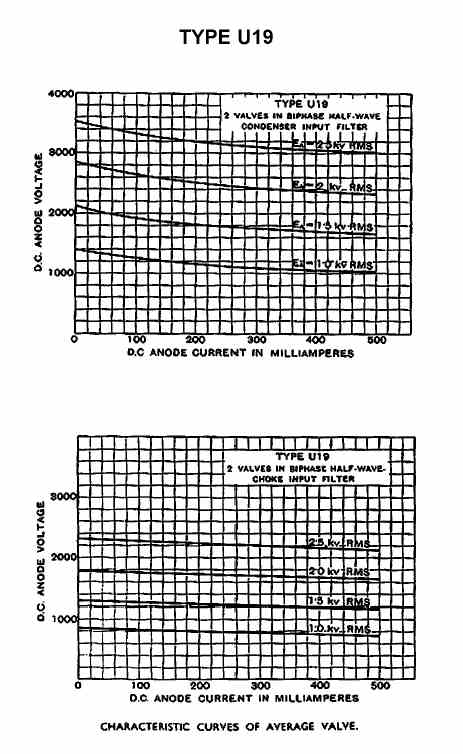

How about U19? It's good for high voltages and 500mA load current. Data sheet on Frank's site:
http://frank.pocnet.net/sheetsU.html
Might need to go choke input, though.

Well the U19 curves seem damn flat! I think we have a winner!
(A winner because it can handle so much voltage with such a high mA.)
Only problem is, the table is of a scale of 1000's of volts!!
According to figure 2 in the same image, at 1000volts you see roughly a 25volt drop from the operating voltage of 825v from 100 to 325mA
Which means that a 500volt supply is likely to come out 25-50volts lighter.
I would probably see performance on par to PY500A...
Nope, it still works out below 400volts while running a PY500A into choke. 350volts to be exact, way too low.
I would get the same result with the U19 so both tubes are discarded, unless someone can tell me the maximum capacitance for the PY500A for frontline cap while in bridge? ie. 4 valves to make one 4 diode bridge.
I could try but I think it'll still go below 400v even with a cap infront, and even then I would need 47uF to see 470v!
I tried 8uF and it came to 450v.
