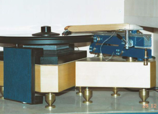

I'm considering a TT design in which there is no mechanical connection between the arm and the rest of the turntable.
The arm is simply attached to a block of something and sits on the same surface that the turntable sits on. There will be some means of positioning the arm so it has the correct geometrical relationship to the TT, but is not directly attached.
Anything inherently wrong with this idea?

if both-TT and arm base are rigidly placed on same base,nothing wrong with this approach;
in any case ,TT must not have any sort of suspension 😉
Nothing wrong with stand alone tonearm. Some essential points:
- it shall be placed on the same rigid platform with the plinth without any compliant element in between;
- arm base shall be massive/stable enough for not to be moved accidentally while playing with tonearm adjustment;
- easy leveling/hight adjustable.
You should ask yourself first, does it worth a mess? Generally, conventional armboard is easier to implement. I made my armbase for the air tracker stand alone, because I was concerned about precise leveling of both platter and arm, which is very critical for air bearing.
